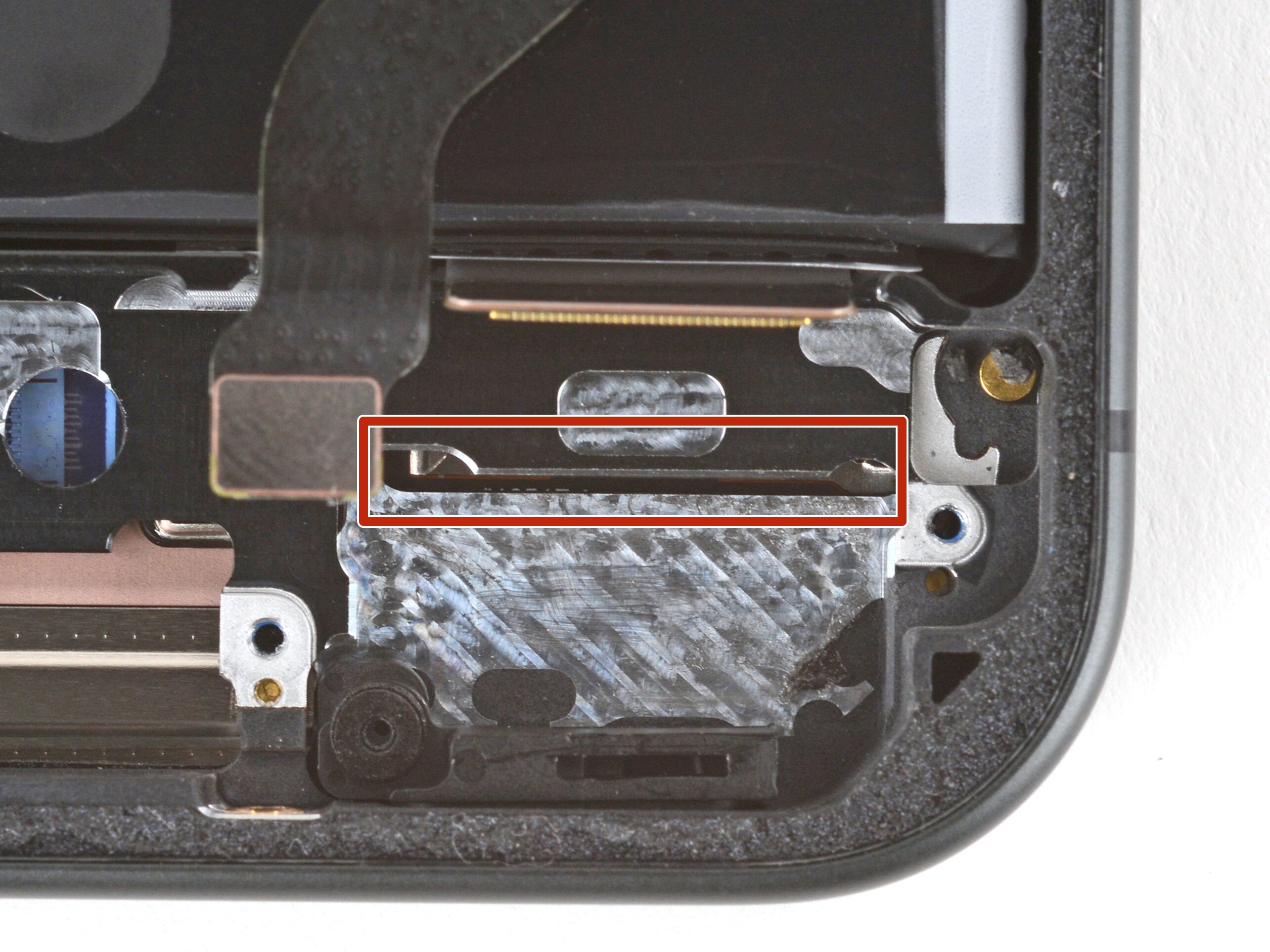

  24. Google Pixel 10 Vibration Motor Replacement, Apply isopropyl alcohol: crwdns2935265:024crwdnd2935265:01crwdnd2935265:01crwdne2935265:0
    • Apply one drop of high‑concentration (>90%) isopropyl alcohol to the bottom edge of the vibration motor.
    • Applying more than one drop on any other edge risks the alcohol flowing through the cutout in the frame and damaging the screen.
    • Wait one minute for the alcohol to soften the adhesive securing the vibration motor.
  25. Google Pixel 10 Vibration Motor Replacement, Remove the vibration motor: crwdns2935265:025crwdnd2935265:01crwdnd2935265:03crwdne2935265:0 Google Pixel 10 Vibration Motor Replacement, Remove the vibration motor: crwdns2935265:025crwdnd2935265:02crwdnd2935265:03crwdne2935265:0 Google Pixel 10 Vibration Motor Replacement, Remove the vibration motor: crwdns2935265:025crwdnd2935265:03crwdnd2935265:03crwdne2935265:0
    • Use a spudger to pry up the vibration motor and remove it.

  27. Google Pixel 10 Vibration Motor Replacement, Remove the old adhesive: crwdns2935265:027crwdnd2935265:01crwdnd2935265:03crwdne2935265:0 Google Pixel 10 Vibration Motor Replacement, Remove the old adhesive: crwdns2935265:027crwdnd2935265:02crwdnd2935265:03crwdne2935265:0 Google Pixel 10 Vibration Motor Replacement, Remove the old adhesive: crwdns2935265:027crwdnd2935265:03crwdnd2935265:03crwdne2935265:0
    • Use a spudger to scrape up and remove any bits of vibration motor adhesive from the frame.
    • Wrap a spudger in a microfiber or lint‑free cloth and apply one drop of high‑concentration (>90%) isopropyl alcohol.
    • Use the spudger to clean up any adhesive residue from the vibration motor's spot on the frame.
    • Remember not to let any alcohol get into the cutout on the frame.
    • Allow the alcohol to dry completely before continuing.

  45. Google Pixel 10 Vibration Motor Replacement, Remove the larger liner: crwdns2935265:045crwdnd2935265:01crwdnd2935265:03crwdne2935265:0 Google Pixel 10 Vibration Motor Replacement, Remove the larger liner: crwdns2935265:045crwdnd2935265:02crwdnd2935265:03crwdne2935265:0 Google Pixel 10 Vibration Motor Replacement, Remove the larger liner: crwdns2935265:045crwdnd2935265:03crwdnd2935265:03crwdne2935265:0
    • Slowly peel up and remove the large colored liner, gripping it from the cutout near the top edge.
    • If the adhesive starts to peel up with the liner, check that you’ve pushed all of it into place with your spudger. If it continues to peel up, hold it down with the point of your spudger as you go.
  46. Google Pixel 10 Vibration Motor Replacement: crwdns2935265:046crwdnd2935265:01crwdnd2935265:03crwdne2935265:0 Google Pixel 10 Vibration Motor Replacement: crwdns2935265:046crwdnd2935265:02crwdnd2935265:03crwdne2935265:0 Google Pixel 10 Vibration Motor Replacement: crwdns2935265:046crwdnd2935265:03crwdnd2935265:03crwdne2935265:0
    • Use a spudger to press down firmly on the adhesive to secure it to the frame.
