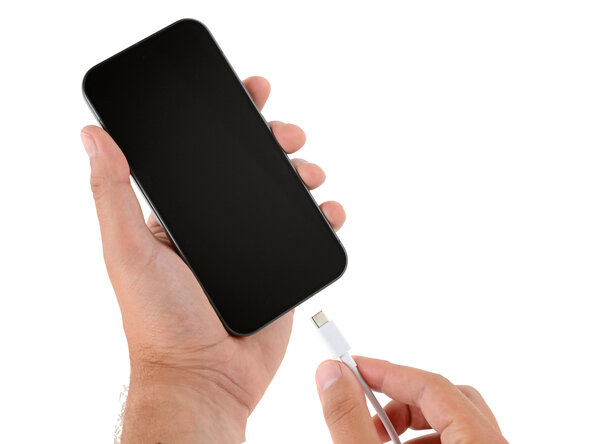

  1. Google Pixel 10 Bottom Speaker Replacement, Prepare your Pixel for disassembly: crwdns2935265:01crwdnd2935265:01crwdnd2935265:02crwdne2935265:0 Google Pixel 10 Bottom Speaker Replacement, Prepare your Pixel for disassembly: crwdns2935265:01crwdnd2935265:02crwdnd2935265:02crwdne2935265:0
    • Let your Pixel's battery drain below 25% before starting this repair. A charged lithium‑ion battery may catch fire if damaged.
    • Unplug all cables and completely power down your phone.

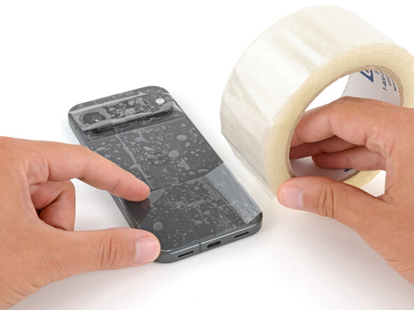

  2. Google Pixel 10 Bottom Speaker Replacement, Cracked glass preparation: crwdns2935265:02crwdnd2935265:01crwdnd2935265:03crwdne2935265:0 Google Pixel 10 Bottom Speaker Replacement, Cracked glass preparation: crwdns2935265:02crwdnd2935265:02crwdnd2935265:03crwdne2935265:0 Google Pixel 10 Bottom Speaker Replacement, Cracked glass preparation: crwdns2935265:02crwdnd2935265:03crwdnd2935265:03crwdne2935265:0
    • Glass shards can complicate disassembly—or worse, cause injury. If your phone's back glass is cracked, follow this step.
    • Apply strips of packing tape to the cracked glass until it's completely covered—this will help keep the glass contained and allow the suction cup to stick.
    • Make sure there's a single strip (not overlapping) of tape across the bottom edge, big enough for a suction cup to fit on.
    • Only cover the glass itself—don't stick any tape to the frame.
    • Consider wearing safety glasses to protect your eyes from any glass shaken free during the repair.

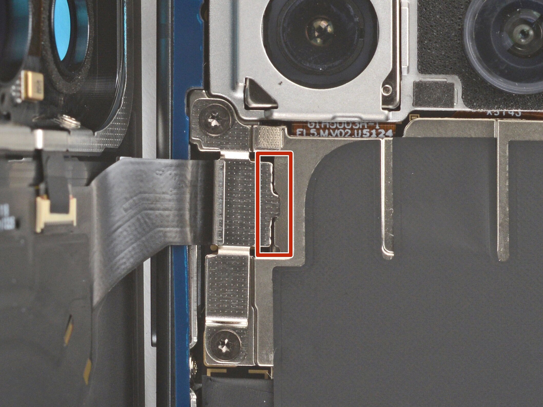

  12. Google Pixel 10 Bottom Speaker Replacement, Remove the bracket screws: crwdns2935265:012crwdnd2935265:01crwdnd2935265:02crwdne2935265:0 Google Pixel 10 Bottom Speaker Replacement, Remove the bracket screws: crwdns2935265:012crwdnd2935265:02crwdnd2935265:02crwdne2935265:0
    • Use a Torx Plus 3IP screwdriver to remove the two 5.0 mm‑long screws securing the back glass connector bracket.
  13. Google Pixel 10 Bottom Speaker Replacement: crwdns2935265:013crwdnd2935265:01crwdnd2935265:03crwdne2935265:0 Google Pixel 10 Bottom Speaker Replacement: crwdns2935265:013crwdnd2935265:02crwdnd2935265:03crwdne2935265:0 Google Pixel 10 Bottom Speaker Replacement: crwdns2935265:013crwdnd2935265:03crwdnd2935265:03crwdne2935265:0
    • Use tweezers or your fingers to remove the bracket.
    • Be careful not to scratch or smudge the rear cameras.
  14. Google Pixel 10 Bottom Speaker Replacement, Disconnect the back glass: crwdns2935265:014crwdnd2935265:01crwdnd2935265:02crwdne2935265:0 Google Pixel 10 Bottom Speaker Replacement, Disconnect the back glass: crwdns2935265:014crwdnd2935265:02crwdnd2935265:02crwdne2935265:0
    • Use the point of a spudger to pry up and disconnect the back glass press connector.
