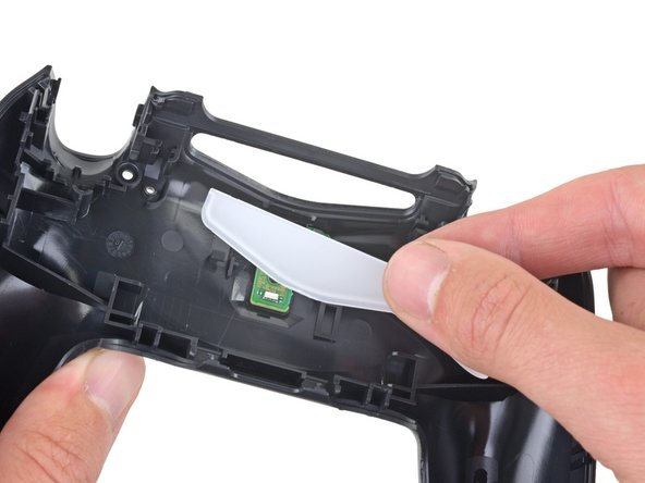

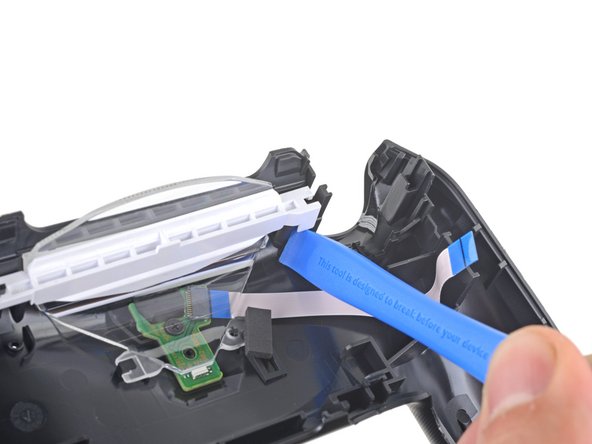

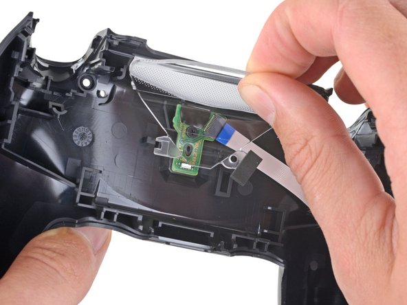

    1. DualShock 4 CUH-ZCT2 Charging Assembly Replacement, Remove the light guide: crwdns2935265:06crwdnd2935265:01crwdnd2935265:03crwdne2935265:0 DualShock 4 CUH-ZCT2 Charging Assembly Replacement, Remove the light guide: crwdns2935265:06crwdnd2935265:02crwdnd2935265:03crwdne2935265:0 DualShock 4 CUH-ZCT2 Charging Assembly Replacement, Remove the light guide: crwdns2935265:06crwdnd2935265:03crwdnd2935265:03crwdne2935265:0
      • Use an opening tool or spudger to separate the white plastic bar from the rear panel.
    2. DualShock 4 CUH-ZCT2 Charging Assembly Replacement: crwdns2935265:07crwdnd2935265:01crwdnd2935265:02crwdne2935265:0 DualShock 4 CUH-ZCT2 Charging Assembly Replacement: crwdns2935265:07crwdnd2935265:02crwdnd2935265:02crwdne2935265:0
      • Remove the white plastic bar.
    3. DualShock 4 CUH-ZCT2 Charging Assembly Replacement: crwdns2935265:08crwdnd2935265:01crwdnd2935265:03crwdne2935265:0 DualShock 4 CUH-ZCT2 Charging Assembly Replacement: crwdns2935265:08crwdnd2935265:02crwdnd2935265:03crwdne2935265:0 DualShock 4 CUH-ZCT2 Charging Assembly Replacement: crwdns2935265:08crwdnd2935265:03crwdnd2935265:03crwdne2935265:0
      • Lift the light guide away from the rear panel to remove it.
      • During reassembly, align the light guide with the rear panel using the notch near the bottom left.

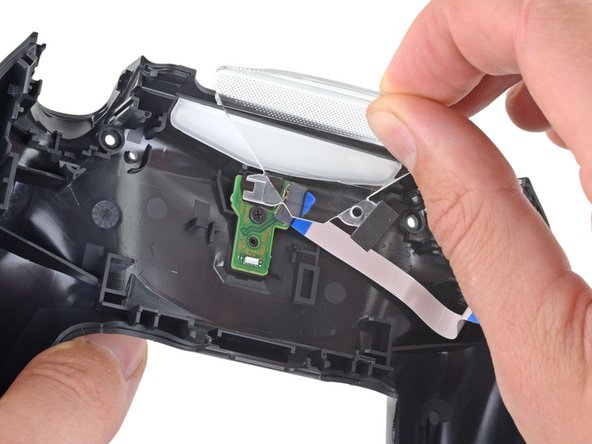

    4. DualShock 4 CUH-ZCT2 Charging Assembly Replacement: crwdns2935265:09crwdnd2935265:01crwdnd2935265:03crwdne2935265:0 DualShock 4 CUH-ZCT2 Charging Assembly Replacement: crwdns2935265:09crwdnd2935265:02crwdnd2935265:03crwdne2935265:0 DualShock 4 CUH-ZCT2 Charging Assembly Replacement: crwdns2935265:09crwdnd2935265:03crwdnd2935265:03crwdne2935265:0
      • Use your fingers to press the translucent plastic piece down through the top of the controller.
      • Remove the translucent plastic piece.

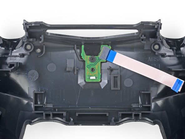

    5. DualShock 4 CUH-ZCT2 Charging Assembly Replacement, Remove the charging assembly: crwdns2935265:010crwdnd2935265:01crwdnd2935265:02crwdne2935265:0 DualShock 4 CUH-ZCT2 Charging Assembly Replacement, Remove the charging assembly: crwdns2935265:010crwdnd2935265:02crwdnd2935265:02crwdne2935265:0
      • Use a Phillips screwdriver to remove the 4.4 mm-long screw from the charging assembly.

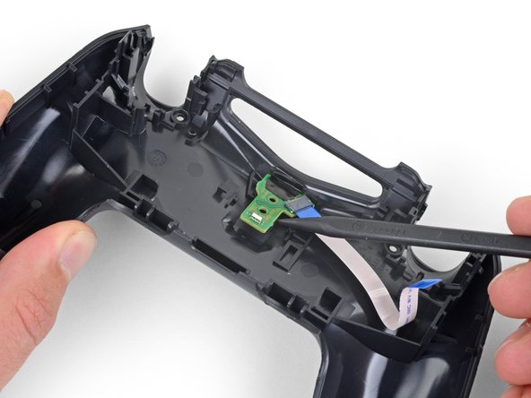

    6. DualShock 4 CUH-ZCT2 Charging Assembly Replacement: crwdns2935265:011crwdnd2935265:01crwdnd2935265:02crwdne2935265:0 DualShock 4 CUH-ZCT2 Charging Assembly Replacement: crwdns2935265:011crwdnd2935265:02crwdnd2935265:02crwdne2935265:0
      • Use the pointed end of a spudger to lift the charging assembly away from the rear panel.
    7. DualShock 4 CUH-ZCT2 Charging Assembly Replacement: crwdns2935265:012crwdnd2935265:01crwdnd2935265:02crwdne2935265:0 DualShock 4 CUH-ZCT2 Charging Assembly Replacement: crwdns2935265:012crwdnd2935265:02crwdnd2935265:02crwdne2935265:0

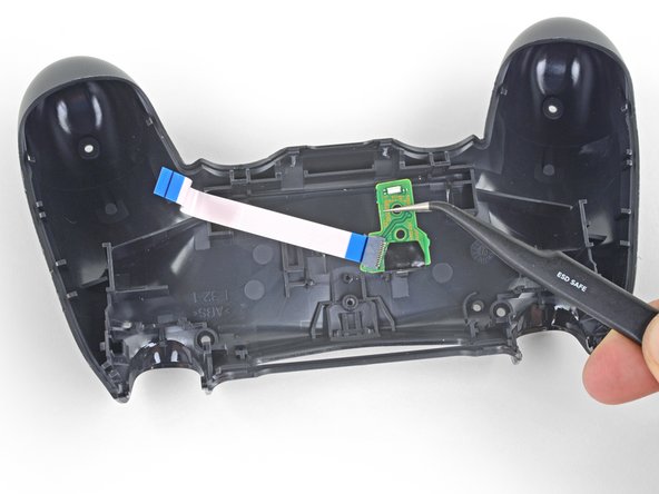

      • Use your fingers or a pair of tweezers to remove the charging assembly from the rear panel.
