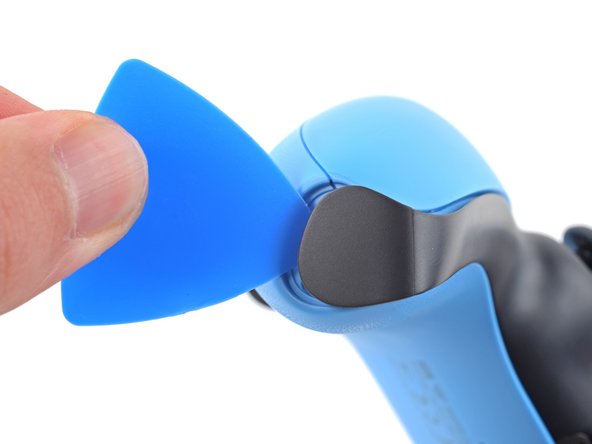

  1. DualSense Controller v2 Vibration Motor Replacement, Unclip the right end of the middle trim: crwdns2935265:01crwdnd2935265:01crwdnd2935265:02crwdne2935265:0 DualSense Controller v2 Vibration Motor Replacement, Unclip the right end of the middle trim: crwdns2935265:01crwdnd2935265:02crwdnd2935265:02crwdne2935265:0
    • Disconnect and power down the controller before you begin.
    • Insert an opening pick underneath the middle trim at the bottom-right corner of the controller to release the clips securing it to the case.
  2. DualSense Controller v2 Vibration Motor Replacement, Unclip the lower-right edge of the middle trim: crwdns2935265:02crwdnd2935265:01crwdnd2935265:03crwdne2935265:0 DualSense Controller v2 Vibration Motor Replacement, Unclip the lower-right edge of the middle trim: crwdns2935265:02crwdnd2935265:02crwdnd2935265:03crwdne2935265:0 DualSense Controller v2 Vibration Motor Replacement, Unclip the lower-right edge of the middle trim: crwdns2935265:02crwdnd2935265:03crwdnd2935265:03crwdne2935265:0
    • Slide the opening pick along the lower-right edge of the middle trim to release the clips securing it to the case.

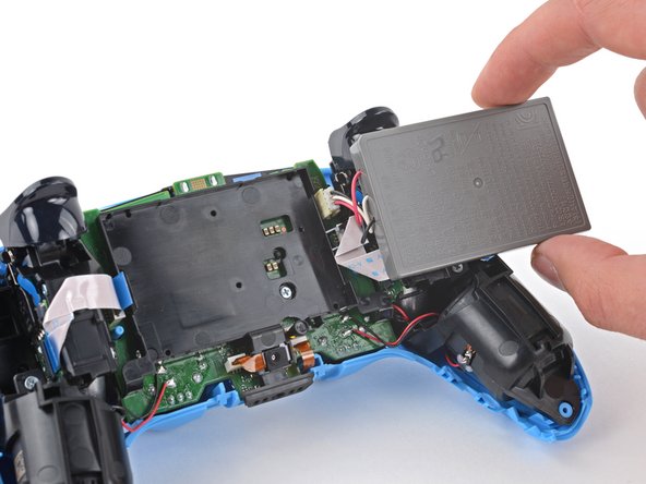

  12. DualSense Controller v2 Vibration Motor Replacement, Reposition the battery: crwdns2935265:012crwdnd2935265:01crwdnd2935265:02crwdne2935265:0 DualSense Controller v2 Vibration Motor Replacement, Reposition the battery: crwdns2935265:012crwdnd2935265:02crwdnd2935265:02crwdne2935265:0
    • Lift the battery out of its bracket and reposition it to the right for better access to the battery connector.
    • Don't strain the battery cables.
  13. DualSense Controller v2 Vibration Motor Replacement, Disconnect the battery: crwdns2935265:013crwdnd2935265:01crwdnd2935265:02crwdne2935265:0 DualSense Controller v2 Vibration Motor Replacement, Disconnect the battery: crwdns2935265:013crwdnd2935265:02crwdnd2935265:02crwdne2935265:0
    • Use a pair of tweezers or your fingers to disconnect the battery from the motherboard.
    • Don't pull on the wires to disconnect the battery.
  14. DualSense Controller v2 Vibration Motor Replacement, Remove the battery: crwdns2935265:014crwdnd2935265:01crwdnd2935265:01crwdne2935265:0
    • Remove the battery.

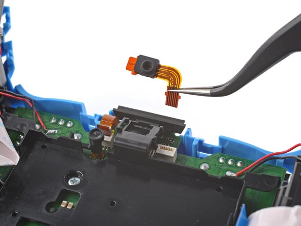

  15. DualSense Controller v2 Vibration Motor Replacement, Remove the lower microphone: crwdns2935265:015crwdnd2935265:01crwdnd2935265:02crwdne2935265:0 DualSense Controller v2 Vibration Motor Replacement, Remove the lower microphone: crwdns2935265:015crwdnd2935265:02crwdnd2935265:02crwdne2935265:0
    • Use the pointed end of a spudger to remove the lower microphone from its bracket next to the battery.
    • During reassembly, make sure the end of the microphone's ribbon cable is slotted into the bracket.
  16. DualSense Controller v2 Vibration Motor Replacement: crwdns2935265:016crwdnd2935265:01crwdnd2935265:02crwdne2935265:0 DualSense Controller v2 Vibration Motor Replacement: crwdns2935265:016crwdnd2935265:02crwdnd2935265:02crwdne2935265:0
    • Grab the lower microphone ribbon cable pull tab with your fingers or a pair of tweezers and disconnect it from the motherboard.

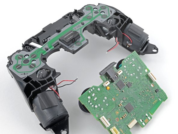

  25. DualSense Controller v2 Vibration Motor Replacement, Lift out the motherboard: crwdns2935265:025crwdnd2935265:01crwdnd2935265:03crwdne2935265:0 DualSense Controller v2 Vibration Motor Replacement, Lift out the motherboard: crwdns2935265:025crwdnd2935265:02crwdnd2935265:03crwdne2935265:0 DualSense Controller v2 Vibration Motor Replacement, Lift out the motherboard: crwdns2935265:025crwdnd2935265:03crwdnd2935265:03crwdne2935265:0
    • Carefully guide the joysticks through the front case and lift the motherboard out.
    • Don't strain the four soldered wires tethering the motherboard to the vibration motors.

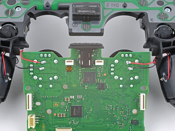

  26. DualSense Controller v2 Vibration Motor Replacement, Desolder the vibration motor wires: crwdns2935265:026crwdnd2935265:01crwdnd2935265:03crwdne2935265:0 DualSense Controller v2 Vibration Motor Replacement, Desolder the vibration motor wires: crwdns2935265:026crwdnd2935265:02crwdnd2935265:03crwdne2935265:0 DualSense Controller v2 Vibration Motor Replacement, Desolder the vibration motor wires: crwdns2935265:026crwdnd2935265:03crwdnd2935265:03crwdne2935265:0
    FixHub | Power Series Smart Soldering Iron
    $79.95
    • Flip the motherboard and midframe over to access the red and black vibration motor wires.
    • Use a soldering iron to disconnect the vibration motor wires from the motherboard.
    • To learn how to solder, or to get some helpful tips and tricks, check out our soldering guide.
    • During reassembly, refer to this photo to ensure the wires are soldered back to their correct positions.

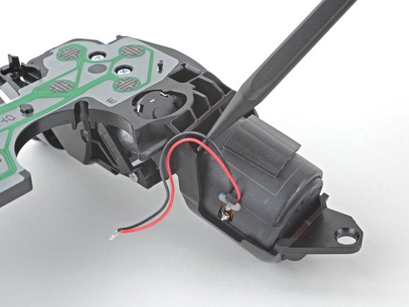

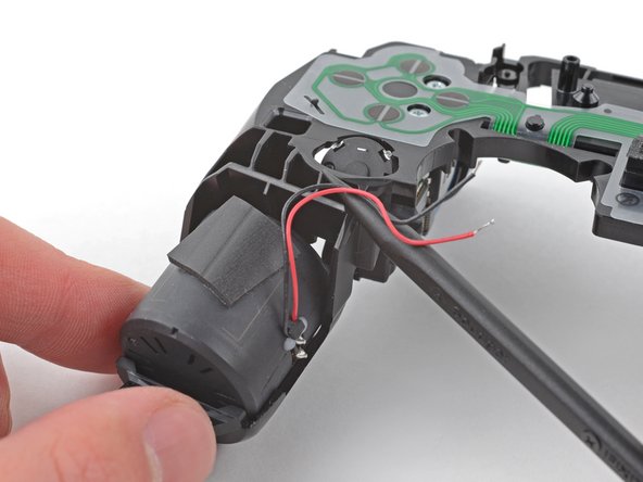

  27. DualSense Controller v2 Vibration Motor Replacement, Free the vibration motor wires: crwdns2935265:027crwdnd2935265:01crwdnd2935265:02crwdne2935265:0 DualSense Controller v2 Vibration Motor Replacement, Free the vibration motor wires: crwdns2935265:027crwdnd2935265:02crwdnd2935265:02crwdne2935265:0
    • Use your spudger to slide the left vibration motor wires out of the midframe.
  28. DualSense Controller v2 Vibration Motor Replacement: crwdns2935265:028crwdnd2935265:01crwdnd2935265:02crwdne2935265:0 DualSense Controller v2 Vibration Motor Replacement: crwdns2935265:028crwdnd2935265:02crwdnd2935265:02crwdne2935265:0
    • Use your spudger to slide the right vibration motor wires out of the midframe.

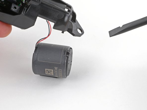

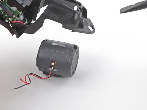

  29. DualSense Controller v2 Vibration Motor Replacement, Remove the left-hand vibration motor: crwdns2935265:029crwdnd2935265:01crwdnd2935265:03crwdne2935265:0 DualSense Controller v2 Vibration Motor Replacement, Remove the left-hand vibration motor: crwdns2935265:029crwdnd2935265:02crwdnd2935265:03crwdne2935265:0 DualSense Controller v2 Vibration Motor Replacement, Remove the left-hand vibration motor: crwdns2935265:029crwdnd2935265:03crwdnd2935265:03crwdne2935265:0
    • Hold the midframe up to make sure the vibration motor isn't resting on your work surface.
    • Press the flat end of your spudger into the midframe opening against the left-hand vibration motor.
    • Push to release the adhesive securing the vibration motor to the midframe.
    • If the adhesive is too strong, apply heat or 90% isopropyl alcohol to the back of the midframe to soften it.
    • During reassembly, apply some pre-cut adhesive to the new vibration motor to bond it to the midframe.

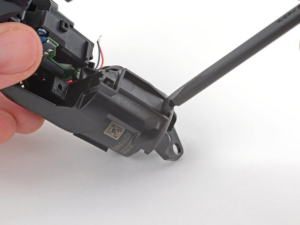

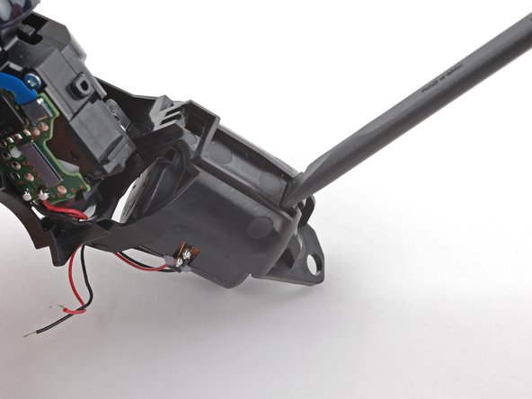

  30. DualSense Controller v2 Vibration Motor Replacement, Remove the right-hand vibration motor: crwdns2935265:030crwdnd2935265:01crwdnd2935265:03crwdne2935265:0 DualSense Controller v2 Vibration Motor Replacement, Remove the right-hand vibration motor: crwdns2935265:030crwdnd2935265:02crwdnd2935265:03crwdne2935265:0 DualSense Controller v2 Vibration Motor Replacement, Remove the right-hand vibration motor: crwdns2935265:030crwdnd2935265:03crwdnd2935265:03crwdne2935265:0
    • Press the flat end of your spudger into the midframe opening against the right-hand vibration motor.
