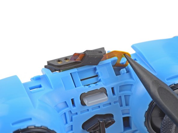

  12. DualSense Controller v2 Microphone Replacement, Remove the lower microphone: crwdns2935265:012crwdnd2935265:01crwdnd2935265:02crwdne2935265:0 DualSense Controller v2 Microphone Replacement, Remove the lower microphone: crwdns2935265:012crwdnd2935265:02crwdnd2935265:02crwdne2935265:0
    • Use the pointed end of your spudger to lift the lower microphone out of its bracket next to the battery.
    • During reassembly, make sure the end of the microphone's ribbon cable is slotted into the bracket.

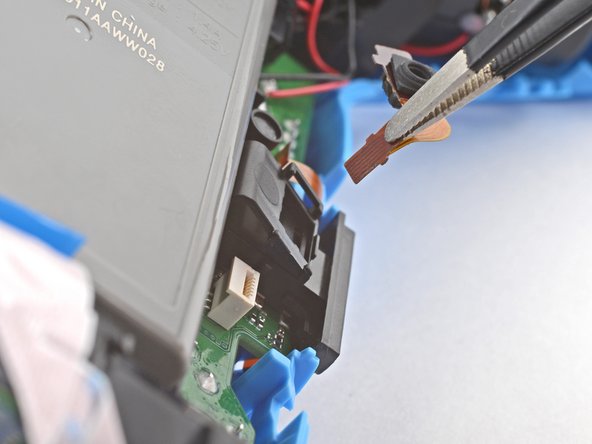

  13. DualSense Controller v2 Microphone Replacement: crwdns2935265:013crwdnd2935265:01crwdnd2935265:02crwdne2935265:0 DualSense Controller v2 Microphone Replacement: crwdns2935265:013crwdnd2935265:02crwdnd2935265:02crwdne2935265:0
    • Use a pair of blunt-nose tweezers or your fingers to grip the lower microphone cable by its pull tab and disconnect it from the motherboard.

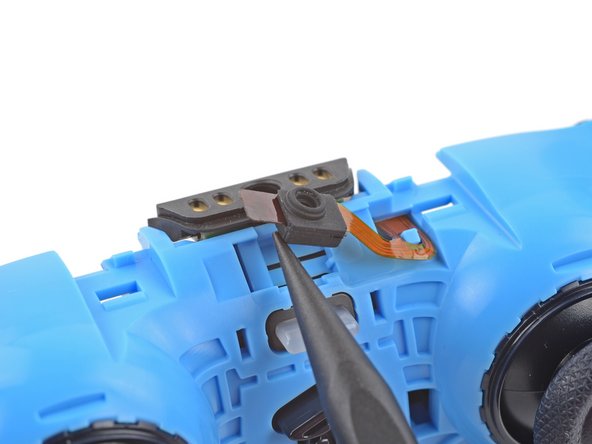

  14. DualSense Controller v2 Microphone Replacement, Remove the upper microphone: crwdns2935265:014crwdnd2935265:01crwdnd2935265:03crwdne2935265:0 DualSense Controller v2 Microphone Replacement, Remove the upper microphone: crwdns2935265:014crwdnd2935265:02crwdnd2935265:03crwdne2935265:0 DualSense Controller v2 Microphone Replacement, Remove the upper microphone: crwdns2935265:014crwdnd2935265:03crwdnd2935265:03crwdne2935265:0
    • Use the pointed end of your spudger to lift the upper microphone out of the front case.
    • During reassembly, make sure the upper microphone's ribbon cable is properly slotted and hooked into the front case.

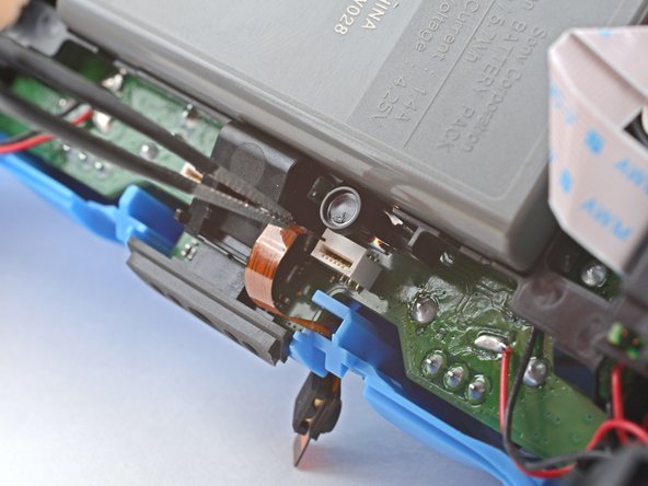

  15. DualSense Controller v2 Microphone Replacement: crwdns2935265:015crwdnd2935265:01crwdnd2935265:02crwdne2935265:0 DualSense Controller v2 Microphone Replacement: crwdns2935265:015crwdnd2935265:02crwdnd2935265:02crwdne2935265:0
    • Use a pair of blunt-nose tweezers or your fingers to grip the upper microphone cable by its pull tab and disconnect it from the motherboard.
    • Don't try to remove the microphone yet—it won't fit out this side of the front case.

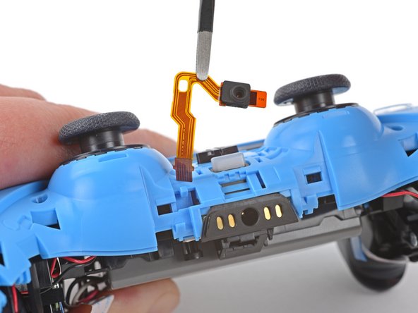

  16. DualSense Controller v2 Microphone Replacement: crwdns2935265:016crwdnd2935265:01crwdnd2935265:02crwdne2935265:0 DualSense Controller v2 Microphone Replacement: crwdns2935265:016crwdnd2935265:02crwdnd2935265:02crwdne2935265:0
    • Use a pair of tweezers or your fingers to remove the upper microphone through the top of the front case.
    • Don't force the cable if you encounter resistance. It may have snagged on the front case.
