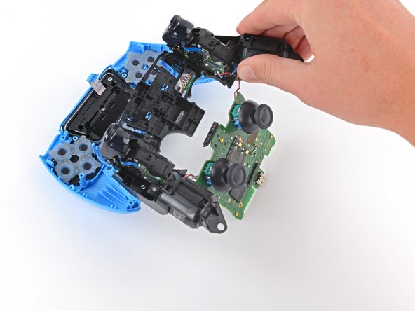

    11. DualSense Controller v2 Adaptive Trigger Replacement, Lift out the motherboard: crwdns2935265:025crwdnd2935265:01crwdnd2935265:03crwdne2935265:0 DualSense Controller v2 Adaptive Trigger Replacement, Lift out the motherboard: crwdns2935265:025crwdnd2935265:02crwdnd2935265:03crwdne2935265:0 DualSense Controller v2 Adaptive Trigger Replacement, Lift out the motherboard: crwdns2935265:025crwdnd2935265:03crwdnd2935265:03crwdne2935265:0
      • Carefully guide the joysticks through the front case and lift the motherboard out.
      • Don't strain the four soldered wires tethering the motherboard to the vibration motors.
    1. DualSense Controller v2 Adaptive Trigger Replacement, Remove the light guide: crwdns2935265:026crwdnd2935265:01crwdnd2935265:03crwdne2935265:0 DualSense Controller v2 Adaptive Trigger Replacement, Remove the light guide: crwdns2935265:026crwdnd2935265:02crwdnd2935265:03crwdne2935265:0 DualSense Controller v2 Adaptive Trigger Replacement, Remove the light guide: crwdns2935265:026crwdnd2935265:03crwdnd2935265:03crwdne2935265:0
      • Use the pointed end of your spudger to lift the center of the light guide out of the controller.
      • Remove the light guide.
    1. DualSense Controller v2 Adaptive Trigger Replacement, Remove the midframe: crwdns2935265:027crwdnd2935265:01crwdnd2935265:01crwdne2935265:0
      • Use your Phillips driver to remove the two 6.5 mm screws securing the midframe to the front case.
    2. DualSense Controller v2 Adaptive Trigger Replacement: crwdns2935265:028crwdnd2935265:01crwdnd2935265:03crwdne2935265:0 DualSense Controller v2 Adaptive Trigger Replacement: crwdns2935265:028crwdnd2935265:02crwdnd2935265:03crwdne2935265:0 DualSense Controller v2 Adaptive Trigger Replacement: crwdns2935265:028crwdnd2935265:03crwdnd2935265:03crwdne2935265:0
      • Carefully lift the midframe and motherboard up and out of the front case.
      • Be careful not to strain the vibrator motor wires.
      • During reassembly, feed the touchpad's ribbon cable back through its rectangular opening in the midframe.

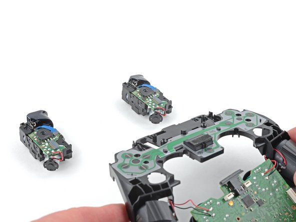

    1. DualSense Controller v2 Adaptive Trigger Replacement, Remove the adaptive triggers: crwdns2935265:029crwdnd2935265:01crwdnd2935265:01crwdne2935265:0
      • Use your Phillips screwdriver to remove the four 6.5 mm screws securing the adaptive triggers to the midframe.
      • The adaptive triggers are loose and will fall out of the midframe.
      • During reassembly, verify the conductive membrane is properly aligned by checking the screw holes and alignment posts.
      • Proper alignment of the conductive membrane is essential for button functionality.
    2. DualSense Controller v2 Adaptive Trigger Replacement: crwdns2935265:030crwdnd2935265:01crwdnd2935265:02crwdne2935265:0 DualSense Controller v2 Adaptive Trigger Replacement: crwdns2935265:030crwdnd2935265:02crwdnd2935265:02crwdne2935265:0
      • Lift the midframe off of the adaptive triggers.
      • Be careful not to pull the vibration motor wires out of the motherboard.
