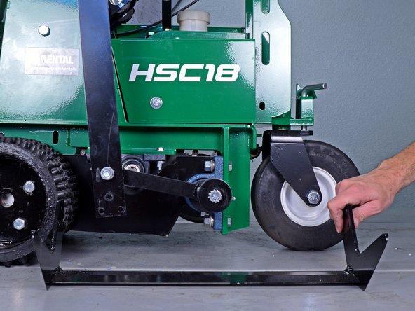

  2. Classen Sod Cutter HSC18AHD 2018 Upper Drive Chain Replacement: crwdns2935265:02crwdnd2935265:01crwdnd2935265:01crwdne2935265:0

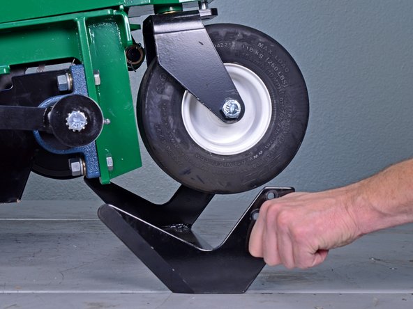

    • Place wheel chocks against the roller and rear wheel to prevent the machine from moving.

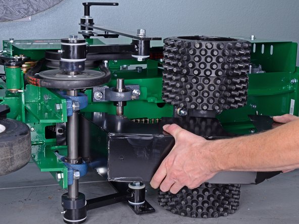

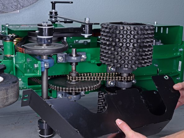

  7. Classen Sod Cutter HSC18AHD 2018 Upper Drive Chain Replacement, Remove the cutter blade: crwdns2935265:07crwdnd2935265:01crwdnd2935265:03crwdne2935265:0 Classen Sod Cutter HSC18AHD 2018 Upper Drive Chain Replacement, Remove the cutter blade: crwdns2935265:07crwdnd2935265:02crwdnd2935265:03crwdne2935265:0 Classen Sod Cutter HSC18AHD 2018 Upper Drive Chain Replacement, Remove the cutter blade: crwdns2935265:07crwdnd2935265:03crwdnd2935265:03crwdne2935265:0
    • Slide the cutter blade out from under the machine to remove it.
    • Do not handle the blade from the cutting edge.

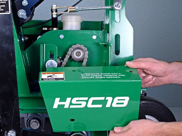

  11. Classen Sod Cutter HSC18AHD 2018 Upper Drive Chain Replacement, Remove the upper chain: crwdns2935265:011crwdnd2935265:01crwdnd2935265:01crwdne2935265:0
    • Use a 1/2 inch socket to remove the two bolts securing the upper chain guard to the frame.
  12. Classen Sod Cutter HSC18AHD 2018 Upper Drive Chain Replacement: crwdns2935265:012crwdnd2935265:01crwdnd2935265:02crwdne2935265:0 Classen Sod Cutter HSC18AHD 2018 Upper Drive Chain Replacement: crwdns2935265:012crwdnd2935265:02crwdnd2935265:02crwdne2935265:0
    • Remove the chain guard.

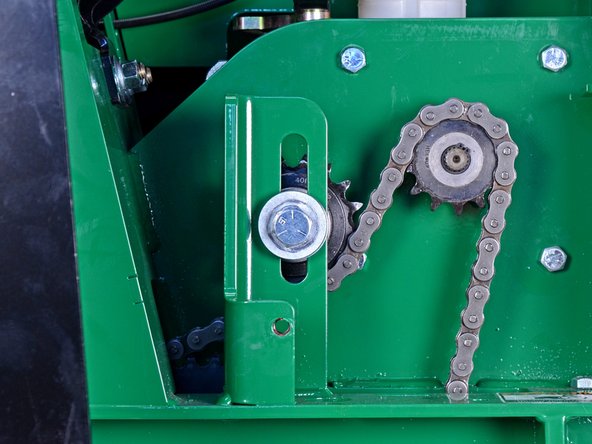

  13. Classen Sod Cutter HSC18AHD 2018 Upper Drive Chain Replacement: crwdns2935265:013crwdnd2935265:01crwdnd2935265:02crwdne2935265:0 Classen Sod Cutter HSC18AHD 2018 Upper Drive Chain Replacement: crwdns2935265:013crwdnd2935265:02crwdnd2935265:02crwdne2935265:0
    • Use a pen to mark the location of the sprocket on the bracket.
    • During reassembly, line up the edge of the washer with the mark to get the sprocket as close to its original location as possible.

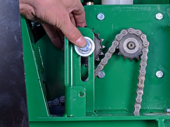

  14. Classen Sod Cutter HSC18AHD 2018 Upper Drive Chain Replacement: crwdns2935265:014crwdnd2935265:01crwdnd2935265:03crwdne2935265:0 Classen Sod Cutter HSC18AHD 2018 Upper Drive Chain Replacement: crwdns2935265:014crwdnd2935265:02crwdnd2935265:03crwdne2935265:0 Classen Sod Cutter HSC18AHD 2018 Upper Drive Chain Replacement: crwdns2935265:014crwdnd2935265:03crwdnd2935265:03crwdne2935265:0

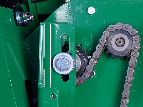

    • Use a 3/4 inch socket to loosen the bolt securing the tensioner sprocket until it can freely slide up and down the bracket.
  15. Classen Sod Cutter HSC18AHD 2018 Upper Drive Chain Replacement: crwdns2935265:015crwdnd2935265:01crwdnd2935265:02crwdne2935265:0 Classen Sod Cutter HSC18AHD 2018 Upper Drive Chain Replacement: crwdns2935265:015crwdnd2935265:02crwdnd2935265:02crwdne2935265:0

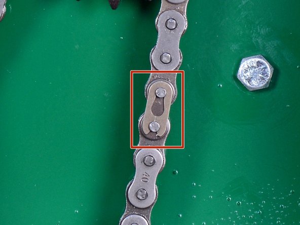

    • Roll the machine to turn the chain until the master link is accessible.
    • Notice the open end of the master link retaining plate is facing down.

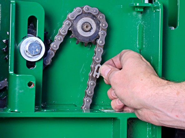

  16. Classen Sod Cutter HSC18AHD 2018 Upper Drive Chain Replacement: crwdns2935265:016crwdnd2935265:01crwdnd2935265:02crwdne2935265:0 Classen Sod Cutter HSC18AHD 2018 Upper Drive Chain Replacement: crwdns2935265:016crwdnd2935265:02crwdnd2935265:02crwdne2935265:0
    • Use pliers to remove the master link retaining plate.
    • Install the new chain with the open end of the master link facing the same direction.
    • Do not install the new chain with the open end of the master link facing up or it could come off during operation.

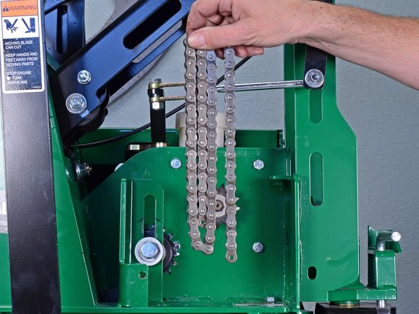

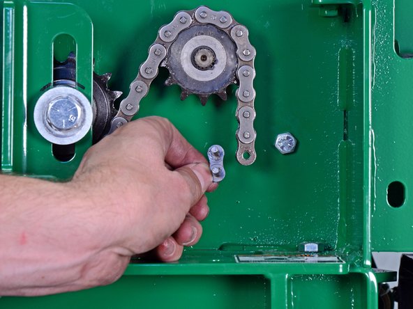

  17. Classen Sod Cutter HSC18AHD 2018 Upper Drive Chain Replacement: crwdns2935265:017crwdnd2935265:01crwdnd2935265:02crwdne2935265:0 Classen Sod Cutter HSC18AHD 2018 Upper Drive Chain Replacement: crwdns2935265:017crwdnd2935265:02crwdnd2935265:02crwdne2935265:0
    • Remove the master link.
    • The chain will fall.
  18. Classen Sod Cutter HSC18AHD 2018 Upper Drive Chain Replacement: crwdns2935265:018crwdnd2935265:01crwdnd2935265:02crwdne2935265:0 Classen Sod Cutter HSC18AHD 2018 Upper Drive Chain Replacement: crwdns2935265:018crwdnd2935265:02crwdnd2935265:02crwdne2935265:0
    • Remove the chain.
