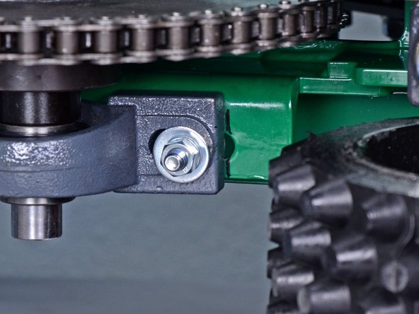

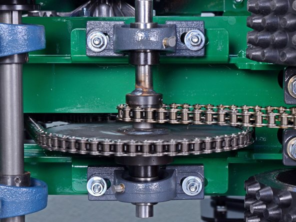

    • Use a marker to mark the locations for each bearing before disassembly.
    • Reference these marks during reassembly to ensure the sprocket shaft is straight and the chain is not too loose.
  12. Classen Sod Cutter HSC18AHD 2018 Lower Drive Chain Replacement: crwdns2935265:012crwdnd2935265:01crwdnd2935265:02crwdne2935265:0 Classen Sod Cutter HSC18AHD 2018 Lower Drive Chain Replacement: crwdns2935265:012crwdnd2935265:02crwdnd2935265:02crwdne2935265:0
    • Loosen the four 1/2 inch bolts securing the sprocket shaft bearings until the sprocket shaft can freely move.

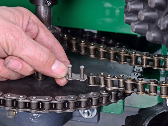

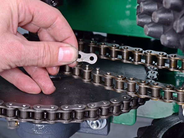

  13. Classen Sod Cutter HSC18AHD 2018 Lower Drive Chain Replacement: crwdns2935265:013crwdnd2935265:01crwdnd2935265:03crwdne2935265:0 Classen Sod Cutter HSC18AHD 2018 Lower Drive Chain Replacement: crwdns2935265:013crwdnd2935265:02crwdnd2935265:03crwdne2935265:0 Classen Sod Cutter HSC18AHD 2018 Lower Drive Chain Replacement: crwdns2935265:013crwdnd2935265:03crwdnd2935265:03crwdne2935265:0
    • Rotate the wheels to turn the chain until the master link is accessible.
    • Use a pair of pliers to unclip the master link retaining plate.
    • Note the direction the retaining plate is facing.
    • Remove the master link.
    • Make sure the new master link retaining plate is installed in the same direction. If installed backwards, the plate could come off during operation.
  14. Classen Sod Cutter HSC18AHD 2018 Lower Drive Chain Replacement: crwdns2935265:014crwdnd2935265:01crwdnd2935265:01crwdne2935265:0
    • Remove the chain.
