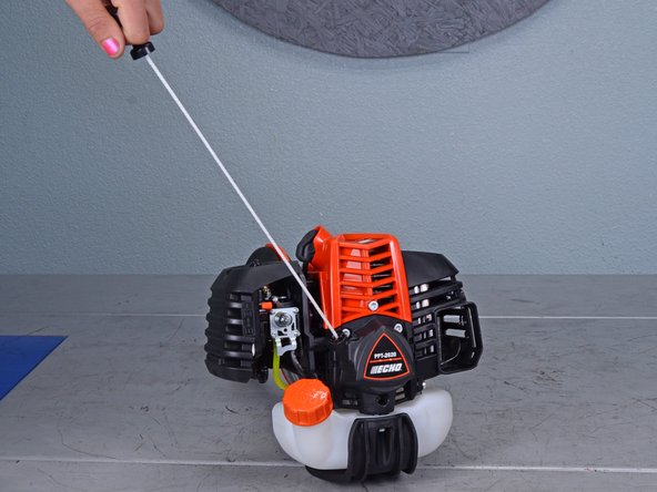

  1. Carburetor Adjustment, Install the inductive pickup lead: crwdns2935265:01crwdnd2935265:01crwdnd2935265:02crwdne2935265:0 Carburetor Adjustment, Install the inductive pickup lead: crwdns2935265:01crwdnd2935265:02crwdnd2935265:02crwdne2935265:0
    • Feed the inductive pickup lead wire through one of the two holes in the lower-left corner of the tachometer.
    • Bend the wire around and feed it through the second hole, then pull it tight.
  2. Carburetor Adjustment, Attach the tachometer to the spark plug wire: crwdns2935265:02crwdnd2935265:01crwdnd2935265:02crwdne2935265:0 Carburetor Adjustment, Attach the tachometer to the spark plug wire: crwdns2935265:02crwdnd2935265:02crwdnd2935265:02crwdne2935265:0
    • Clamp the inductive pickup lead alligator clip onto the spark plug wire.
    • Make sure the inductive pickup lead wire is not touching anything except the tachometer.

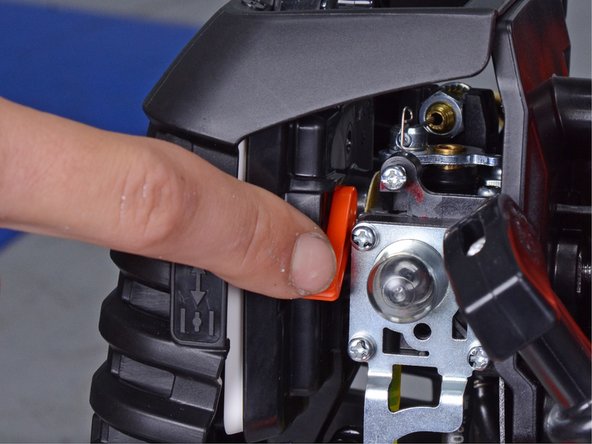

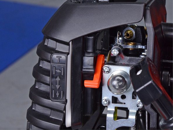

  4. Carburetor Adjustment, Open the choke: crwdns2935265:04crwdnd2935265:01crwdnd2935265:03crwdne2935265:0 Carburetor Adjustment, Open the choke: crwdns2935265:04crwdnd2935265:02crwdnd2935265:03crwdne2935265:0 Carburetor Adjustment, Open the choke: crwdns2935265:04crwdnd2935265:03crwdnd2935265:03crwdne2935265:0
    • Make sure the choke is fully in the open position.

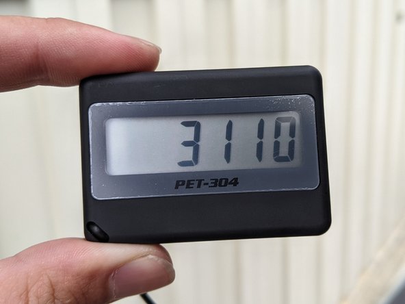

  5. Carburetor Adjustment: crwdns2935265:05crwdnd2935265:01crwdnd2935265:02crwdne2935265:0 Carburetor Adjustment: crwdns2935265:05crwdnd2935265:02crwdnd2935265:02crwdne2935265:0
    • Use a Phillips screwdriver to adjust the carburetor idle screw until the tachometer reads as close to 3100 RPM as possible:
    • Turn the idle screw clockwise to increase RPM
    • Turn the idle screw counterclockwise to decrease RPM
    • Once the idle has been set, shut off the motor and disconnect the tachometer.
The procedure is complete, no further action is required.
