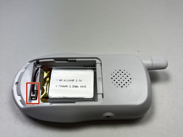

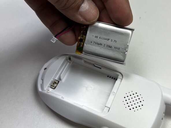

    • Use your fingers to slide the battery cover off the back of the handheld device.
    • Disconnect the battery cable from the connector attached at the bottom of the device.
    • Remove the battery.

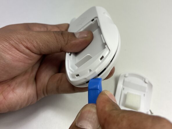

  2. CamPark BM20 Screen Replacement: crwdns2935265:02crwdnd2935265:01crwdnd2935265:02crwdne2935265:0 CamPark BM20 Screen Replacement: crwdns2935265:02crwdnd2935265:02crwdnd2935265:02crwdne2935265:0
    • Use a Phillips #0 screwdriver to remove the three 12.7 mm screws from the lower back of the device.
    • Insert the tip of an iFixit opening tool between the front and back casing seams to release the clips securing the two halves.

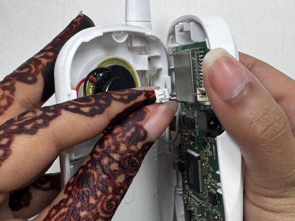

  3. CamPark BM20 Screen Replacement: crwdns2935265:03crwdnd2935265:01crwdnd2935265:02crwdne2935265:0 CamPark BM20 Screen Replacement: crwdns2935265:03crwdnd2935265:02crwdnd2935265:02crwdne2935265:0
    • Gently separate the top and bottom casing.
    • Don't pull the two halves apart as they are still connected by the speaker and antenna cables and you could damage the device.
    • Unplug the speaker cable from the socket on the motherboard.

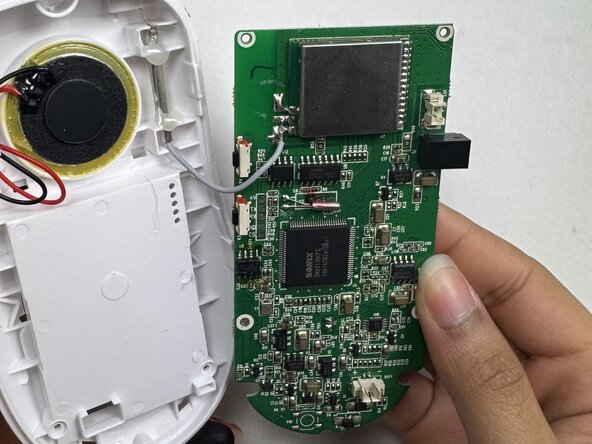

    • Remove the four 6.35 mm screws on the motherboard with a Phillips #00 screwdriver.
    • Remove the motherboard from the front case.
    • The motherboard is still connected to the bottom casing by the antenna cable so be careful that you don't pull the cable and break it.

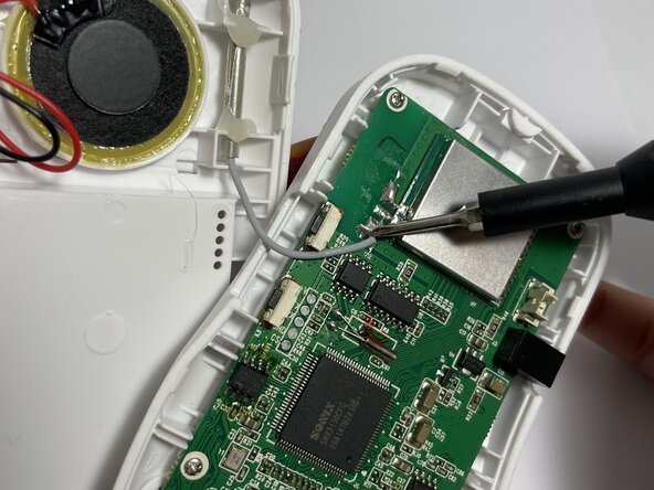

  5. CamPark BM20 Screen Replacement: crwdns2935265:05crwdnd2935265:01crwdnd2935265:03crwdne2935265:0 CamPark BM20 Screen Replacement: crwdns2935265:05crwdnd2935265:02crwdnd2935265:03crwdne2935265:0 CamPark BM20 Screen Replacement: crwdns2935265:05crwdnd2935265:03crwdnd2935265:03crwdne2935265:0
    • Use a soldering iron to desolder the antenna cable from the motherboard of the handheld device.
    • A soldering iron gets extremely hot and can easily burn skin or other surfaces. Always solder in a well-ventilated area.
    • Though the photo shows the board in the case, it is better to desolder the connections after the motherboard is removed.
    • The device’s screen is stacked directly above the motherboard, with both components layered tightly together.

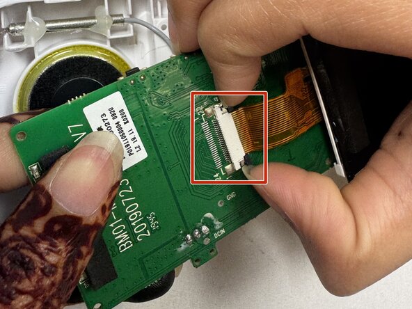

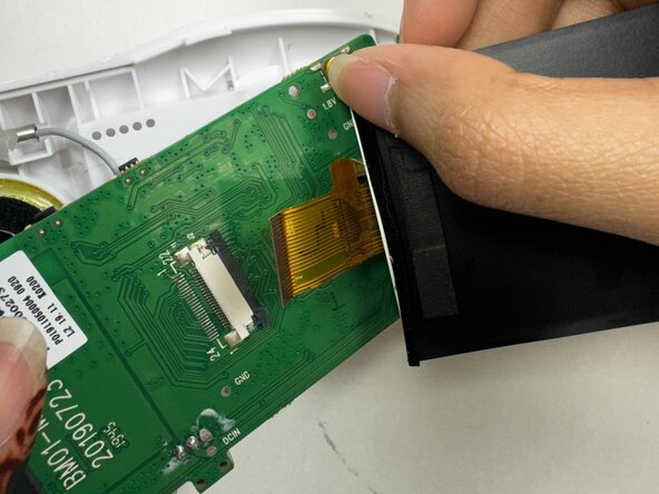

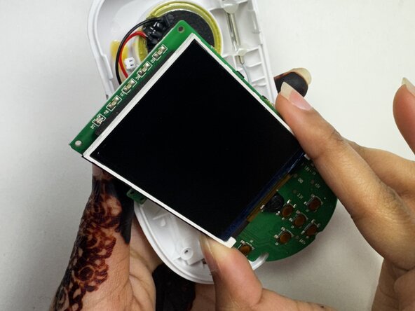

  6. CamPark BM20 Screen Replacement, Screen: crwdns2935265:06crwdnd2935265:01crwdnd2935265:03crwdne2935265:0 CamPark BM20 Screen Replacement, Screen: crwdns2935265:06crwdnd2935265:02crwdnd2935265:03crwdne2935265:0 CamPark BM20 Screen Replacement, Screen: crwdns2935265:06crwdnd2935265:03crwdnd2935265:03crwdne2935265:0
    • Flip the screen forward to reveal the ZIF connector and yellow ribbon cable connecting the screen to the board.
    • Use a spudger or a clean fingernail to flip up the black locking flap under the yellow tape to unlock the connector.
    • Use tweezers or your fingers to gently pull the cable out of its socket.
    • Remove the screen.
