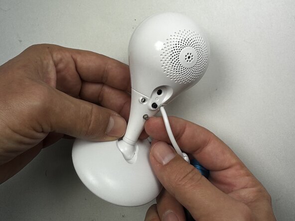

  1. CamPark BM20 Camera Replacement Guide, Swivel Base: crwdns2935265:01crwdnd2935265:01crwdnd2935265:03crwdne2935265:0 CamPark BM20 Camera Replacement Guide, Swivel Base: crwdns2935265:01crwdnd2935265:02crwdnd2935265:03crwdne2935265:0 CamPark BM20 Camera Replacement Guide, Swivel Base: crwdns2935265:01crwdnd2935265:03crwdnd2935265:03crwdne2935265:0

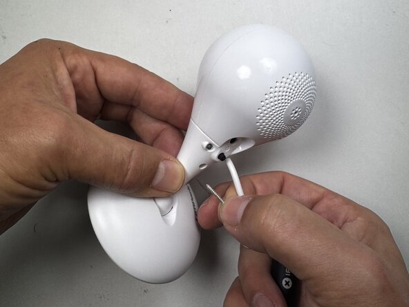

    • Use a Phillips #0 screwdriver to remove the 12.70 mm screw near the bottom of the back panel of the monitor.

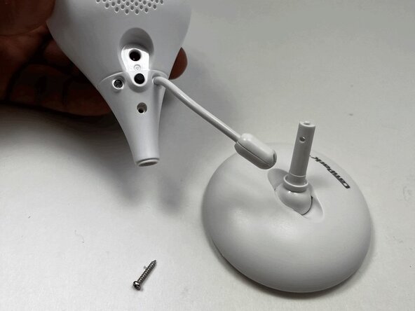

  2. CamPark BM20 Camera Replacement Guide: crwdns2935265:02crwdnd2935265:01crwdnd2935265:02crwdne2935265:0 CamPark BM20 Camera Replacement Guide: crwdns2935265:02crwdnd2935265:02crwdnd2935265:02crwdne2935265:0
    • Pull the base from the main camera unit to remove it.

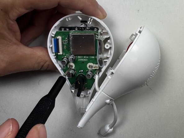

  3. CamPark BM20 Camera Replacement Guide, Camera: crwdns2935265:03crwdnd2935265:01crwdnd2935265:03crwdne2935265:0 CamPark BM20 Camera Replacement Guide, Camera: crwdns2935265:03crwdnd2935265:02crwdnd2935265:03crwdne2935265:0 CamPark BM20 Camera Replacement Guide, Camera: crwdns2935265:03crwdnd2935265:03crwdnd2935265:03crwdne2935265:0

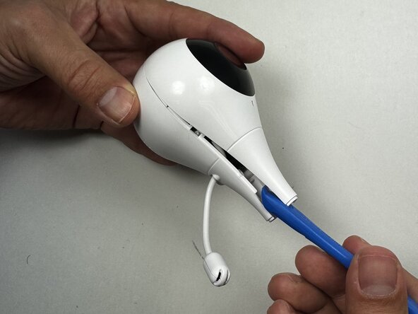

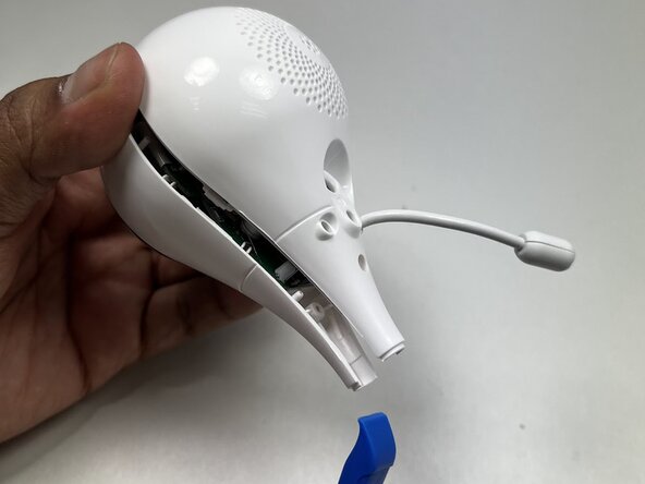

    • Use the iFixIt opening tool to separate the front and back of the camera unit.
    • Place the end of the opening tool between the seams of the front and back of the camera and slide it around the perimeter to release the clips that connect them.
    • Carefully separate the front and back of the camera unit.
    • Don't pull it apart entirely as the front and back are connected by a cable connector.

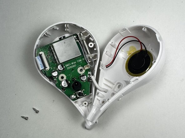

  4. CamPark BM20 Camera Replacement Guide: crwdns2935265:04crwdnd2935265:01crwdnd2935265:03crwdne2935265:0 CamPark BM20 Camera Replacement Guide: crwdns2935265:04crwdnd2935265:02crwdnd2935265:03crwdne2935265:0 CamPark BM20 Camera Replacement Guide: crwdns2935265:04crwdnd2935265:03crwdnd2935265:03crwdne2935265:0
    • Use a Phillips #00 screwdriver to remove the two 6.35 mm screws from the motherboard.

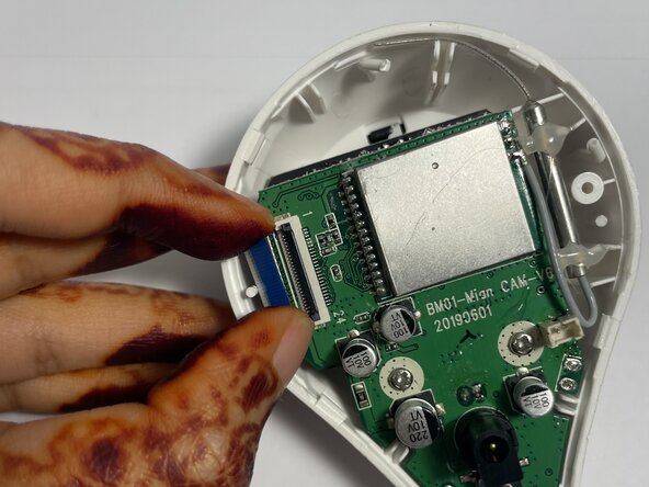

  5. CamPark BM20 Camera Replacement Guide: crwdns2935265:05crwdnd2935265:01crwdnd2935265:03crwdne2935265:0 CamPark BM20 Camera Replacement Guide: crwdns2935265:05crwdnd2935265:02crwdnd2935265:03crwdne2935265:0 CamPark BM20 Camera Replacement Guide: crwdns2935265:05crwdnd2935265:03crwdnd2935265:03crwdne2935265:0

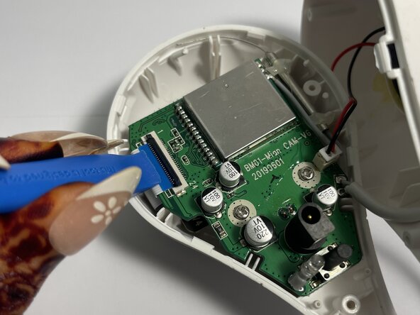

    • Use a spudger, opening tool, or a clean fingernail to flip up the black locking flap of the ZIF connector—this is the unlocked position.
    • Use the widest tool possible to avoid damaging the delicate hinge pins.
    • Use tweezers or your fingers to gently pull the cable out of its socket by the blue tab.
    • You may damage the cable by gripping it directly.
    • To reconnect, make sure the locking flap is flipped up and gently reinsert the cable. Then, flip the locking flap down to secure the cable. The cable should slide into the socket with little to no force. If you're having trouble, remove it, check that the flap is fully unlocked, and try again.
    • To disconnect the cable, first try pushing on alternating sides of the JST connector, like small sliding connectors.
    • If that doesn't work, use a pair of tweezers to firmly grip the sides of the connector and pull straight away from the socket. Hold the tweezers closer to the connector to get a better grip.
    • If you're having trouble, try rocking the connector side-to-side to loosen it.

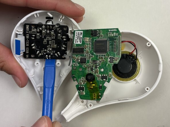

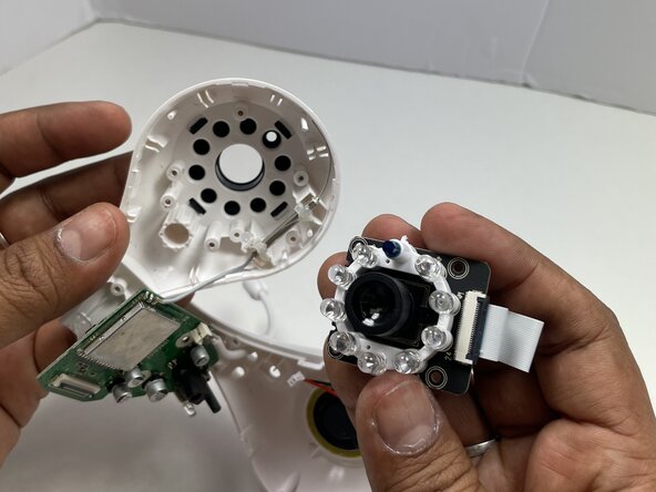

    • Use an opening tool or spudger to lift the motherboard from the top case and gently set it onto the other half of the casing to access the camera.
    • Be careful not to pull or disconnect the motherboard completely—it’s still attached to two soldered cables.

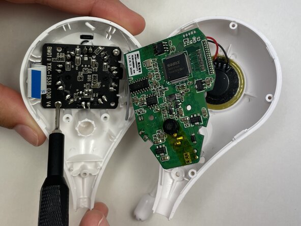

    • Remove the two 6.35 mm Phillips #0 screws holding the camera to the case.
  7. CamPark BM20 Camera Replacement Guide: crwdns2935265:07crwdnd2935265:01crwdnd2935265:02crwdne2935265:0 CamPark BM20 Camera Replacement Guide: crwdns2935265:07crwdnd2935265:02crwdnd2935265:02crwdne2935265:0
    • Use the iFixit opening tool to gently lift the camera out.
