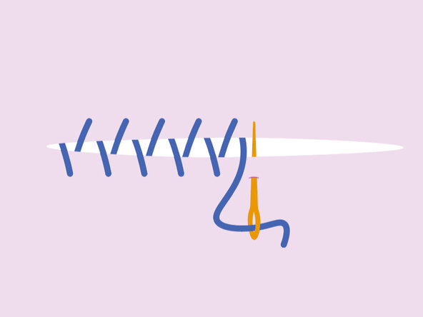

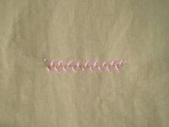

    • Structure - The baseball stitch gets its name from the iconic red seams on a baseball. It consists of alternating diagonal stitches that crisscross over a tear, forming a zigzag pattern.
    • Repair Use - Baseball stitches are perfect for closing a slit or tear in the middle of fabric when there has been minimal fabric loss. It effectively pulls the sides back together like a lacing when tightened.

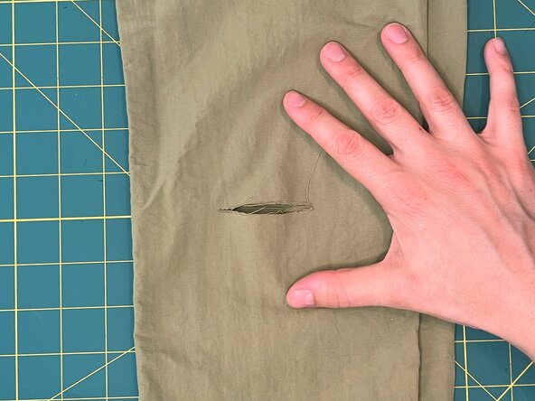

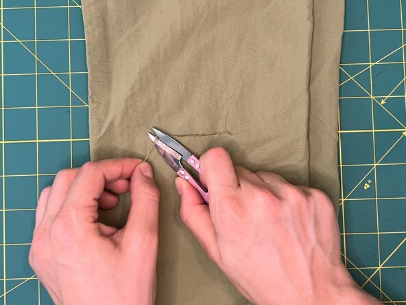

    • Locate the damaged area and trim away any loose or hanging threads.
    • If the fabric is distorted, gently press it flat with your fingers. You can use an iron if it's safe for the fabric.
    • Lay the fabric flat so the edges of the tear align.

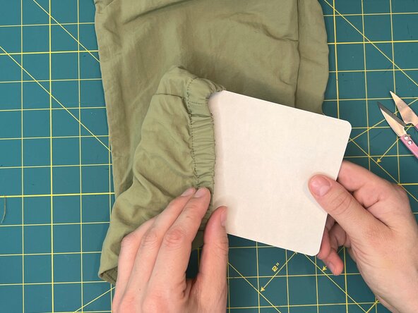

    • For repairs on sleeves, pant legs, or other tight sections, insert a barrier, such as cardboard, between layers to prevent stitching through both sides.

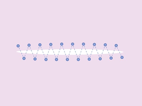

    • A single baseball stitch forms a zigzag pattern across the tear.

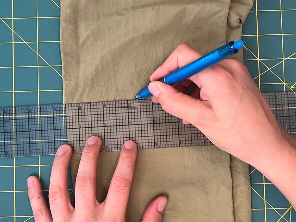

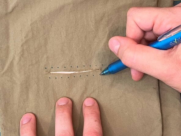

    • Use tailor's chalk or a heat-erasable pen to mark evenly spaced puncture points on both sides of the tear:
    • Place each puncture point about 1/8 inch – 1/4 inch (3 mm – 6 mm) from the raw edge to prevent the stitch from pulling through the fabric.
    • Stagger the points on one side from those on the opposite side to create the zigzag pattern.
    • Align the first and last puncture points with the ends of the tear for full coverage.

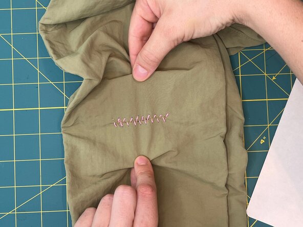

    • Then insert the needle through the front side of the fabric at the next puncture point, on the opposite side of the tear, and bring it up again inside the tear.
    • Pull the thread to bring the edges together. Adjust the tension so the fabric lies flat: too tight and it will pucker; too loose and the tear will remain open.
    • Try to complete the entire stitch with the front side facing up. Flipping the fabric back and forth can misalign the sides of tear.
    • Continue the stitch, alternating sides and always bringing the needle up inside the tear.
    • After each stitch, gently pull the thread to adjust the tension before continuing.
    • Maintain even spacing for a neat finish.
    • Once you push the needle through the final puncture point, leave the needle on the back side of the fabric.
    • Pull the thread to adjust the tension of the last stitch. Make sure the stitch isn't too tight (puckered) or loose (open).

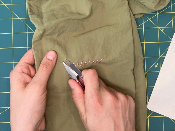

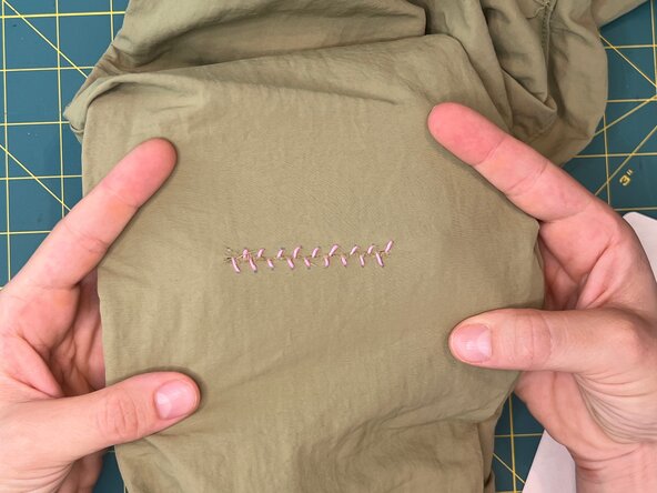

    • Confirm that the stitches are evenly spaced and secure.
    • Check that the fabric lies flat and the tear is fully closed.
    • Snip any loose thread ends, either from the stitch or from the fabric.
