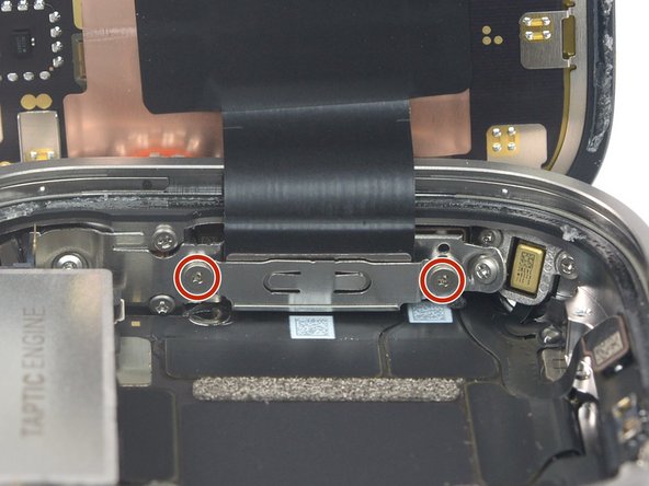

    1. Apple Watch Ultra Screen Replacement, Remove the two connector bracket screws: crwdns2935265:014crwdnd2935265:01crwdnd2935265:01crwdne2935265:0
      • Use a Y000 driver to remove the two 2.3 mm‑long screws securing the metal connector bracket at the bottom edge of the watch.

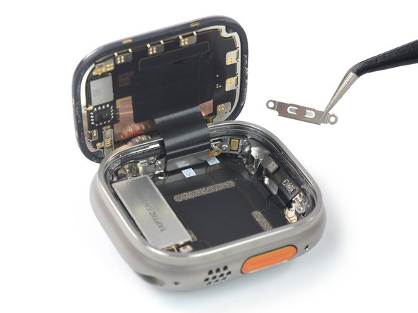

    2. Apple Watch Ultra Screen Replacement, Remove the bottom connector bracket: crwdns2935265:015crwdnd2935265:01crwdnd2935265:02crwdne2935265:0 Apple Watch Ultra Screen Replacement, Remove the bottom connector bracket: crwdns2935265:015crwdnd2935265:02crwdnd2935265:02crwdne2935265:0
      • Use a pair of tweezers to remove the bottom connector bracket.

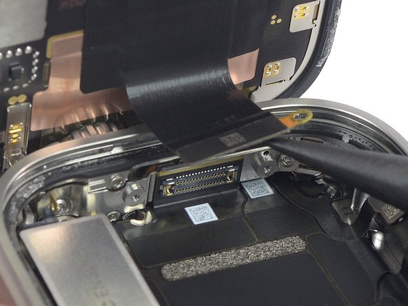

    3. Apple Watch Ultra Screen Replacement, Disconnect the display cable: crwdns2935265:022crwdnd2935265:01crwdnd2935265:02crwdne2935265:0 Apple Watch Ultra Screen Replacement, Disconnect the display cable: crwdns2935265:022crwdnd2935265:02crwdnd2935265:02crwdne2935265:0
      • Use the point of a spudger to pry and disconnect the display cable from its socket.
      • To re-attach press connectors like this one, carefully align and press down on one side until it clicks into place, then repeat on the other side. Do not press down on the middle. If the connector is misaligned, the pins can bend, causing permanent damage.
