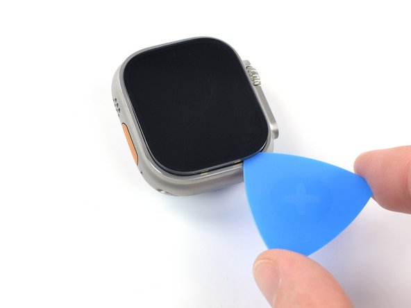

  6. Apple Watch Ultra Battery Replacement, Insert an opening pick: crwdns2935265:06crwdnd2935265:01crwdnd2935265:03crwdne2935265:0 Apple Watch Ultra Battery Replacement, Insert an opening pick: crwdns2935265:06crwdnd2935265:02crwdnd2935265:03crwdne2935265:0 Apple Watch Ultra Battery Replacement, Insert an opening pick: crwdns2935265:06crwdnd2935265:03crwdnd2935265:03crwdne2935265:0
    • Insert an opening pick in the gap you created between the screen and the frame.
    • Remove the iFlex.

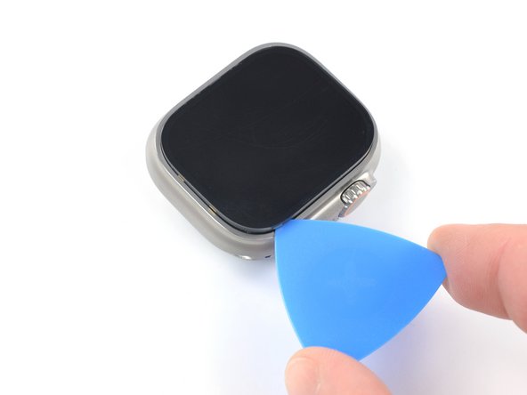

  7. Apple Watch Ultra Battery Replacement, Slice the adhesive: crwdns2935265:07crwdnd2935265:01crwdnd2935265:03crwdne2935265:0 Apple Watch Ultra Battery Replacement, Slice the adhesive: crwdns2935265:07crwdnd2935265:02crwdnd2935265:03crwdne2935265:0 Apple Watch Ultra Battery Replacement, Slice the adhesive: crwdns2935265:07crwdnd2935265:03crwdnd2935265:03crwdne2935265:0
    • Insert the tip of the opening pick less than 2 mm to prevent damaging the antenna pin.
    • Slide the opening pick around the top left corner and along the top edge of the watch to slice the screen adhesive.

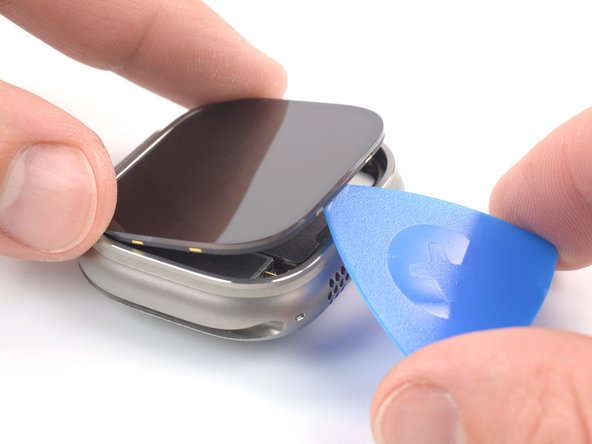

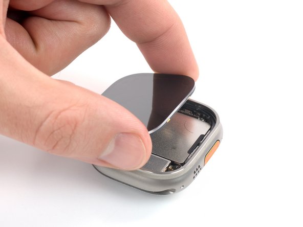

  12. Apple Watch Ultra Battery Replacement, Lift the screen: crwdns2935265:012crwdnd2935265:01crwdnd2935265:02crwdne2935265:0 Apple Watch Ultra Battery Replacement, Lift the screen: crwdns2935265:012crwdnd2935265:02crwdnd2935265:02crwdne2935265:0
    • Insert the opening pick between the screen and frame at the opposite edge of the Digital Crown.
    • Pry up the screen until you can get a good grip with your fingers.
    • Don't try to remove the screen all the way yet. It's still connected to the watch body.
  13. Apple Watch Ultra Battery Replacement, Swing open the screen: crwdns2935265:013crwdnd2935265:01crwdnd2935265:03crwdne2935265:0 Apple Watch Ultra Battery Replacement, Swing open the screen: crwdns2935265:013crwdnd2935265:02crwdnd2935265:03crwdne2935265:0 Apple Watch Ultra Battery Replacement, Swing open the screen: crwdns2935265:013crwdnd2935265:03crwdnd2935265:03crwdne2935265:0
    • Be careful not to strain the screen cable when you swing open the screen.
    • Lift the screen up and carefully pull it towards the Digital Crown.
    • Swing the screen open to an upward position.

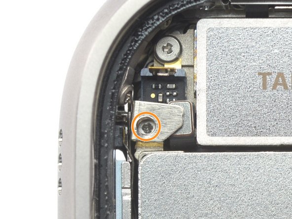

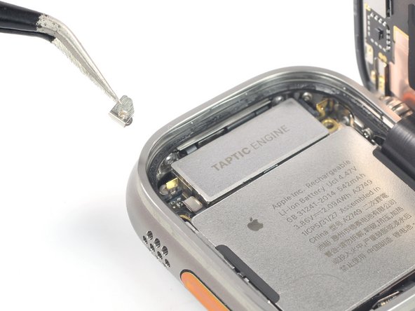

  14. Apple Watch Ultra Battery Replacement, Remove the two connector bracket screws: crwdns2935265:014crwdnd2935265:01crwdnd2935265:01crwdne2935265:0
    • Use a Y000 driver to remove the two 2.3 mm‑long screws securing the metal connector bracket at the bottom edge of the watch.
  15. Apple Watch Ultra Battery Replacement, Remove the bottom connector bracket: crwdns2935265:015crwdnd2935265:01crwdnd2935265:02crwdne2935265:0 Apple Watch Ultra Battery Replacement, Remove the bottom connector bracket: crwdns2935265:015crwdnd2935265:02crwdnd2935265:02crwdne2935265:0
    • Use a pair of tweezers to remove the bottom connector bracket.

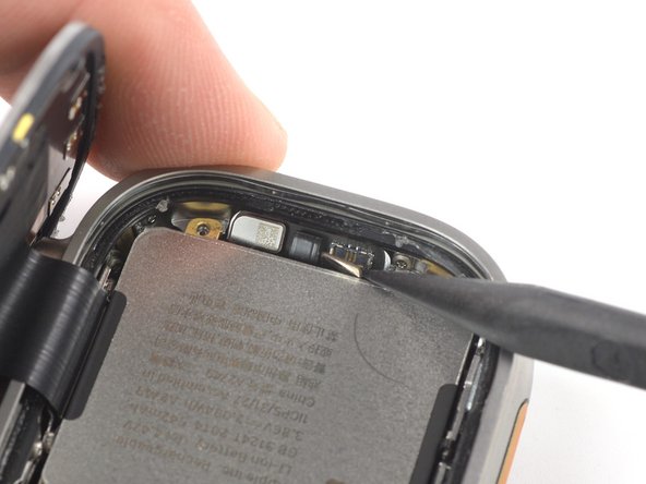

  16. Apple Watch Ultra Battery Replacement, Disconnect the battery: crwdns2935265:016crwdnd2935265:01crwdnd2935265:02crwdne2935265:0 Apple Watch Ultra Battery Replacement, Disconnect the battery: crwdns2935265:016crwdnd2935265:02crwdnd2935265:02crwdne2935265:0
    • Use the point of a spudger to pry up the battery connector towards the battery.
    • During reassembly, this is a good point to power on your device and test all functions before sealing it up. Be sure to power your watch back down completely before you continue working.
  17. Apple Watch Ultra Battery Replacement, Remove the upper battery screws: crwdns2935265:017crwdnd2935265:01crwdnd2935265:02crwdne2935265:0 Apple Watch Ultra Battery Replacement, Remove the upper battery screws: crwdns2935265:017crwdnd2935265:02crwdnd2935265:02crwdne2935265:0
    • Use a Y000 driver to remove the 2.9 mm‑long screw securing the battery.
    • Use a Y000 driver to unscrew the 2.1 mm‑long screw that's sandwiched between the metal bracket.
  18. Apple Watch Ultra Battery Replacement, Remove the metal bracket including the screw: crwdns2935265:018crwdnd2935265:01crwdnd2935265:02crwdne2935265:0 Apple Watch Ultra Battery Replacement, Remove the metal bracket including the screw: crwdns2935265:018crwdnd2935265:02crwdnd2935265:02crwdne2935265:0
    • Use a pair of tweezers to remove the bracket with the screw sandwiched between it.
    • Although the screw sits nicely in the bracket, it’s not captive and can fall out.

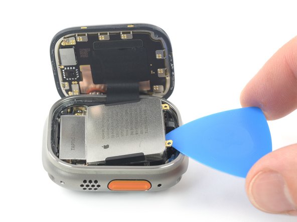

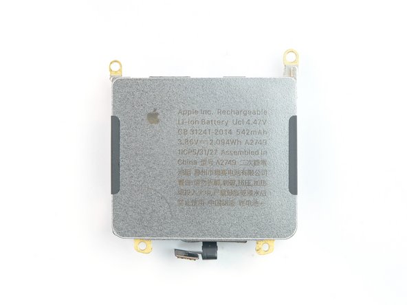

  19. Apple Watch Ultra Battery Replacement, Remove the battery: crwdns2935265:019crwdnd2935265:01crwdnd2935265:03crwdne2935265:0 Apple Watch Ultra Battery Replacement, Remove the battery: crwdns2935265:019crwdnd2935265:02crwdnd2935265:03crwdne2935265:0 Apple Watch Ultra Battery Replacement, Remove the battery: crwdns2935265:019crwdnd2935265:03crwdnd2935265:03crwdne2935265:0
    • Use an opening pick to lift up the battery.
    • Remove the battery from the case.
    • Don't reinstall a damaged or deformed battery, as doing so is a potential safety hazard.
