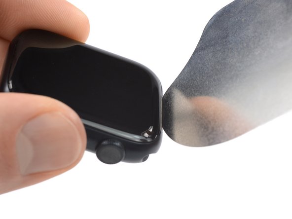

    • Because the gap between the screen and watch body is so thin, an iFlex is needed to separate the two.
    • Protect your fingers by keeping them completely clear of the iFlex edge. If in doubt, protect your free hand with a heavy glove, such as a leather shop glove or gardening glove.
    • Be careful not to apply too much pressure, as this might cause the iFlex to slip and cut you, or damage the watch.
    • Wear eye protection. If the opening procedure is performed incorrectly or with too much pressure, the glass could crack, sending small glass shards flying.
    • Attach or remove the watch band as needed to provide more control as you make repairs.

  4. Apple Watch Series 7 Screen Replacement, Create a gap: crwdns2935265:04crwdnd2935265:01crwdnd2935265:03crwdne2935265:0 Apple Watch Series 7 Screen Replacement, Create a gap: crwdns2935265:04crwdnd2935265:02crwdnd2935265:03crwdne2935265:0 Apple Watch Series 7 Screen Replacement, Create a gap: crwdns2935265:04crwdnd2935265:03crwdnd2935265:03crwdne2935265:0
    Cut-Resistant ESD Gloves
    $19.99
    • Don't grip the iFlex or similar metal tools by the edges—they're very sharp. Consider wearing gloves to protect your hands.
    • Insert the iFlex at a downward angle between the bottom edge of the screen and frame.
    • The Apple Watch Series 7 display is equipped with a plastic bezel on its rear side. If you want to reuse your display, avoid using too much pressure with the iFlex or you may separate the bezel from the screen.
