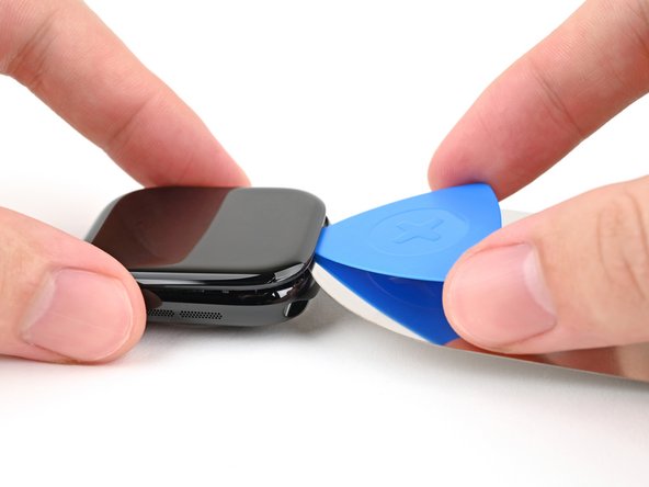

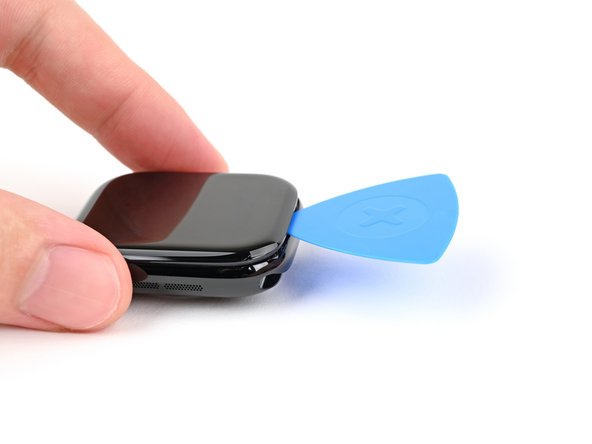

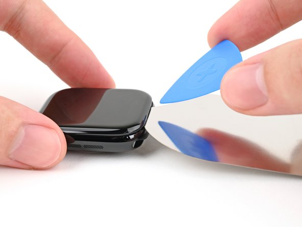

  6. Apple Watch Series 7 Battery Replacement, Insert an opening pick: crwdns2935265:06crwdnd2935265:01crwdnd2935265:03crwdne2935265:0 Apple Watch Series 7 Battery Replacement, Insert an opening pick: crwdns2935265:06crwdnd2935265:02crwdnd2935265:03crwdne2935265:0 Apple Watch Series 7 Battery Replacement, Insert an opening pick: crwdns2935265:06crwdnd2935265:03crwdnd2935265:03crwdne2935265:0
    • Do not insert your opening pick more than 3 mm under the screen when separating the adhesive, as you risk damaging your watches internals.
    • Keep the iFlex flat to maintain a gap between the screen and frame while inserting an opening pick.
    • Insert an opening pick between the screen and iFlex.
    • Remove the iFlex.

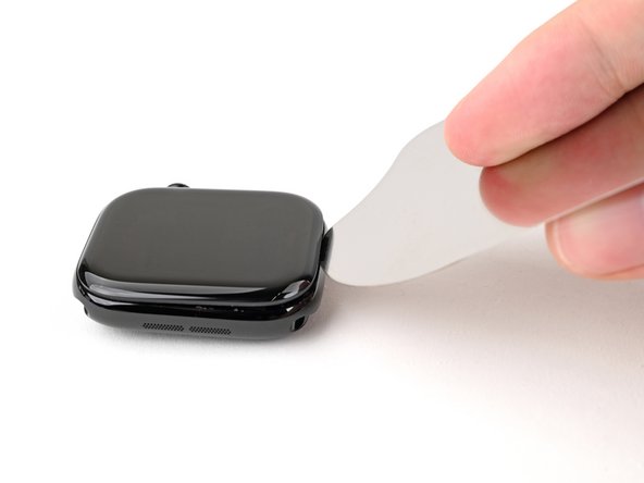

  7. Apple Watch Series 7 Battery Replacement, Slice the adhesive: crwdns2935265:07crwdnd2935265:01crwdnd2935265:02crwdne2935265:0 Apple Watch Series 7 Battery Replacement, Slice the adhesive: crwdns2935265:07crwdnd2935265:02crwdnd2935265:02crwdne2935265:0
    • Slide the opening pick around the bottom left corner and up the left edge.

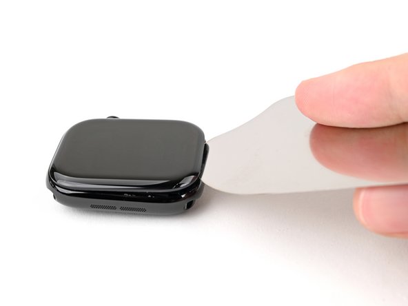

  8. Apple Watch Series 7 Battery Replacement: crwdns2935265:08crwdnd2935265:01crwdnd2935265:02crwdne2935265:0 Apple Watch Series 7 Battery Replacement: crwdns2935265:08crwdnd2935265:02crwdnd2935265:02crwdne2935265:0
    • Slide the opening pick around the corner and along the long edge on the opposite side of the watch crown to slice the display adhesive.
