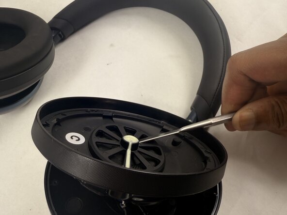

    • Flip over the device so the ear pads face up.
    • This replacement guide will only cover one of the ear pads. The same exact steps apply to both.
  2. Anker Soundcore Space One Microphone Replacement: crwdns2935265:02crwdnd2935265:01crwdnd2935265:02crwdne2935265:0 Anker Soundcore Space One Microphone Replacement: crwdns2935265:02crwdnd2935265:02crwdnd2935265:02crwdne2935265:0
    • Take a spudger (plastic or metal) and carefully insert it into the seam between the ear pad and the driver housing.
    • Using a metal spudger (like the one pictured) can cut you if not used correctly. Please be mindful of where you insert it if you choose to use one.
    • Pry around the ear pad in a circular path until it fully releases.

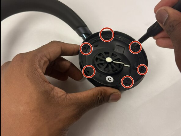

    • After removing the ear pad, keep the device positioned with the under-side facing up.
    • Remove the six 6.1 mm Phillips #00 screws from the driver housing.
    • This replacement guide will only cover one of the device's drivers. The same steps apply to both.

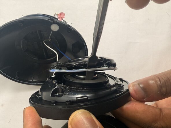

    • With a spudger (metal or plastic), carefully remove the interior plate component. Do this by applying an upward force on the interior area with ridges and a glue spot
    • This component has wires still connected to it, so don't be too aggressive when popping the component off

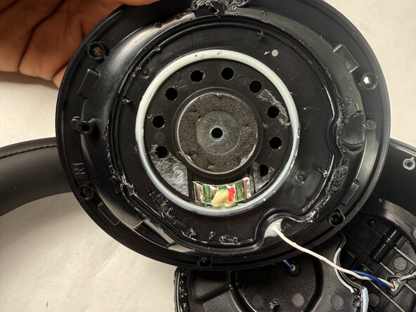

  6. Anker Soundcore Space One Microphone Replacement: crwdns2935265:06crwdnd2935265:01crwdnd2935265:02crwdne2935265:0 Anker Soundcore Space One Microphone Replacement: crwdns2935265:06crwdnd2935265:02crwdnd2935265:02crwdne2935265:0
    • Flip over the popped-off plate component. Use the soldering iron to burn off the adhesive glue protecting the innards of the device in this area
    • The soldering iron is extremely hot. Please be careful when using it
    • With the soldering iron, go in a circular path around the underside of the component where the glue binds it together (the white lining)
    • The component should pop off after using it (a spudger might be needed to get more leverage when popping it off)

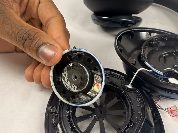

  7. Anker Soundcore Space One Microphone Replacement: crwdns2935265:07crwdnd2935265:01crwdnd2935265:02crwdne2935265:0 Anker Soundcore Space One Microphone Replacement: crwdns2935265:07crwdnd2935265:02crwdnd2935265:02crwdne2935265:0
    • Use a spudger to remove the adhesive layer surrounding the driver component
    • The actual driver is the metal disc in the center. The entire driver component includes everything inside the white lining (pictured in the second image)
  8. Anker Soundcore Space One Microphone Replacement: crwdns2935265:08crwdnd2935265:01crwdnd2935265:02crwdne2935265:0 Anker Soundcore Space One Microphone Replacement: crwdns2935265:08crwdnd2935265:02crwdnd2935265:02crwdne2935265:0
    • Insert a phillips #00 screwdriver into the hole in the center of the actual driver
    • With upward force, pop off the driver component
    • You will have to replace the entire driver component pictured, since there's no given way to retrieve the actual driver. If done, it could risk damaging interior components
