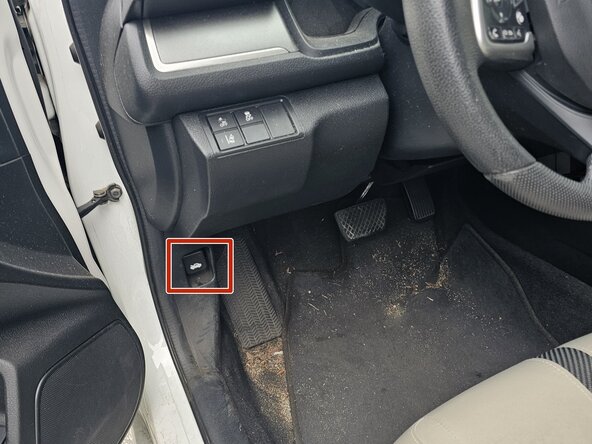

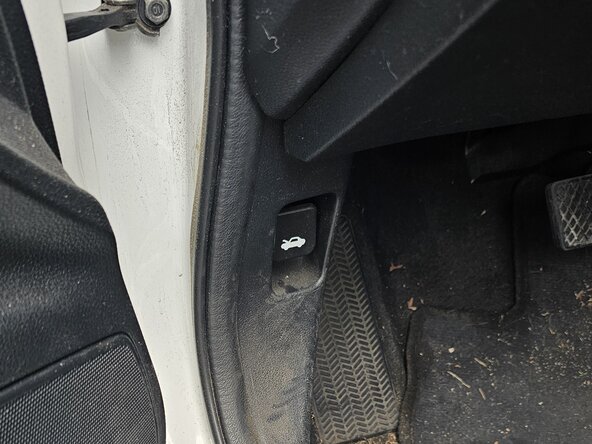

    • Open the driver's side door and look between the speaker and steering wheel.
    • Pull the lever with the icon showing a car with an open hood to release the hood.

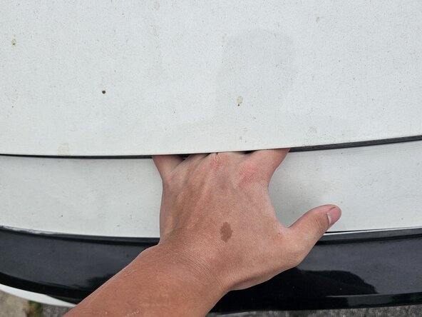

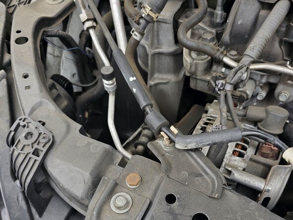

    • Insert your hand into the space under the hood slightly left of center, then slide it to the right.
    • With the lever compressed, pull the hood up with your other hand.

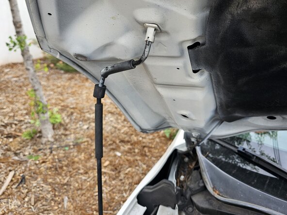

    • Lift the hood prop rod and slide the end into the hole in the roof of the hood.
    • Make sure that it is securely attached and holding the hood up before you let it go to avoid injury.

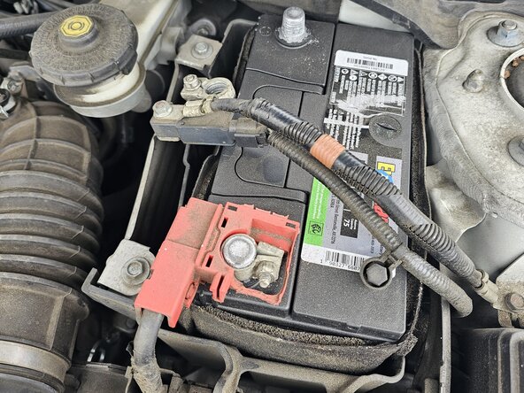

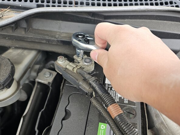

  3. 2016-2020 Honda Civic Battery Replacement: crwdns2935265:03crwdnd2935265:01crwdnd2935265:03crwdne2935265:0 2016-2020 Honda Civic Battery Replacement: crwdns2935265:03crwdnd2935265:02crwdnd2935265:03crwdne2935265:0 2016-2020 Honda Civic Battery Replacement: crwdns2935265:03crwdnd2935265:03crwdnd2935265:03crwdne2935265:0

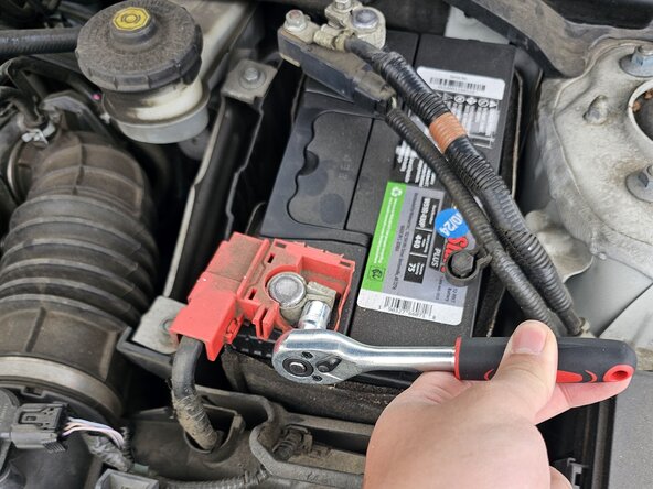

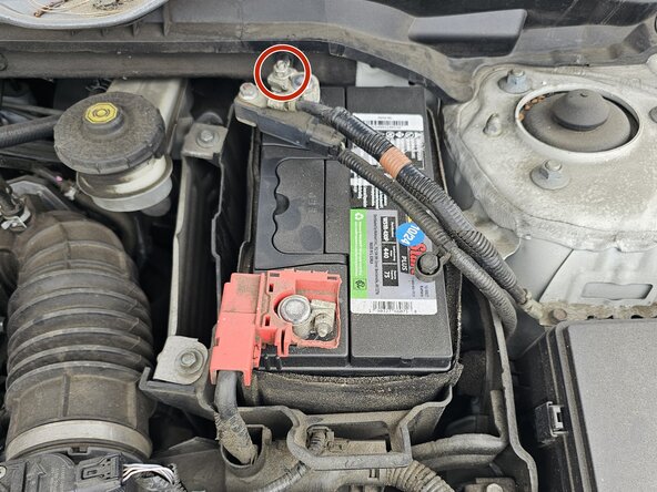

    • With the socket wrench, loosen the nut on the negative (black) terminal of the battery.
    • It is important to remove the negative (black) contact first to minimize the risk of short-circuiting the battery.
    • Pull straight up on the cable connector after loosening it.

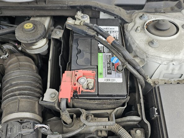

  4. 2016-2020 Honda Civic Battery Replacement: crwdns2935265:04crwdnd2935265:01crwdnd2935265:03crwdne2935265:0 2016-2020 Honda Civic Battery Replacement: crwdns2935265:04crwdnd2935265:02crwdnd2935265:03crwdne2935265:0 2016-2020 Honda Civic Battery Replacement: crwdns2935265:04crwdnd2935265:03crwdnd2935265:03crwdne2935265:0

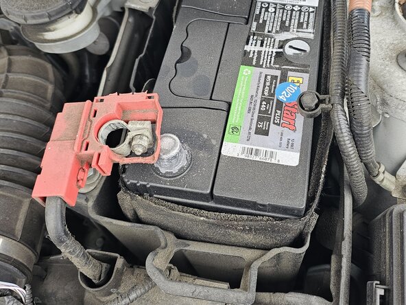

    • Use a 10 mm wrench to loosen the nut on the positive (red) contact.
    • When loosened, pull straight up to remove the contact.
  5. 2016-2020 Honda Civic Battery Replacement: crwdns2935265:05crwdnd2935265:01crwdnd2935265:03crwdne2935265:0 2016-2020 Honda Civic Battery Replacement: crwdns2935265:05crwdnd2935265:02crwdnd2935265:03crwdne2935265:0 2016-2020 Honda Civic Battery Replacement: crwdns2935265:05crwdnd2935265:03crwdnd2935265:03crwdne2935265:0

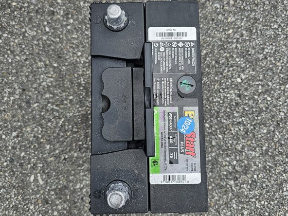

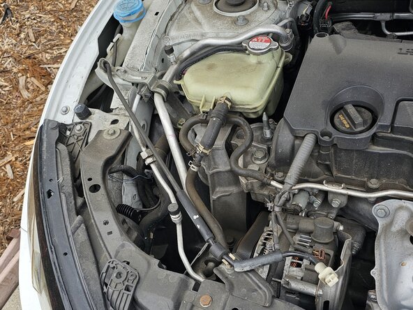

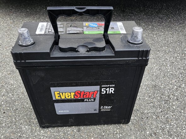

    • Lift the battery out of the engine bay using the handle on top.
    • Place the new battery into the compartment with the negative terminal at the top (farthest from you) and the positive terminal at the bottom (closest to you) as you stand in front of the hood.
    • Make sure the new battery is orientated like the old one to ensure correct terminal connections.

    • Hold the hood with one hand, remove the hood prop, and clip it back into place at the top of the engine bay.

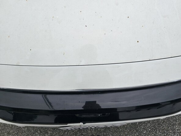

    • Close the hood by lowering it to a few inches above the latch, then let it drop into place.
    • Pressing down instead of dropping may prevent it from closing properly.
