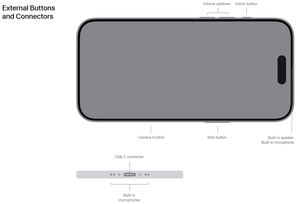

The iPhone Air features a 6.5-inch (diagonal) flat glass screen, thin black bezels, a pill-shaped, black "dynamic island" at the top of the screen, matte back glass, and glossy titanium side rails. It also has a glass "camera plateau" that runs horizontally along the top of the back cover with a single protruding camera.
Volume controls and the Action Button can be found on the left edge, while the power button and Camera Control button are situated on the right. A pill-shaped camera "plateau" containing the camera aligned horizontally protrudes from the back case. This model has no home button.
The iPhone Air can be differentiated from other iPhones by being uniquely thin, while containing modern features like USB-C.
