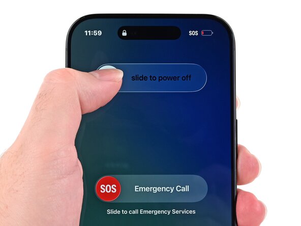

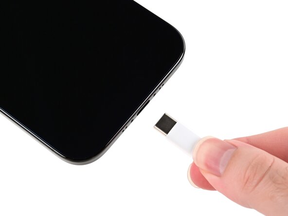

  1. iPhone Air Back Glass Replacement, Prepare your phone for disassembly: crwdns2935265:01crwdnd2935265:01crwdnd2935265:02crwdne2935265:0 iPhone Air Back Glass Replacement, Prepare your phone for disassembly: crwdns2935265:01crwdnd2935265:02crwdnd2935265:02crwdne2935265:0
    • Let your phone's battery drain below 25% before starting this repair—a charged lithium‑ion battery may catch fire if damaged.
    • Unplug any cables from your phone.
    • Hold the power and either volume button and slide to power off your phone.

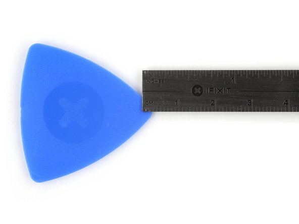

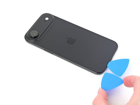

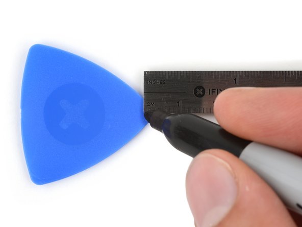

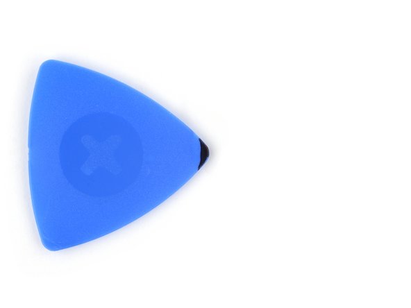

  2. iPhone Air Back Glass Replacement, Mark your opening picks: crwdns2935265:02crwdnd2935265:01crwdnd2935265:03crwdne2935265:0 iPhone Air Back Glass Replacement, Mark your opening picks: crwdns2935265:02crwdnd2935265:02crwdnd2935265:03crwdne2935265:0 iPhone Air Back Glass Replacement, Mark your opening picks: crwdns2935265:02crwdnd2935265:03crwdnd2935265:03crwdne2935265:0
    • If inserted too far, an opening pick can damage your device. Follow this step to mark your pick and prevent damage.
    • Measure 3 mm from the tip and mark the opening pick with a permanent marker.
    • You can also mark the other corners of the pick with different measurements.
    • Alternatively, tape a coin to a pick 3 mm from the tip.

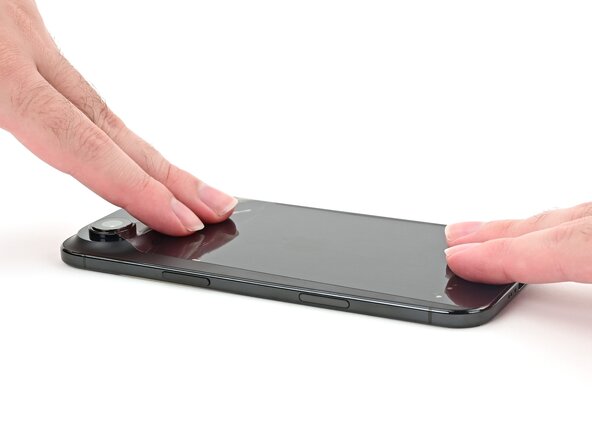

  3. iPhone Air Back Glass Replacement, Cracked glass preparation: crwdns2935265:03crwdnd2935265:01crwdnd2935265:01crwdne2935265:0
    • Glass shards can complicate disassembly—or worse, cause injury. If your phone's back glass is cracked, follow this step.
    • Apply packing tape to the cracked glass until it's completely covered—this will help keep the glass contained and allow the suction cup to stick.
    • Make sure there's a single strip (not overlapping) of tape on the bottom edge, big enough for a suction cup to fit on.
    • Only cover the glass itself—don't stick any tape to the frame.
    • Consider wearing safety glasses to protect your eyes from any glass shaken free during the repair.

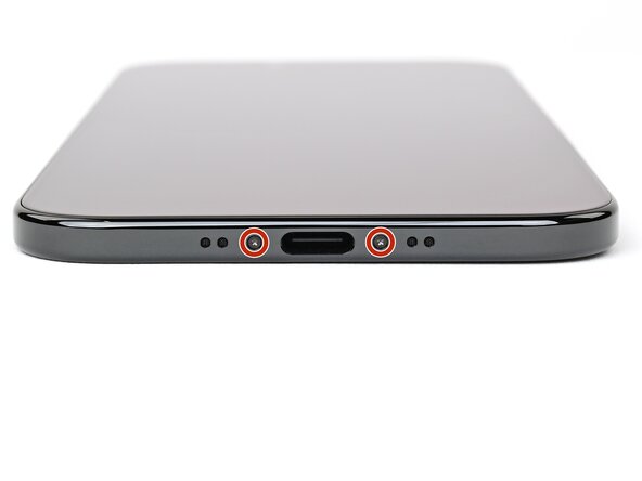

  4. iPhone Air Back Glass Replacement, Remove the pentalobe screws: crwdns2935265:04crwdnd2935265:01crwdnd2935265:01crwdne2935265:0
    • Use a P2 pentalobe driver to remove the two 4.9 mm-long screws on either side of the USB-C port.

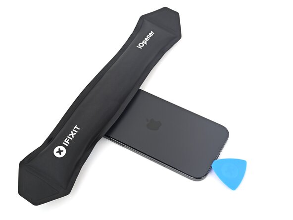

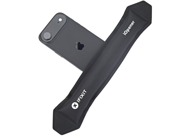

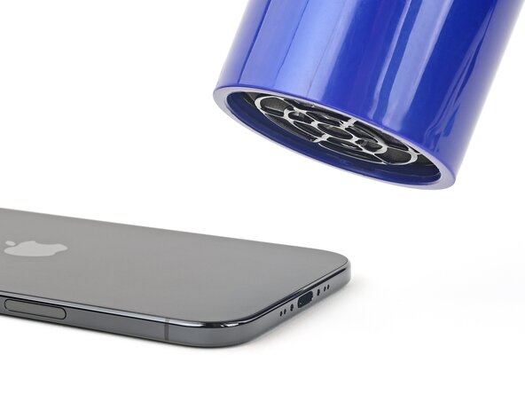

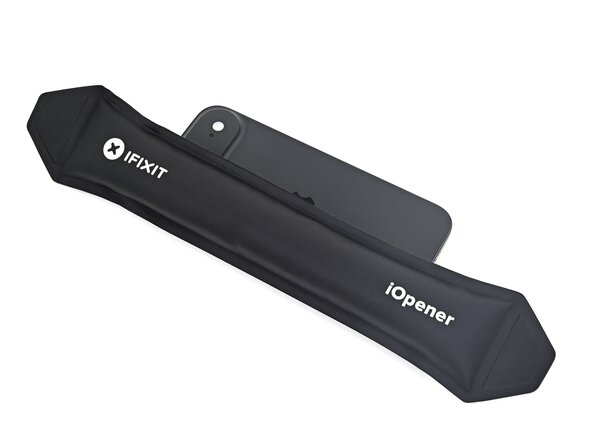

  5. iPhone Air Back Glass Replacement, Heat the bottom edge: crwdns2935265:05crwdnd2935265:01crwdnd2935265:02crwdne2935265:0 iPhone Air Back Glass Replacement, Heat the bottom edge: crwdns2935265:05crwdnd2935265:02crwdnd2935265:02crwdne2935265:0
    • Apply a heated iOpener to the bottom edge of the back glass for two minutes.
    • Alternatively, you can use a hair dryer or heat gun to heat the bottom edge of the back glass until it's slightly too hot to touch.
    • Improper use of a heat gun can destroy the display and/or battery—follow the linked instructions carefully.

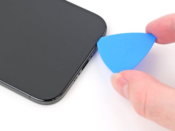

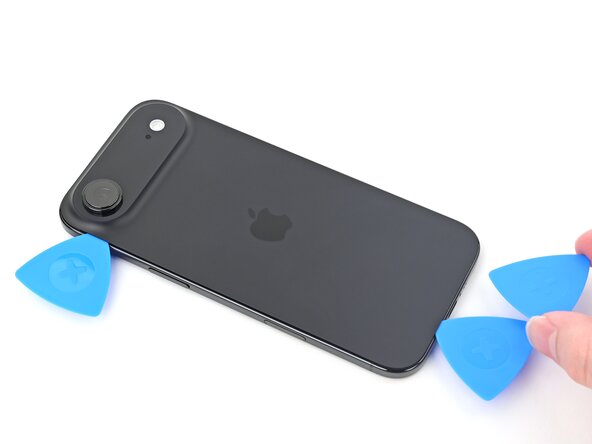

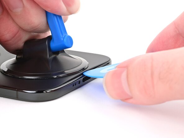

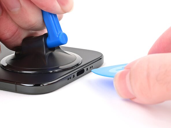

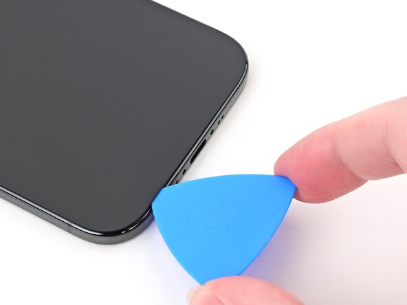

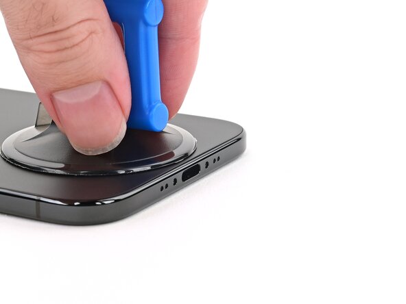

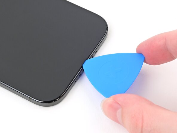

  6. iPhone Air Back Glass Replacement, Insert an opening pick: crwdns2935265:06crwdnd2935265:01crwdnd2935265:03crwdne2935265:0 iPhone Air Back Glass Replacement, Insert an opening pick: crwdns2935265:06crwdnd2935265:02crwdnd2935265:03crwdne2935265:0 iPhone Air Back Glass Replacement, Insert an opening pick: crwdns2935265:06crwdnd2935265:03crwdnd2935265:03crwdne2935265:0
    • Apply a suction handle to the bottom edge of the back glass, as close to the edge as possible.
    • Pull up on the handle with strong, steady force to create a gap between the back glass and the frame.
    • If the back glass doesn't budge, reheat it and try again.
    • Insert the tip of an opening pick into the gap.

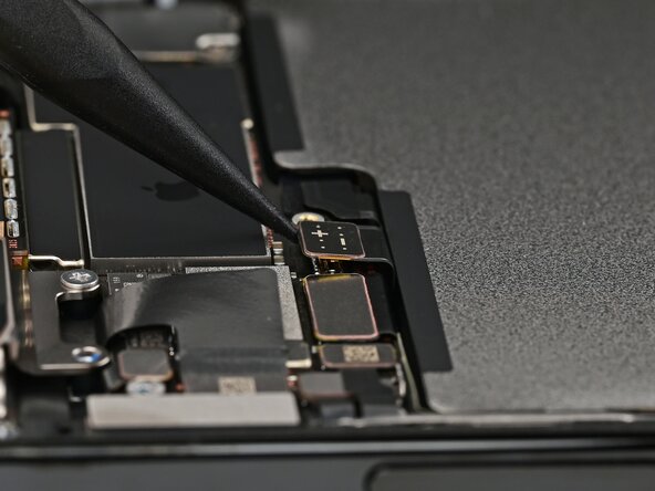

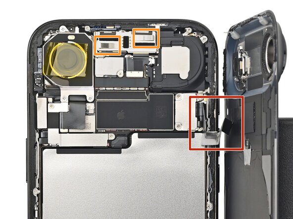

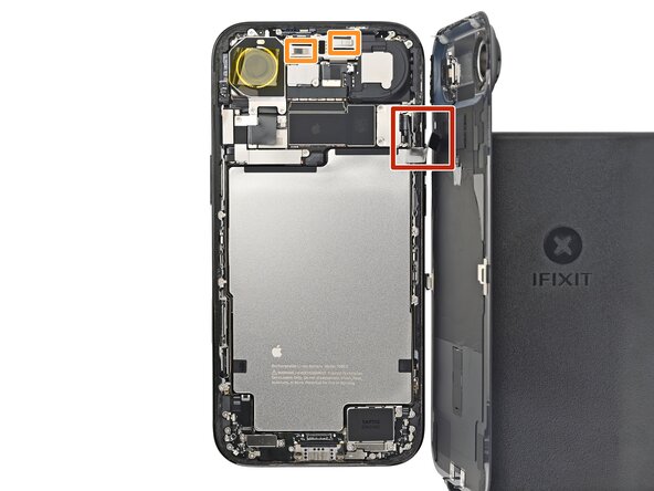

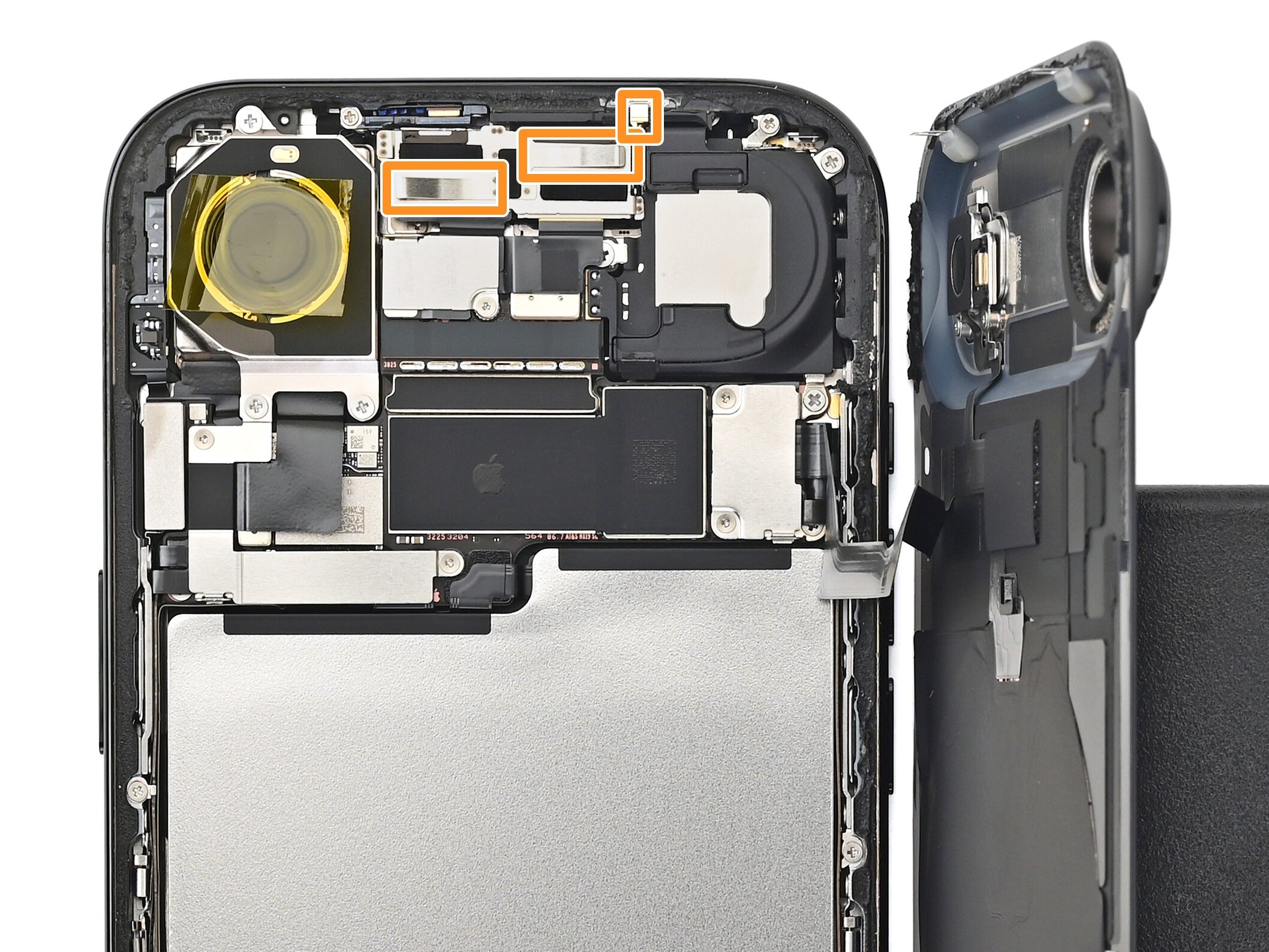

  7. iPhone Air Back Glass Replacement, Back glass information: crwdns2935265:07crwdnd2935265:01crwdnd2935265:02crwdne2935265:0 iPhone Air Back Glass Replacement, Back glass information: crwdns2935265:07crwdnd2935265:02crwdnd2935265:02crwdne2935265:0
    • As you slice the adhesive securing the back glass in the next steps, be careful of the following areas:
    • There's a delicate cable connecting the back glass to the phone, right next to the volume up button.
    • There are multiple spring contacts along the top edge of the phone. Be extra careful not to insert your pick deeper than instructed in each step to avoid bending these contacts.

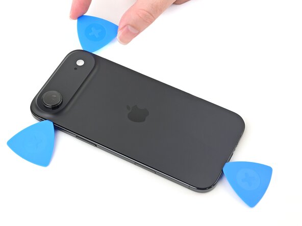

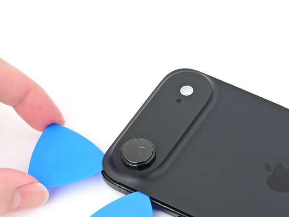

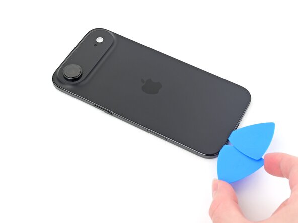

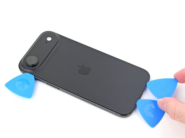

  8. iPhone Air Back Glass Replacement, Separate the bottom edge adhesive: crwdns2935265:08crwdnd2935265:01crwdnd2935265:03crwdne2935265:0 iPhone Air Back Glass Replacement, Separate the bottom edge adhesive: crwdns2935265:08crwdnd2935265:02crwdnd2935265:03crwdne2935265:0 iPhone Air Back Glass Replacement, Separate the bottom edge adhesive: crwdns2935265:08crwdnd2935265:03crwdnd2935265:03crwdne2935265:0
    • Slide your pick back and forth along the bottom edge to separate the adhesive.
    • Leave your pick inserted in the bottom left corner to prevent the adhesive from resealing.

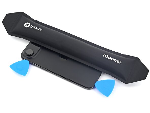

  9. iPhone Air Back Glass Replacement, Heat the left edge: crwdns2935265:09crwdnd2935265:01crwdnd2935265:01crwdne2935265:0
    • Apply a heated iOpener to the left edge of the back glass for two minutes.
    • When using a hair dryer or heat gun, only heat the back glass until it's hot to the touch.

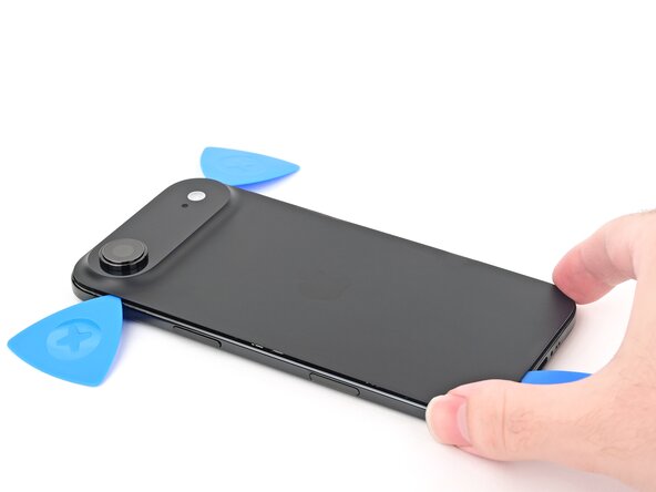

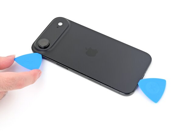

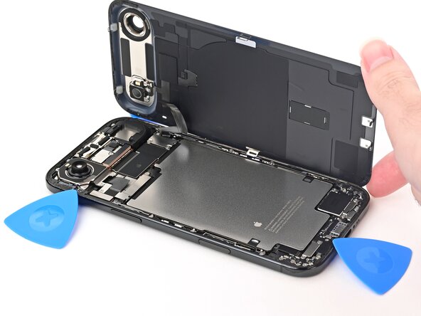

  10. iPhone Air Back Glass Replacement, Separate the left edge adhesive: crwdns2935265:010crwdnd2935265:01crwdnd2935265:03crwdne2935265:0 iPhone Air Back Glass Replacement, Separate the left edge adhesive: crwdns2935265:010crwdnd2935265:02crwdnd2935265:03crwdne2935265:0 iPhone Air Back Glass Replacement, Separate the left edge adhesive: crwdns2935265:010crwdnd2935265:03crwdnd2935265:03crwdne2935265:0
    • Insert a second opening pick to the left of the original.
    • Slide the second pick around the bottom left corner and along the left edge of the back glass to separate the adhesive and release the metal clip.
    • Leave this pick inserted at the top left corner to prevent the adhesive from resealing.

  12. iPhone Air Back Glass Replacement, Separate the right edge adhesive: crwdns2935265:012crwdnd2935265:01crwdnd2935265:03crwdne2935265:0 iPhone Air Back Glass Replacement, Separate the right edge adhesive: crwdns2935265:012crwdnd2935265:02crwdnd2935265:03crwdne2935265:0 iPhone Air Back Glass Replacement, Separate the right edge adhesive: crwdns2935265:012crwdnd2935265:03crwdnd2935265:03crwdne2935265:0
    • Don't insert your pick deeper than 3 mm along the right edge to avoid damaging the ribbon cable.
    • Insert a third opening pick to the right of the original at the bottom edge.
    • Slide this pick around the bottom right corner and along the right edge of the back glass to separate the adhesive and release the metal clip.
    • Leave this pick inserted at the top right corner to prevent the adhesive from resealing.

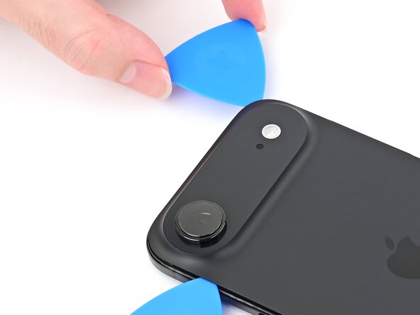

  13. iPhone Air Back Glass Replacement, Separate the top edge adhesive: crwdns2935265:013crwdnd2935265:01crwdnd2935265:03crwdne2935265:0 iPhone Air Back Glass Replacement, Separate the top edge adhesive: crwdns2935265:013crwdnd2935265:02crwdnd2935265:03crwdne2935265:0 iPhone Air Back Glass Replacement, Separate the top edge adhesive: crwdns2935265:013crwdnd2935265:03crwdnd2935265:03crwdne2935265:0
    • Don't insert your pick deeper than 3 mm along the top edge to avoid damaging the spring contacts.
    • Repeat the heating and sliding process along the top edge of the back glass to separate the adhesive and release the metal clips.

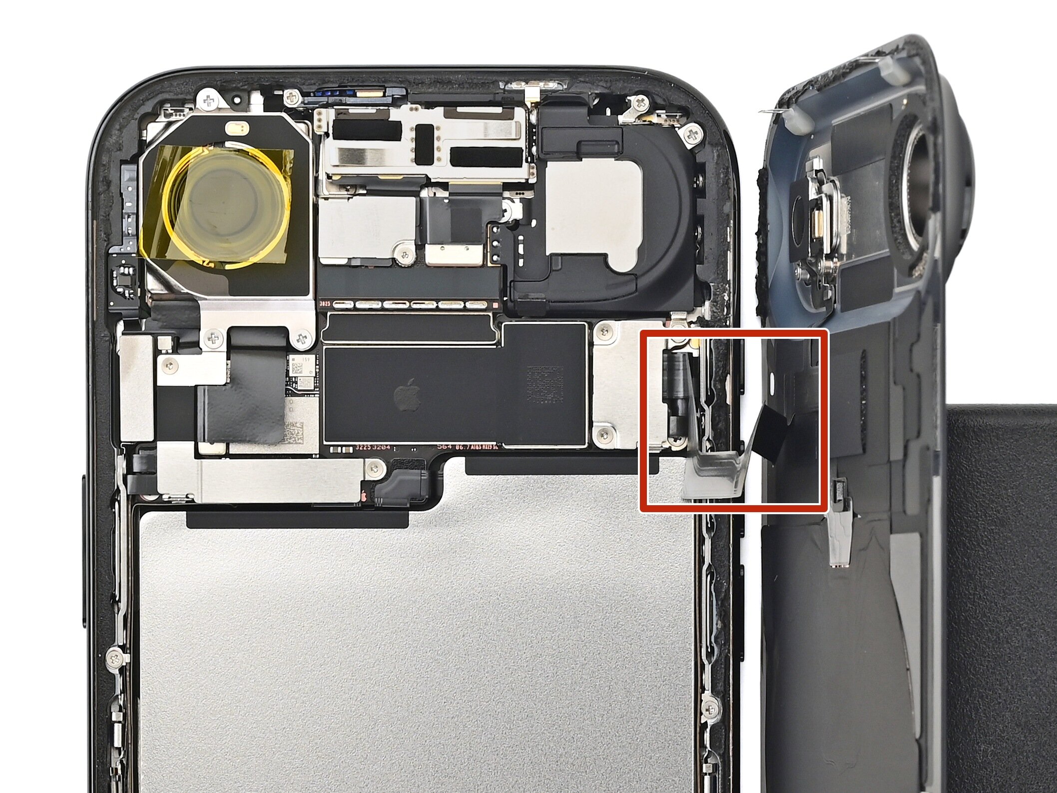

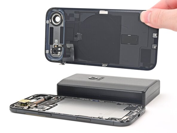

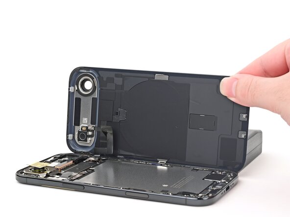

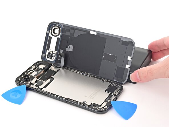

  14. iPhone Air Back Glass Replacement, Swing open the back glass: crwdns2935265:014crwdnd2935265:01crwdnd2935265:03crwdne2935265:0 iPhone Air Back Glass Replacement, Swing open the back glass: crwdns2935265:014crwdnd2935265:02crwdnd2935265:03crwdne2935265:0 iPhone Air Back Glass Replacement, Swing open the back glass: crwdns2935265:014crwdnd2935265:03crwdnd2935265:03crwdne2935265:0
    • Don't try to fully remove the back glass just yet—it's still attached with a delicate ribbon cable.
    • If the back glass doesn't swing open easily, don't force it—go back around the perimeter with your pick to separate missed sections of adhesive or stuck clips.
    • Gently lift the back glass and swing it open towards the volume buttons.
    • Support the back glass with a clean, sturdy object like a small box to avoid straining the cable.

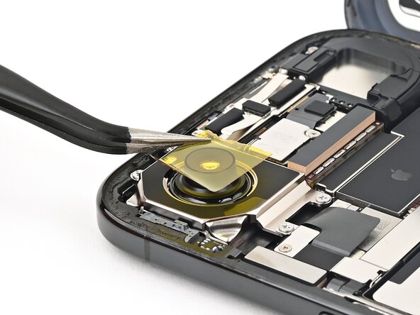

  15. iPhone Air Back Glass Replacement, Protect the rear camera: crwdns2935265:015crwdnd2935265:01crwdnd2935265:01crwdne2935265:0
    • We recommend using polyimide (aka kapton) tape to keep the camera lens clean. If you don't have any, you may skip this step, but be extra careful not to touch the camera.
    • Set a piece of polyimide tape over the rear camera lens.
    • Don't press down on the rear camera.
    • During reassembly, carefully remove the tape without jostling the rear camera—its stabilizing mechanism is extremely fragile.

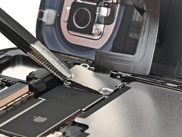

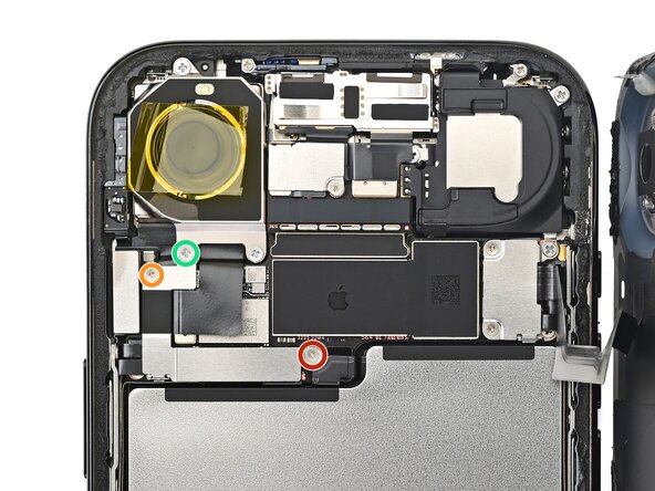

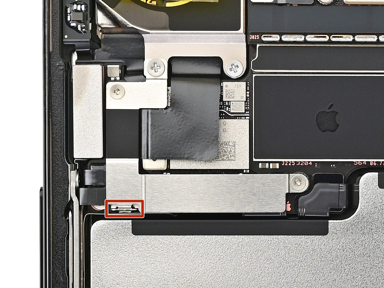

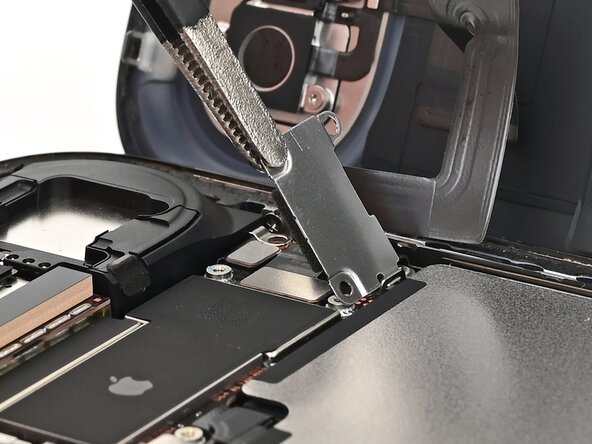

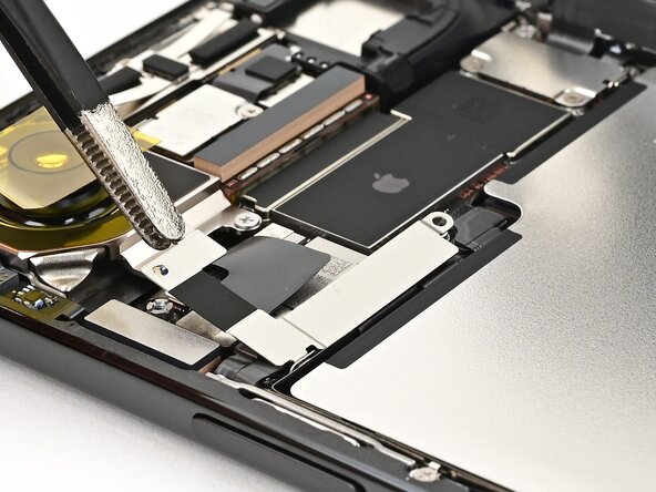

  16. iPhone Air Back Glass Replacement, Remove the left connector cover: crwdns2935265:016crwdnd2935265:01crwdnd2935265:02crwdne2935265:0 iPhone Air Back Glass Replacement, Remove the left connector cover: crwdns2935265:016crwdnd2935265:02crwdnd2935265:02crwdne2935265:0
    • Remove the three screws securing the left connector cover, located below the rear camera:
    • One 1.1 mm-long tri-point Y000 screw
    • One 1.0 mm-long tri-point Y000 screw
    • One 3.2 mm-long JIS 00 screw
    • Small iFixit Phillips bits are designed to work with JIS screws, so you can use an iFixit PH 00 driver. You can try Phillips drivers from other manufacturers, but you risk stripping the screw.

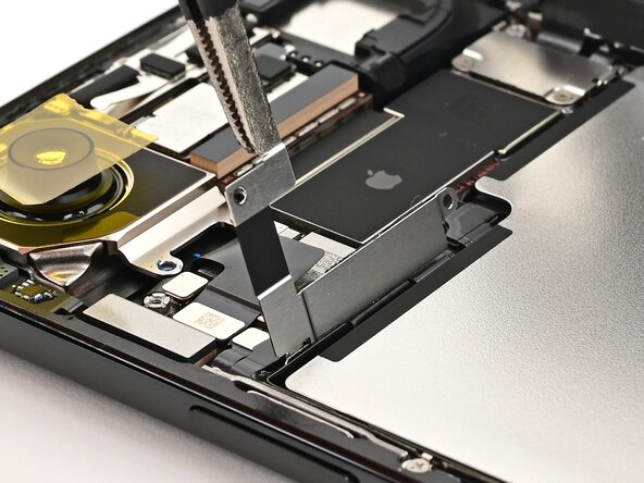

  17. iPhone Air Back Glass Replacement: crwdns2935265:017crwdnd2935265:01crwdnd2935265:03crwdne2935265:0 iPhone Air Back Glass Replacement: crwdns2935265:017crwdnd2935265:02crwdnd2935265:03crwdne2935265:0 iPhone Air Back Glass Replacement: crwdns2935265:017crwdnd2935265:03crwdnd2935265:03crwdne2935265:0
    • Use tweezers or your fingers to lift the cover to release its hook and remove it.
    • During reassembly, insert the cover's hook into its slot on the logic board at an angle, then lay the cover flat.

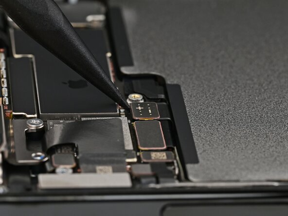

  18. iPhone Air Back Glass Replacement, Disconnect the battery: crwdns2935265:018crwdnd2935265:01crwdnd2935265:02crwdne2935265:0 iPhone Air Back Glass Replacement, Disconnect the battery: crwdns2935265:018crwdnd2935265:02crwdnd2935265:02crwdne2935265:0
    • Use the point of a spudger to pry up and disconnect the battery press connector.
    • During reassembly, align the connector carefully over its socket and press down with your fingertip or the flat end of a spudger—first on one side, then the other—until it clicks into place. Don't try to force the connector into place. If you're having trouble, reposition it and try again.

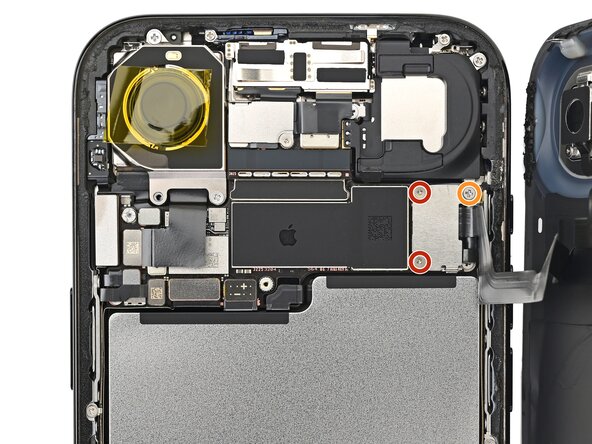

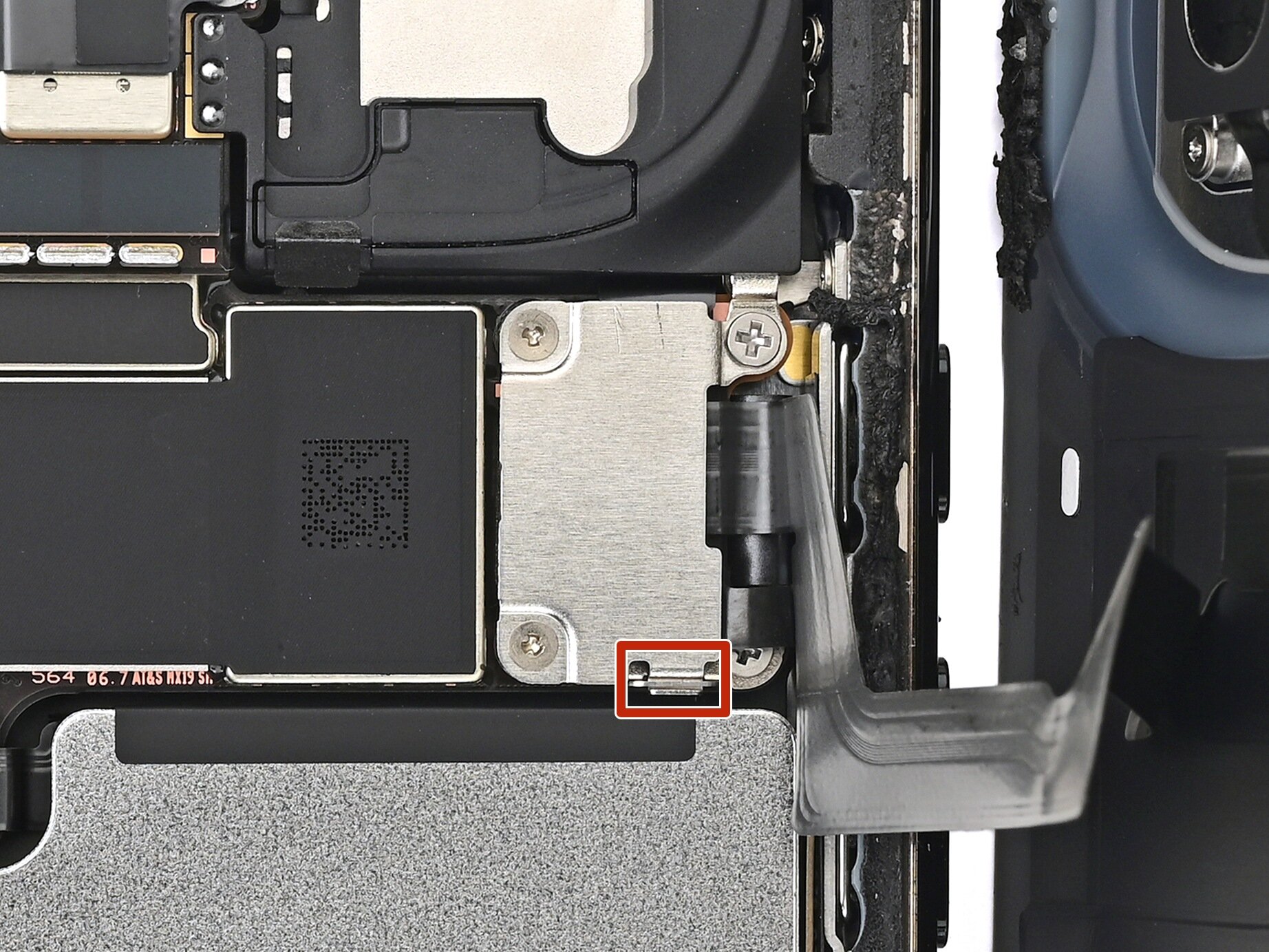

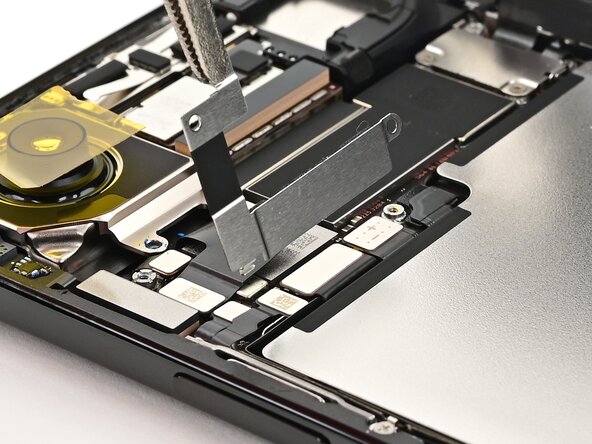

  19. iPhone Air Back Glass Replacement, Remove the right connector cover: crwdns2935265:019crwdnd2935265:01crwdnd2935265:02crwdne2935265:0 iPhone Air Back Glass Replacement, Remove the right connector cover: crwdns2935265:019crwdnd2935265:02crwdnd2935265:02crwdne2935265:0
    • Remove the three screws securing the right connector cover:
    • Two 1.1 mm-long tri-point Y000 screws
    • One 2.8 mm-long JIS 00 screw

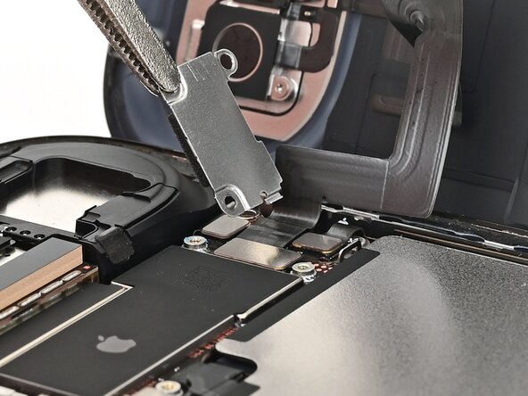

  20. iPhone Air Back Glass Replacement: crwdns2935265:020crwdnd2935265:01crwdnd2935265:03crwdne2935265:0 iPhone Air Back Glass Replacement: crwdns2935265:020crwdnd2935265:02crwdnd2935265:03crwdne2935265:0 iPhone Air Back Glass Replacement: crwdns2935265:020crwdnd2935265:03crwdnd2935265:03crwdne2935265:0

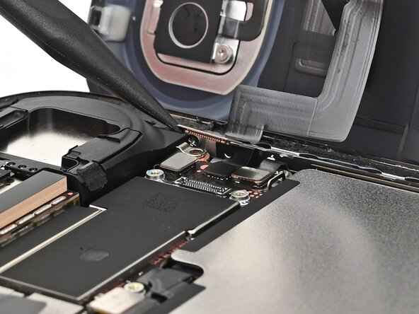

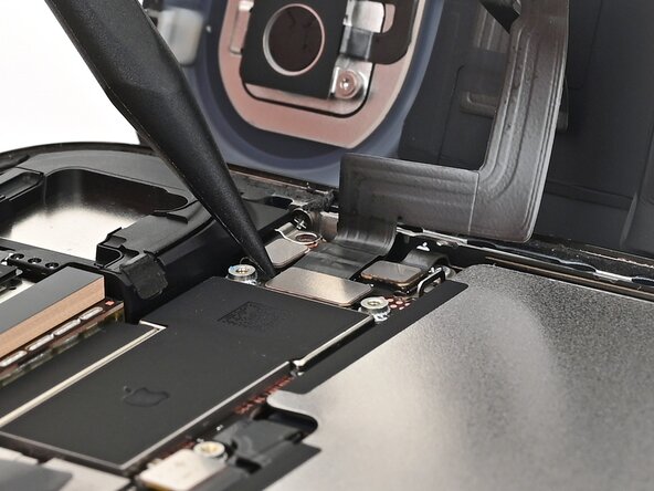

  21. iPhone Air Back Glass Replacement, Disconnect the back glass: crwdns2935265:021crwdnd2935265:01crwdnd2935265:02crwdne2935265:0 iPhone Air Back Glass Replacement, Disconnect the back glass: crwdns2935265:021crwdnd2935265:02crwdnd2935265:02crwdne2935265:0
    • Use the point of a spudger to pry up and disconnect the flash and wireless charging coil press connector.
