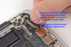

I took out the LB (820-2915) from my MBP 15" late-2011 HiRes-glossy display and placed in a LB (820-3330) from a MBP 15" mid-2012.
Took a nail file to remove some plastic, both sides, of the LVDS connector.
Watch out when you lift the plug for the audio cables, I lifted it with the connector and so the connector broke-off the old LB.
Good luck!
(If you also exchange the BT/AirPortCard [BT2.0, ...4AX to BT4.0 ...CAX] you may enjoy a genuine mid-2012 MBP that shall be Mojave compatible!)
BTW: I think it is totally not-needed to -take out- the battery as suggested by the iFixit guide (still should de-connect AND drain all power by pressing the start button once the battery is de-connected . Spares you buying a Tri-wing 0.
All you need to do if carefully file the edge of the fiberglass tang with a fine nail emory board two or three strokes on each side its so little that needs to be knocked off.

@marcel151 -The system I'm banging on right now is a 2011 system which I replaced the logic board with a 2012. There is a slight alteration needed on the LVDS cable otherwise no issues with either gloss or matte displays.
I don‘t know why you mentioned me, I already did the swap over a year ago with my 2011 15“. Works flawlessly until today. I didn‘t use a nail file. I just carefully put the connector in.
@marcel151 - The fiberglass tang can breakdown if forced! Best to file it so it slides in smoothly without any friction.
@danj I think you meant for this ANSWER to be directed towards F R (https://www.ifixit.com/User/3848828/F+R) and not @marcel151
@danj That was the case with mine. No force at all.
@marcel151 - Did you have the LVDS cable (display) replaced at some point? You would have gotten the newer narrower cable at that point the color of the connector and the cable end (gold or silver) is a good clue.
