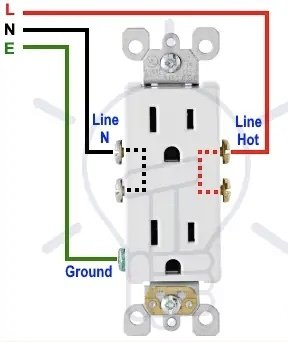

Let’s focus in to the simple stuff often forgotten! When we have two or more devices plugged into power (AC) we can unintentionally create a hot ground condition if the plug of the device doesn’t offer a ground pathway via the third pin and/or the outlet/s used are not correctly wired or even offer a ground connection either at the outlet or at the breaker panel.
Going to a local hardware shop you should be able to grab a simple plug-in tester to check your outlets are correctly wired. You will still need a DVM to check the voltage at the Neutral and Ground points of the outlet to see if voltage is present as well.
The left blade side in this image is the Neutral
The cable/adapter could just be burning out due to the hot ground. This can also be caused by using different fed outlets which are using different phases of the service at the breaker between your system and monitor. To add to this it’s not only your computer gear it could be other devices in your home that sporadically run as the motor winding are bad.
Thanks for the info. I'll look into a DVM and the idea of bad power. However in the last 7 years - when this problem has been occurring - I've lived in 5 different places in 3 states before I bought my current house, so its not a specific plug or circuit. But I've always had both computer and monitor plugged into the same surge protector power strip.
@mph18008 - Well using a shared outlet removes the two from the issue, sadly it could be something else in your home. What items did you move with from the first occurrence? To be clear this is doesn’t mean there isn’t something else a miss here. I would still make the effort checking the outlets, all it takes one the Hot and Neutral flipped wire in one outlet to mess you up.
Thanks Dan. I've used this same Belkin surge protector power strip for years - https://www.belkin.com/p/conserve-switch... - not a UPS, but not the cheapest either. Since dozens of others report the same issue, I suspect its a mfg. defect/something Apple should have made easily replaceable. If someone can help me fix my monitor, I'll take a closer look at the plug.
@mph18008 - I’m confused, I wasn’t focusing on the outlet (surge strip here). The wiring of one outlet within your home could be the cause. That’s why you need the outlet checker to check them. What can make this maddening is the device plugged into this oddly wired outlet) would leak to the Ground circuit.
