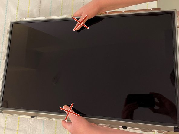

    3. Apple LED Cinema Display 27" LED Panel Replacement: crwdns2935265:03crwdnd2935265:01crwdnd2935265:03crwdne2935265:0 Apple LED Cinema Display 27" LED Panel Replacement: crwdns2935265:03crwdnd2935265:02crwdnd2935265:03crwdne2935265:0 Apple LED Cinema Display 27" LED Panel Replacement: crwdns2935265:03crwdnd2935265:03crwdnd2935265:03crwdne2935265:0
      • First Steps Remove the glass panel as shown on step 2.
      • Upon disassembly, handle the LED panel only from the metal railings on either side and avoid touching the panel as much as possible.
      • Do not press on the front surface of the LED panel when handling, as this could cause the pixels from the panel to malfunction and/or stop working.

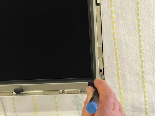

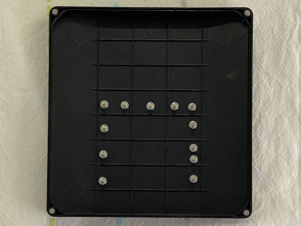

    4. Apple LED Cinema Display 27" LED Panel Replacement: crwdns2935265:04crwdnd2935265:01crwdnd2935265:03crwdne2935265:0 Apple LED Cinema Display 27" LED Panel Replacement: crwdns2935265:04crwdnd2935265:02crwdnd2935265:03crwdne2935265:0 Apple LED Cinema Display 27" LED Panel Replacement: crwdns2935265:04crwdnd2935265:03crwdnd2935265:03crwdne2935265:0
      • Remove the twelve, 10 mm Torx T10 screws around the border of the display frame.
      • Be sure not to overtighten the LED screws during reassembly, as it could cause light leakage after the unit is reassembled.

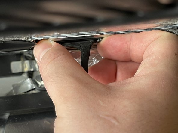

      • Use the black tabs to raise the bottom edge of the LCD a few inches to access the cables inside.
      • Tilt the display up no more than 4 inches (10 cm). Pulling the display too far could damage the cables or connectors.

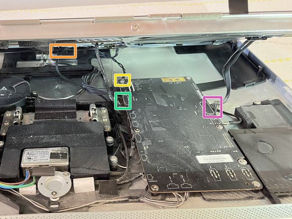

    6. Apple LED Cinema Display 27" LED Panel Replacement: crwdns2935265:06crwdnd2935265:01crwdnd2935265:02crwdne2935265:0 Apple LED Cinema Display 27" LED Panel Replacement: crwdns2935265:06crwdnd2935265:02crwdnd2935265:02crwdne2935265:0
      • Avoid coming in close contact or touching any components of the Power Supply.
      • Looking into the gap under the LCD, disconnect four (4) cables:
      • DisplayPort
      • Function
      • Ground pin
      • LED backlight driver
      • Verify that all cables are firmly seated into connectors during reassembly. An insecure cable connection can cause image flicker.

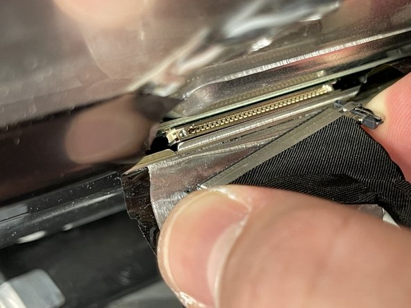

    7. Apple LED Cinema Display 27" LED Panel Replacement: crwdns2935265:07crwdnd2935265:01crwdnd2935265:03crwdne2935265:0 Apple LED Cinema Display 27" LED Panel Replacement: crwdns2935265:07crwdnd2935265:02crwdnd2935265:03crwdne2935265:0 Apple LED Cinema Display 27" LED Panel Replacement: crwdns2935265:07crwdnd2935265:03crwdnd2935265:03crwdne2935265:0
      • Peel back the mylar and foil tape on the DisplayPort cable on the back of the LED panel.
      • Squeeze the sides of connector and pull it out.
      • Make sure the 24 pin cable is correctly aligned with the LED panel upon reassembly.

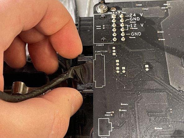

    8. Apple LED Cinema Display 27" LED Panel Replacement: crwdns2935265:08crwdnd2935265:01crwdnd2935265:03crwdne2935265:0 Apple LED Cinema Display 27" LED Panel Replacement: crwdns2935265:08crwdnd2935265:02crwdnd2935265:03crwdne2935265:0 Apple LED Cinema Display 27" LED Panel Replacement: crwdns2935265:08crwdnd2935265:03crwdnd2935265:03crwdne2935265:0
      • Squeeze the sides of the function cable connector on the top left edge of the logic board and pull it straight out.
      • Make sure to align the function cable correctly with the logic board during reassembly.

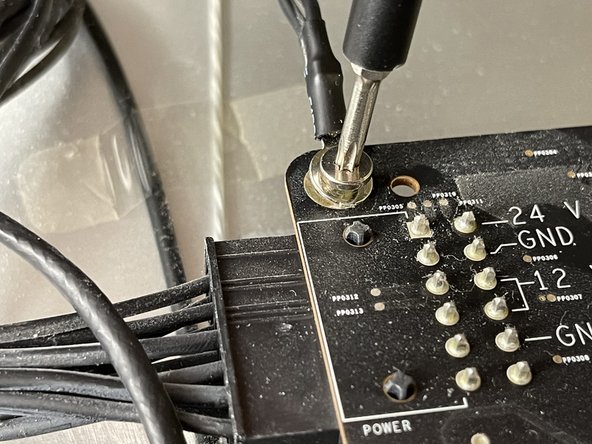

    9. Apple LED Cinema Display 27" LED Panel Replacement: crwdns2935265:09crwdnd2935265:01crwdnd2935265:02crwdne2935265:0 Apple LED Cinema Display 27" LED Panel Replacement: crwdns2935265:09crwdnd2935265:02crwdnd2935265:02crwdne2935265:0
      • Close-up of the ground cable at top left of logic board. Remove the 10 mm Torx T10 screw from top left corner of logic board.
      • Disconnect the ground cable.
      • Avoid touching the double pins on the top left corner of the logic board with a screwdriver.

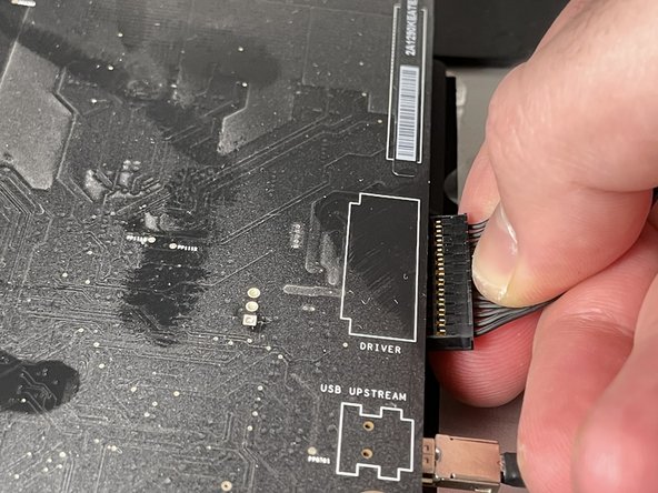

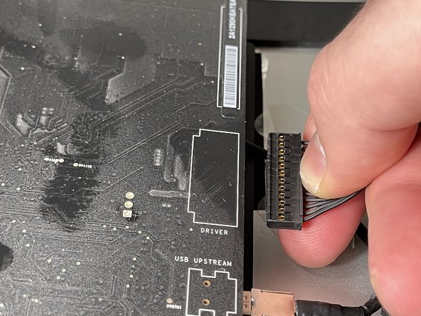

    10. Apple LED Cinema Display 27" LED Panel Replacement: crwdns2935265:010crwdnd2935265:01crwdnd2935265:03crwdne2935265:0 Apple LED Cinema Display 27" LED Panel Replacement: crwdns2935265:010crwdnd2935265:02crwdnd2935265:03crwdne2935265:0 Apple LED Cinema Display 27" LED Panel Replacement: crwdns2935265:010crwdnd2935265:03crwdnd2935265:03crwdne2935265:0
      • Pinch the LED backlight driver cable on the underside of the center right edge of the logic board and pull straight out.
      • Avoid putting force on the logic board to bend as deformation of a logic board can cause issues.

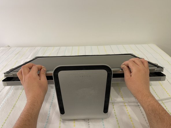

    11. Apple LED Cinema Display 27" LED Panel Replacement: crwdns2935265:011crwdnd2935265:01crwdnd2935265:03crwdne2935265:0 Apple LED Cinema Display 27" LED Panel Replacement: crwdns2935265:011crwdnd2935265:02crwdnd2935265:03crwdne2935265:0 Apple LED Cinema Display 27" LED Panel Replacement: crwdns2935265:011crwdnd2935265:03crwdnd2935265:03crwdne2935265:0
      • Handle the LCD panel by the edges and lift it upwards until it separates from the rest of the enclosure.
      • This guide can be followed in reserve in order to perform an installation and reassembly of the LED panel to the rest of the enclosure.
