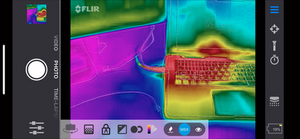

This is way late, but the heat thing resultant from the repeatedly stressed connection seems to be the issue. a.k.a. "Bad Design" See FLIR pic:
https://ibb.co/h24jY7B
The connection is the hottest thing around by 20 degrees (case next to the connection is only 98˚)
Yes, the MacBook Pro you have in your FLIR photo is running on the hotter side of things.
But I don't see the Thunderbolt connection as the cause but the CPU & graphics logic with is very close to this side of the system.
