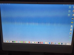

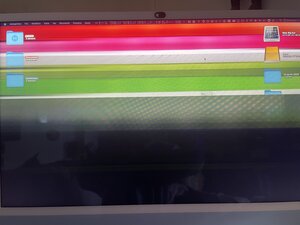

Horizontal lines over iMac 24 screen
Hi,
I got horizontal lines over the display! During the warranty period they replaced the board ( it blacked out ) and now this is happening. They refused to replace the device saying out of warranty and asked to replace it :-|. They were not even sure that changing the display will fix the issue. I am hesitant to replace the screen as I am better off to buy a new one rather keep repairing the faulty product.
Is there any way to fix it?
Tried
- Reinstall the OS
- External Display = Works fine
- Reseating those 3 cables
Lines kind of flickers, may be some lose cables?
Please help

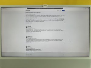

@latv Saw ur replies to me in mail but were disappeared from discussion. Hence, it was never seen. Learned new things as well. I guess apple removed yours as well my comments. Can you msg me on telegram: bitlittlebit
According to Apple, it's an LCD malfunction.
So I took my iMac to a technician.
The problem, apparently, lies in a cable that also powers the LCD, which is located on one of the tops of the screen, and which, to be replaced, requires detaching the screen glass from the LCD itself, which is a very sensitive operation. So the only option is to replace the entire LCD.
This cable (of the FFC/FPC type), has to sustain a very high voltage (around 50V) to power the LCD (despite the iMac's power supply being 15.9V), and it heats up a lot!
What happens is that it starts to degrade at the connector, to the point where it lets the signals leak between the various connectors and short-circuits some of them, which ends up causing those lines.
The level of brightness makes a fundamental contribution to this problem. The higher the brightness used, the sooner the problem occurs.
At its lowest brightness, temperature at the top of the screen it's normal; when it's at its highest, you can fry an egg!

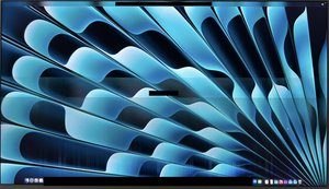

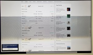

According to the Apple support team I contacted, it's an LCD malfunction and the only solution is to replace it.
What they didn't say was why this problem is occurring after two years of using the iMac on so many computers.
So, as Apple hasn't yet assumed that it's their fault, what I did, given the lack of concrete answers from Apple, was to take my iMac to a technician and ask him to assess the problem to see if it's a construction problem or just a random fault.
The explanation I was given was as follows:
In terms of circuitry, everything seems to be working properly.
The problem, apparently, lies in a cable that also powers the LCD, which is located on one of the tops of the screen, and which, to be replaced, requires detaching the screen glass from the LCD itself, which is a very sensitive operation and almost impossible to carry out without damaging the LCD.
So the only option is to replace the entire LCD (LCD+main boards+screen glass).
Also, according to the technician's explanation, this cable (of the FFC/FPC type or Flat Flexible Cable / Flexible Printed Circuit), has to sustain a very high voltage (around 50V) to power the LCD (despite the iMac's power supply being 15.9V), and it heats up a lot!
So, what happens after a while (in this case after about 2 years) is that it starts to burn out and degrade at the connector, to the point where it lets the signals leak between the various connectors and short-circuits some of them, which ends up causing those lines that we are all unfortunately familiar with.
The level of brightness makes a fundamental contribution to this problem. Thus, the higher the brightness used, the sooner the problem occurs.
This is easily understood by measuring the difference in temperature at the top of the screen when it is at its lowest brightness level, compared to when it is at its highest. It's quite a big difference!
When it's at its lowest brightness, it's practically room temperature; when it's at its highest, you can almost fry an egg!

Persistent horizontal lines on iMac M1 LCD screen
I am reaching out to share an ongoing issue I, along with several other users (> 120), have been experiencing with our iMac 24-inch models, and to seek a collective resolution by Apple.
Problem Description:
  • Persistent horizontal lines appear on the screen, which significantly hampers the usability and visual appeal of the device.
  • This problem arises without any physical damage, and despite the stationary nature of the device.
Steps Taken:
  • Connected to an external display: The external display works fine, indicating the issue is with the iMac's internal display.
  • Reinstalled the OS: The problem persisted after reinstallation.
  • Avoided operating the iMac for a week: No change in the situation.
  • The LCD main cables have been tested: The situation was OK.
  • The LCD mainboards have been tested: The situation was OK.
  • Various brightness levels were tested over long periods: The lines decrease in the affected area in direct relation to the brightness of the screen - less brightness, fewer lines; more brightness, more lines.

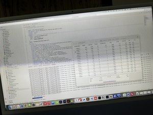

Hello Lat V, I'm having definitely the same problem with you. As I find your post here, I wonder if it is a Quality control issue cuz I bought this iMac in August 2021.
crwdns2944067:011crwdne2944067:0:
@yijunlin Yeah Exactly!! I have the same hexagon burning like you. Thing is it will get worse, the portion will get filled up with full lines after few weeks. Apple will deny mistake from their side, it would cost you around 650USD to replace the screen. I plan to buy new one instead of repairing it, they say, they will bill be for further repairs after replacing the display unit, feels scammed. If you need my support any way to act as proof, happy to do so.

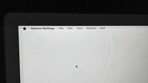

Hey just wanted to know if there’s any update on this, I found that I have the same problem too, on a 2 year old iMac 24” M1. It keeps coming in and out, every now and then and then it seems to be fine, except for a very faint horizontal line. Did anything work for anybody in here?
In Taiwan, several cases appeared same problem after using iMac for 2 yrs.https://youtu.be/KIuC22KkREE
I just got exactly the same problem on my M1 IMac which I bought mid 2021 in Singapore. Maybe there are some manufacturing issues with a batch of these iMacs. Such displays should not fail within such short time.

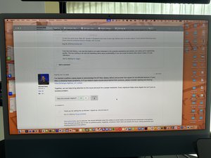

I've started a petition urging Apple to acknowledge the M1 iMac display defect and provide free repairs for all affected devices. If your iMac is showing these symptoms, or if you believe Apple should stand behind their products, please consider signing and sharing: https://change.org/imac_m1_screen
Together, we can help bring attention to this issue and push for a proper resolution. Every signature helps show Apple this isn't just an isolated problem.
Thank you for setting this up Michael. I signed up. Lets all share it!
@pouyairanitalab, you're welcome. We should definitely share this widely on social media, as several forums mentioned in the petition have removed my posts due to their no-petitions policy. Hopefully, someone in tech news can amplify this issue, raising awareness and drawing attention to the petition.

I had the exact same issue, Apple refused to repair it for free, so I ended up buying a new IMac I found at a very discounted price (other computers are worse, so I couldn't find an alternative). They recommended that I take out their AppleCare+ insurance, and I did, but it is anything but clear that this insurance would have covered the issue I had with my old IMac.
I from Singapore. I own previous intel iMac , it does justify as been an Apple user. Last for me quite long than eventually some minor hardware fault. That is OK since already use well over 3 years and more next also due to Computer hardware degrade as years gone by. So happen upgrade to M3 iMac , bought on Feb 2024. While I typing here now is Oct 2025. Just only use for one year plus have't reach two years suddenly noticed lines appear at the bottom of the screen. At first just static black lines now i noticed some lines start flicking in between white and black. I don't know how long I can use it.... as now I still can use just drag the browser, apps etc up a bit.
At first , I thought maybe software glitch so I do restart, even do reset , safe boot, etc still the lines are there so I go online check around to my shock. M1 users already feedback this Line issue way back. Yet I using M3 iMac! This means Apple never take any action previously and just continue doing the same on their latest M series iMac.
To figure this out you need an external display. Does the effect show up on it? If it does the logic board will need replacement, if the image is clean that proves the display is bad.
When did you buy the system? If you know what is your countries warranty period as well.
Where do you live? Country and nearest major city. Also do you have access to an Apple Store as clearly this provider failed you.
crwdns2944067:09crwdne2944067:0:
Hi, thank you, External Display => Works fine. I feel it's due to M1 chip, may be I have to apply the thermal paste? The thing is, lines are not fixed, it moves up and down. I am also noticing that it's getting better but very slowly. Some of the top lines are gone.
I live in India, southern side. Apple does not have proper support in here, most of them are third party, they mostly just replace parts. It's an authorized one. Warranty is over, Apple instead of providing a replacement sticks to dump warranty of 1 year. Just in two years I had to replace the entire board and the now this display. Now were near apple standards.
@latv - Not good😢
Sadly, repasting won’t fix this. The M1 chip is not the problem!
If the external display is fine that points to a bad internal display. You need a new display.
Thank you, looks like I am stuck with it, apple won't even replace the product. The service guys said they are not sure if it's a display problem, they said they will invoice it after replacing the display. If that's the case I am better of buying a new one. The invoice that I have now is almost the half. That's Apple.
This GPU drives the external display? Which makes the problem being the faulty display unit?
@latv - Correct, one graphics engine which pushes the video output to both displays. This is a simple test! While a pain maybe you need to educate him. Bring the system and the external and have him see this.
I swear you’ve proven it! There is no other cause here. Something is messed up with the display it’s self.

I am having the same problem. I've had this iMac less than two years. These lines appeared a couple weeks ago and have shifted a bit but haven't disappeared. From what I'm seeing online, we are not the only ones experiencing this. This is not right. Apple should be held accountable for this issue.
crwdns2944067:017crwdne2944067:0:
@jen79010 Yeah, really making all us run with repairs. Mine has gotten much worse, since posting this.
Having same issue after 2.6 years of using my IMAC M1 24". I leave in Mumbai, India. Took it to Apple store. They charged 2500 INR for checkup and gave 54000 INR quotation to replace new screen. Local service centers charging around 45000
Have anyone notice the top right corner of screen feel very hot when touched. I strongly feel its over heating issue or Flex cable problem. I would have opened and checked it myself but I dont have tools to open the iMAC and assemble it back.
Yes issue for me. Don't open the iMac, it's a display issue. The heating is happening at the connector. Do this instead, don't open, apple maintains a monopoly in repair business for apple products in India, no spare parts is available.
Heating is going to happen at multiple points and the lines are going to show up 3 positions. It will shift.
File a consumer case with proof of screenshot from others. Use an external display until case the solved.

I've got the same issue. iMac 24'' bought in Singapore less than 3 years ago. Bottom part of screen (about 1 inch) started flickering today. I have tried the solutions found in Google, with no avail.

Just Today , my M3 iMac suddenly have these lines appear at the bottom of the screen! I from Singapore. I notice some also from Singapore go Apple store also can't be help....
This is really..... so those affected one , how any updates? You all just continue use it since no choice no worth to repair. I know some claim use 2nd monitor.
It is disappointing to hear that an m3 iMac is also experiencing this issue. I have read about over 700 cases where unique individuals have clicked the "me too" button for people having this exact issue on the m1 iMacs (like mine).
Apple delivers poor quality and leaves customers alone to deal with the problem.
Your post is very important. The issue isn’t limited to the M1 model — this is simply the first report of it affecting an M3. Looking at the sales timeline, failures tend to appear two to three years after purchase, which matches the M3’s current age.
Apple only began collecting affected devices for analysis after the M3 was already on the market, so it makes sense that only later models might have been corrected.

I've got the same issue with the same symptoms: a 2-year-old M1 iMac bought in Singapore. Reported to Apple via the feedback form and posted in Apple Forums.
Now it started flickering so became very annoying and really unusable.

To be clear this is a bad LCD panel where the metal oxide traces within it have become damaged often do to physical damage to the panel. While most displays front glass will break, often the rear glass encounters micro fractures so the traces get damaged when the hit wasn't hard enough to crack to top glass.
