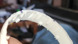

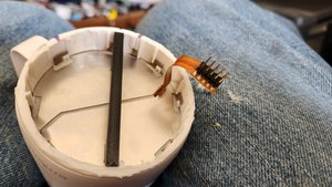

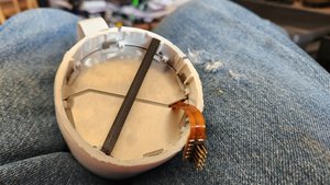

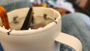

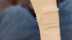

The Ember mug cannot be serviced as there is an anti-tamper locking pin on the metal base lip. The pin could be released by drilling a 2 mm hole at a very acute angle that intercepts the pin. Then pushing the pin out of the way and rotating the bottom section 10 degrees. I have photos 1agkirk2@gmail.com
@alankirk50251 That is something that I was concerned about when doing my teardown; I noted that pin but couldn't be sure of its function due to the head damage to the plastic. If that's the case, they deserve some major negative points for deliberately booby trapping the base so the battery can't be replaced.
@alankirk50251 Can you create an answer to this question and post your pictures? I'm sure we'd all love to see what you found.

About 6 months ago I destructively disassembled a 10oz mug and took photos during the process. I created a 3D Printer STL file for the destroyed portion of the plastic base and will be happy to supply to any interested party. On the 10oz mug there is a locking tab installed to prevent brute force rotation of the plastic base. This anti-tamper tab could be disengaged by drilling a small 2mm hole at an acute 10 degree angle about 30mm clockwise from the right edge of the inverted mug handle, then pushing the tab out of the way. This tab does not appear in 14oz mug photos. I have more photos and the STL file for the mug bottom if anyone is interested. Don't know how put that file into this post.

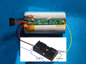

After about a 18 months of use, my Mug 2 stopped holding a charge at all, dying as soon as it was lifted off the base. After contacting support, the best Ember could do was offer to sell me a replacement mug for $99 dollars.
Not wanting to just buy a new mug which would likely face the same fate eventually, I figured I would at least try to repair my mug myself.
Thanks to the tips in this thread, I was able to get my Mug 2 apart using a couple of strap wrenches: one wrench wrapped around the main body of the mug and the other wrapped as best I could around the base. This allowed me to get enough friction and torque to turn the base the 15 degrees that Propeller Head mentioned. I was then able to carefully pry apart the base from the mug without damaging the ribon cable connecting the two pieces.
As others have mentioned, the 18650 batteries in the battery pack can be replaced if you have the tools and expertise/confidence to weld new batteries to the existing, proprietary BMS board.
I don't have a spot welder so what I ended up doing instead was using 2 high capacity/high discharge 14500 batteries ($9) in a AA battery holder ($5) soldered to the old BMS like so:
The BMS seems to handle the 14500 batteries just fine as long as everything is connected correctly.
With the BMS tucked between the bottom board and the battery holder (with some electrical/conformal tape to prevent any shorts), everything fits snugly underneath the shield and the mug can be reassembled using the strap wrenches.
Even with the highest capacity 14500 batteries, this mod does reduce the battery life of the mug by about 20-30% (compared to new 18650 batteries) but does allow you to (somewhat) easily replace the batteries if they ever start to degrade.

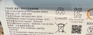

I found this battery, but I can not confirm that is the right one, I haven't opened my mug yet.
https://batteryclerk.com/products/ember-...
SKU CS-EMB200SL
Ember Mug 2 Smart Mug Replacement Battery
INFO
  • This is a replacement compatible with a Ember Smart Mug Battery
  • Volts: 7.4V (7.4 Volts)
  • Capacity: 3500mAh (3.5Ah)
  • Type: Li-ion
  • Color: Blue
  • Ember Mug 2 Replacement Batteries.
  • Mfgr Part # INR18650 MH1-2S1P
  • Dimensions: 2.61 in. L x 1.46 in. W x 0.78 H in.
  • Weight: 0.3 lb
  • Warranty: 1 Year
Disclaimer: Our products are not affiliated with or authorized by Ember.
Nice find, Joseph! The specs look right and visually I can't see any difference in the parts that matter, so I'd say you've managed to locate that elusive snipe we've all been hunting for.
Thanks for posting!

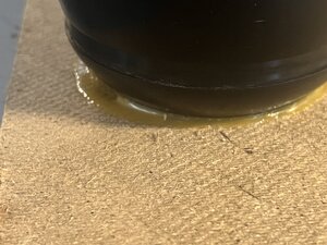

Was able to twist off the cup by removing the rubber bottom, gluing the unit to a compressed board with some wood glue, letting it dry for a couple days, then twisting it off. Note that your instinct will be to twist counterclockwise, but you need to twist clockwise about 10 degrees. The metal post will be there to ensure you don't overtwist.

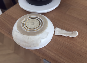

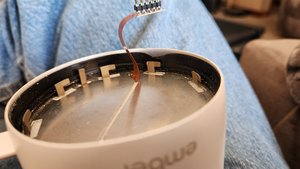

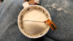

This week my Mug 2 died. The battery was to toast that the cup turned off every time it tried to power the heating element and then came back on again. It works when on the coaster or empty. The battery life have been getting worse for some time (it's close to 4 years old). Since I have already replaced the pins in the charge plate I decided to just try.
Thanks to the notes in this thread it actually went surprisingly well. Placed the cup upside down in a wise and used a glove with rubber grip surface I was able to twist the bottom a few degrees. I pried it with my hands after twisting until a tiny gap formed between plastic and cup - Then inserted a flat tool and gently tapped the plastic part off. No damage to the cup at all.
As mentioned you need to remove the shielding (Held by 3 torx screws) before you can detach the cable. The battery is held by double sided tape and there is no other components on that side of the board. So you can safely use a credit card or similar to cut through it. Took me maybe 10min in all until I had the battery out.

All in all a fairly simple job if you can get a grip of the bottom with a pair of rubber gloves. It only needs to twist a few degrees before it is free.
