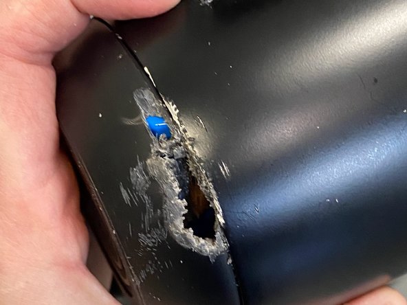

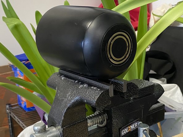

    • This is the worst part. It does not twist off manually- even with a very strong person (not me) trying. Some have claimed they can twist it off. Kudos to them. . . twisting off was absolutely impossible with this mug.
    • I held it in a vice and cut a small hole in the base right where it is attached to the mug using an oscillating saw. This was overkill of a tool but it worked.
    • Do not cut where I did. I cut on the side opposite of the "Ember" logo just lateral to the handle. This was NOT the best option, but I was lucky (see step 2). If I were to do this again, I would cut on the other side of the handle just between the handle and the "r" of "Ember" logo.
    • Wherever you cut, make sure it is shallow and angle up towards the opening of the mug to avoid the circuit board.

    • Be careful to not pull the base too hard as there's a ~1 inch ribbon connector between the base and the mug.
    • Note my terrible choice of where to put the hole- it's right next to the ribbon connector. Again, it would have have been much safer to have gone on the other side of the handle.

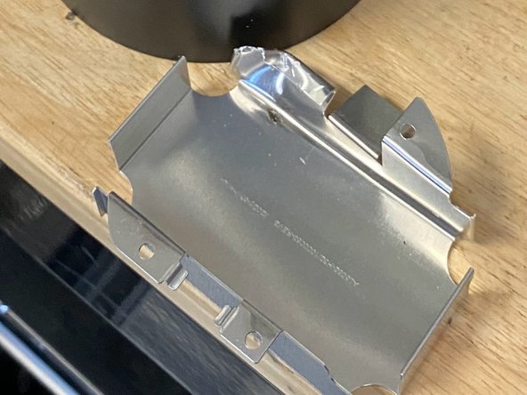

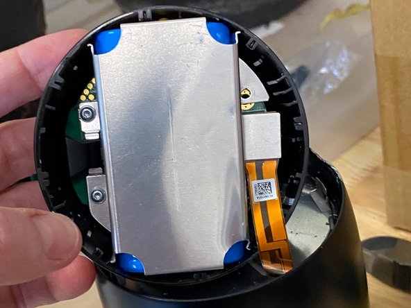

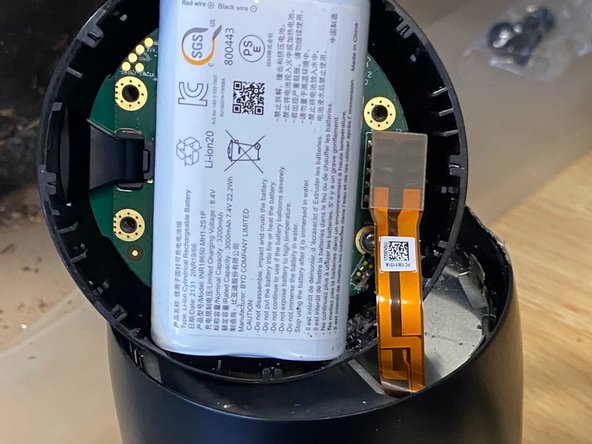

  3. Ember Mug Battery (14 oz model) Replacement, Remove the Battery Cover: crwdns2935265:03crwdnd2935265:01crwdnd2935265:03crwdne2935265:0 Ember Mug Battery (14 oz model) Replacement, Remove the Battery Cover: crwdns2935265:03crwdnd2935265:02crwdnd2935265:03crwdne2935265:0 Ember Mug Battery (14 oz model) Replacement, Remove the Battery Cover: crwdns2935265:03crwdnd2935265:03crwdnd2935265:03crwdne2935265:0
    • Take out the four screws holding the metal battery cover against the base. I used size 6 Torx bit.
    • Note there's a LOT of open room and nothing important on the other side of the battery cover on the side of the "ember" logo. The yellow arrow points to a little black clip that covers the light on the circuit board and lines up with the logo on the mug. The safest spot to cut and brute force open would be on either side of that plastic clip.
    • Circled in pink you can see the direction of the pins that hold the base against the mug and the direction it eventually twists.
    • In the second photo you can see where I mangled the bottom corner of the metal cover where I had cut a hole in the base- I just cut off the mangled part before replacing it.
    • The third photo shows the base after removing the metal cover.

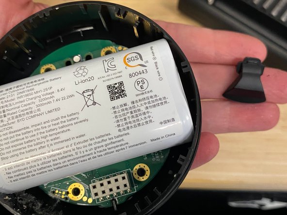

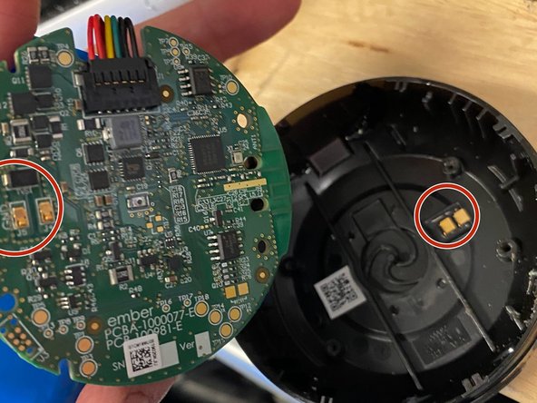

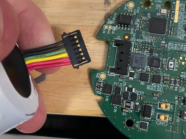

  6. Ember Mug Battery (14 oz model) Replacement, Replace the Battery: crwdns2935265:06crwdnd2935265:01crwdnd2935265:03crwdne2935265:0 Ember Mug Battery (14 oz model) Replacement, Replace the Battery: crwdns2935265:06crwdnd2935265:02crwdnd2935265:03crwdne2935265:0 Ember Mug Battery (14 oz model) Replacement, Replace the Battery: crwdns2935265:06crwdnd2935265:03crwdnd2935265:03crwdne2935265:0
    • Gently pry the old battery off the circuit board. There's a weak adhesive holding it on.
    • The battery plugs in the back of the board. Press the tiny clips on the side of the wire connector to disconnect.
    • Plug in the new battery. The light will cycle through a few colors for a bit when you plug it back in.
    • To put it back on the base, use the two metal charging squares on the base and where they connect to the two little pins on the circuit board as your guide (circled in red in the third photo). (or just pay attention as you take it apart).

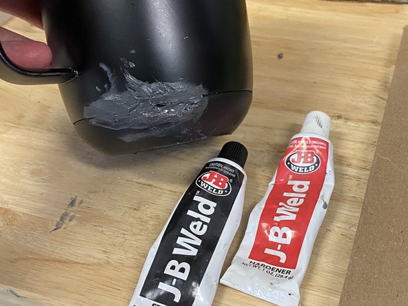

  9. Ember Mug Battery (14 oz model) Replacement, Patch the Hole: crwdns2935265:09crwdnd2935265:01crwdnd2935265:03crwdne2935265:0 Ember Mug Battery (14 oz model) Replacement, Patch the Hole: crwdns2935265:09crwdnd2935265:02crwdnd2935265:03crwdne2935265:0 Ember Mug Battery (14 oz model) Replacement, Patch the Hole: crwdns2935265:09crwdnd2935265:03crwdnd2935265:03crwdne2935265:0
    • I filed down the mangled plastic and then filled the hole with what I had on hand - JB weld. This doesn't touch the contents so doesn't matter that it's not food safe.
    • One person commented this may not be water-tight any more. The seal seems pretty good all around but I would avoid getting it too wet on the outside (better anyway to prevent corrosion on the underside)

I used a small strap wrench- most commonly used for loosening oil filters on vehicles to loosen the base. It turns only about an eight or less of a turn clockwise while the cup is flipped upside down. Then I was able to pry the cup open just using my fingers a little at a time. Mark the cup with a line from the cup through to the bottom once turned with a dry erase or removable mark so you know exactly where to put it back together at. Use the strap wrench to twist it back square with the ember emblem. Thanks!
Isaac - crwdns2934203:0crwdne2934203:0
There have been another thread on this that I'll post here for reference:
How to change the battery in an Ember Mug
In summary YOU DON'T NEED TO MAKE A HOLE to change the battery. Place the cup upside down in a wise and twist the bottom part with either a pair of rubberised garden gloves or use double sided tape to add friction (see the details in the link).
The rest of this guide is perfectly fine to follow for instructions on how to replace the battery.
