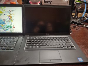

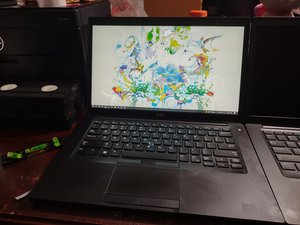

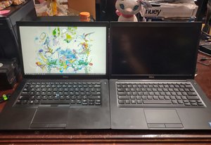

Can you tell the differences? If you can, do they matter?
One is a 7480, other is a 7490.
