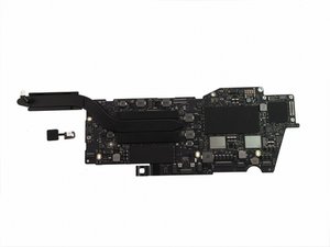

A2338
A2289
*Remember square one is M1 chip, and rectangle one is Intel chip.

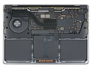

Here’s a good writeup between the Intel and the new M1 based 13” MacBook Pro M1 MacBook Teardowns: Something Old, Something New

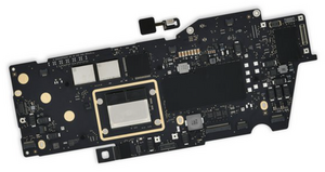

@Kevin Zhang - This is the M1 13” MacBook Pro

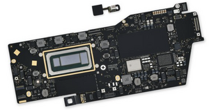

This is the Intel 13” MacBook Pro
Note the shape of the Chips heatsink block the rectangle one is the intel and the square one is the M1

If you inspect the two logic boards (Board 1 and Board 2) for differences in these pictures, you’ll notice that many of the cable connections to the logic board are of a different style or in different locations. This means you cannot swap the boards in these machines.
I am pretty sure that board 2 is not a2289. I think you want take a look of this MacBook Pro 13" (A2289, 2020) 1.4 GHz Logic Board with Paired Touch ID Sensor. Edited: Remember board 2 is a2159 which is not the same with a2289 if two computers are identical.
@Kevin Zhang - The first image is the M1 based MacBook Pro (A2338) system and the second is the Intel based MacBook Pro system (A2289)
@danj Then why MacBook Pro 13" (A2289, 2020) 1.4 GHz Logic Board with Paired Touch ID Sensor has semicircle pinhole on the corner of motherboard while second image does not. When I search for second image, it looks like a2159 motherboard - MacBook Pro 13" (A2159, 2019) 1.4 GHz Logic Board with Paired Touch ID Sensor. I am pretty sure a2289 has all ports similar to a2338 if you look closely enough. It might be wrong if you want to correct me, and I was not sure of software capabilities.
For clarification I pulled the image of Board 1 from Step 15 of this guide MacBook Pro 13" Two Thunderbolt Ports Late 2020 Display Assembly Replacement which claims to be for Model A2338 and I pulled the image for Board 2 from Step 15 of this guide MacBook Pro 13" Two Thunderbolt Ports 2020 Display Assembly Replacement which claims to be for Model A2289.
