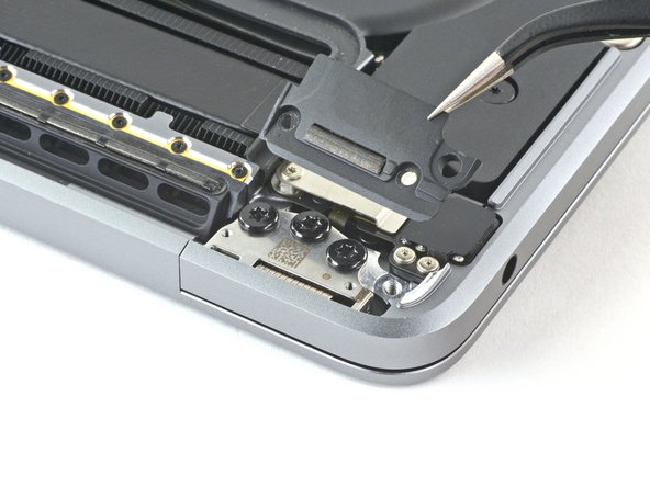

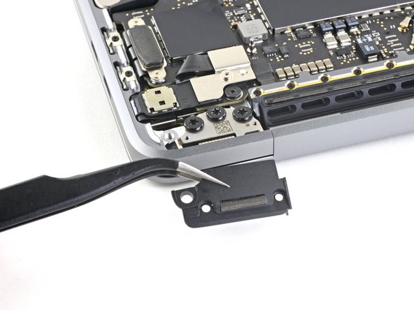

  15. MacBook Pro 13" Two Thunderbolt Ports 2020 Display Assembly Replacement, Remove the antenna cable assembly: crwdns2935265:015crwdnd2935265:01crwdnd2935265:01crwdne2935265:0
    • Remove the four 3.3 mm T3 Torx screws securing the plastic covers on top of the display hinges.
  16. MacBook Pro 13" Two Thunderbolt Ports 2020 Display Assembly Replacement: crwdns2935265:016crwdnd2935265:01crwdnd2935265:03crwdne2935265:0 MacBook Pro 13" Two Thunderbolt Ports 2020 Display Assembly Replacement: crwdns2935265:016crwdnd2935265:02crwdnd2935265:03crwdne2935265:0 MacBook Pro 13" Two Thunderbolt Ports 2020 Display Assembly Replacement: crwdns2935265:016crwdnd2935265:03crwdnd2935265:03crwdne2935265:0
    • Remove both plastic hinge covers.

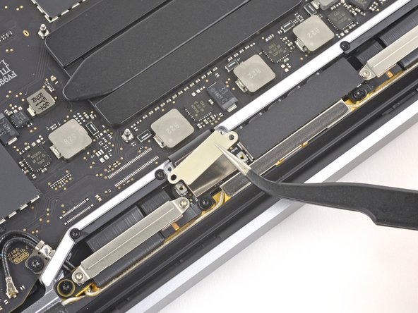

  19. MacBook Pro 13" Two Thunderbolt Ports 2020 Display Assembly Replacement: crwdns2935265:019crwdnd2935265:01crwdnd2935265:02crwdne2935265:0 MacBook Pro 13" Two Thunderbolt Ports 2020 Display Assembly Replacement: crwdns2935265:019crwdnd2935265:02crwdnd2935265:02crwdne2935265:0
    • Pry the display board flex cable straight up from its socket to disconnect it from the display board.

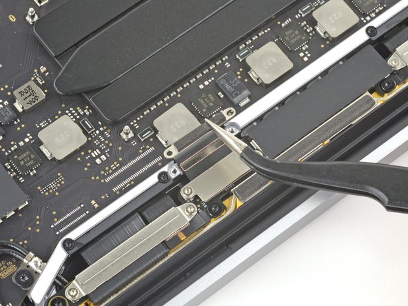

  20. MacBook Pro 13" Two Thunderbolt Ports 2020 Display Assembly Replacement: crwdns2935265:020crwdnd2935265:01crwdnd2935265:03crwdne2935265:0 MacBook Pro 13" Two Thunderbolt Ports 2020 Display Assembly Replacement: crwdns2935265:020crwdnd2935265:02crwdnd2935265:03crwdne2935265:0 MacBook Pro 13" Two Thunderbolt Ports 2020 Display Assembly Replacement: crwdns2935265:020crwdnd2935265:03crwdnd2935265:03crwdne2935265:0
    • Remove the four 1.5 mm T3 Torx screws securing the two aluminum covers on top of the two display cable connectors.
    • Use a pair of tweezers to remove the two aluminum covers.

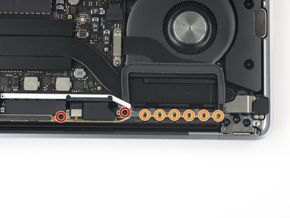

  21. MacBook Pro 13" Two Thunderbolt Ports 2020 Display Assembly Replacement: crwdns2935265:021crwdnd2935265:01crwdnd2935265:02crwdne2935265:0 MacBook Pro 13" Two Thunderbolt Ports 2020 Display Assembly Replacement: crwdns2935265:021crwdnd2935265:02crwdnd2935265:02crwdne2935265:0
    • Remove the four 3.3 mm T5 Torx screws (two on each side) which secure the antenna cable assembly.
    • Also remove the twelve 1.1 mm P2 pentalobe screws (six on each side).
    • These small screws can strip easily, so make sure your P2 pentalobe driver is in good condition before applying pressure.

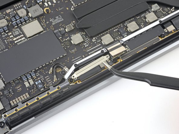

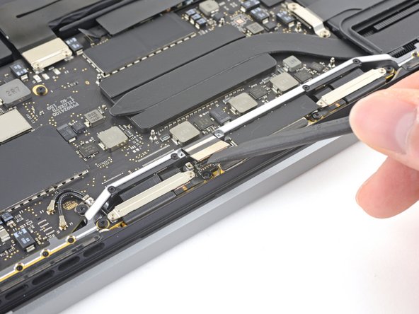

  22. MacBook Pro 13" Two Thunderbolt Ports 2020 Display Assembly Replacement: crwdns2935265:022crwdnd2935265:01crwdnd2935265:02crwdne2935265:0 MacBook Pro 13" Two Thunderbolt Ports 2020 Display Assembly Replacement: crwdns2935265:022crwdnd2935265:02crwdnd2935265:02crwdne2935265:0
    • Use a pair of tweezers to remove the plastic antenna cable cover.
    • This cover is secured with some light adhesive.

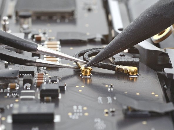

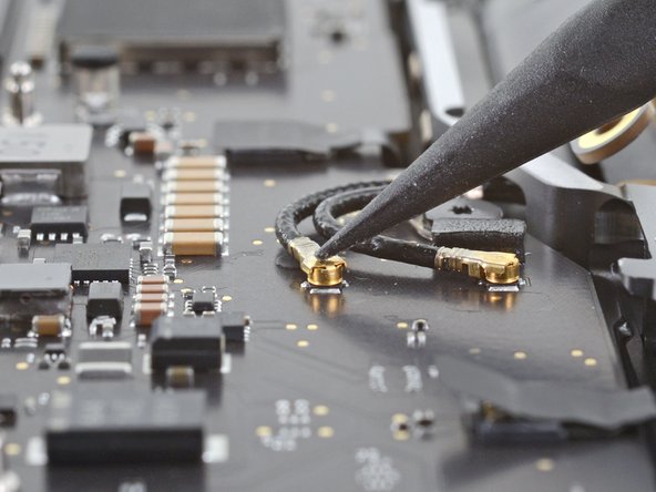

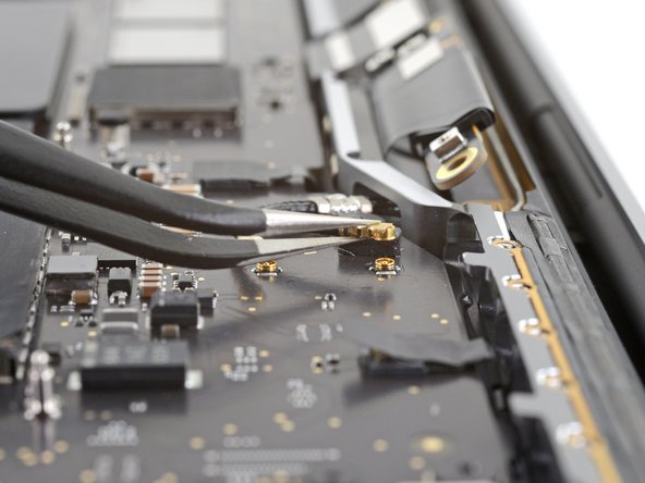

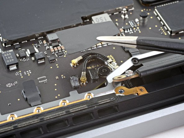

  23. MacBook Pro 13" Two Thunderbolt Ports 2020 Display Assembly Replacement: crwdns2935265:023crwdnd2935265:01crwdnd2935265:03crwdne2935265:0 MacBook Pro 13" Two Thunderbolt Ports 2020 Display Assembly Replacement: crwdns2935265:023crwdnd2935265:02crwdnd2935265:03crwdne2935265:0 MacBook Pro 13" Two Thunderbolt Ports 2020 Display Assembly Replacement: crwdns2935265:023crwdnd2935265:03crwdnd2935265:03crwdne2935265:0
    • Carefully disconnect the two antenna coax cables by prying them straight up from the logic board.
    • Slide your tweezers or the flat end of your spudger underneath each cable until it's near the socket, and then gently twist or pry up to disconnect it.
  24. MacBook Pro 13" Two Thunderbolt Ports 2020 Display Assembly Replacement: crwdns2935265:024crwdnd2935265:01crwdnd2935265:03crwdne2935265:0 MacBook Pro 13" Two Thunderbolt Ports 2020 Display Assembly Replacement: crwdns2935265:024crwdnd2935265:02crwdnd2935265:03crwdne2935265:0 MacBook Pro 13" Two Thunderbolt Ports 2020 Display Assembly Replacement: crwdns2935265:024crwdnd2935265:03crwdnd2935265:03crwdne2935265:0
    • To reconnect each antenna cable, use tweezers to align the connector directly over its socket, and then press down with a spudger so it snaps into place.

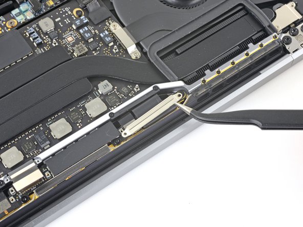

  25. MacBook Pro 13" Two Thunderbolt Ports 2020 Display Assembly Replacement: crwdns2935265:025crwdnd2935265:01crwdnd2935265:01crwdne2935265:0
    • Remove the 3.7 mm T5 Torx screw securing the two antenna coax cables to the main board.

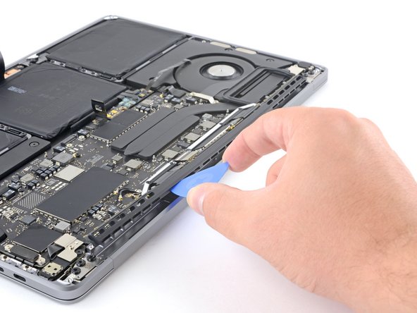

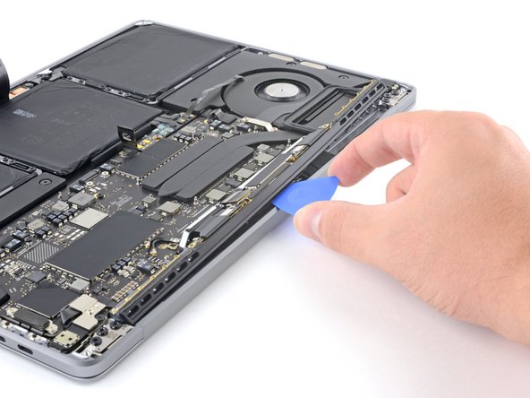

  26. MacBook Pro 13" Two Thunderbolt Ports 2020 Display Assembly Replacement: crwdns2935265:026crwdnd2935265:01crwdnd2935265:03crwdne2935265:0 MacBook Pro 13" Two Thunderbolt Ports 2020 Display Assembly Replacement: crwdns2935265:026crwdnd2935265:02crwdnd2935265:03crwdne2935265:0 MacBook Pro 13" Two Thunderbolt Ports 2020 Display Assembly Replacement: crwdns2935265:026crwdnd2935265:03crwdnd2935265:03crwdne2935265:0
    • Use an opening pick to lever out the antenna cable assembly in the areas shown.
    • Don't slide the opening pick from side to side, because there are two display cables that can be damaged.

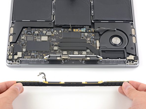

  27. MacBook Pro 13" Two Thunderbolt Ports 2020 Display Assembly Replacement: crwdns2935265:027crwdnd2935265:01crwdnd2935265:03crwdne2935265:0 MacBook Pro 13" Two Thunderbolt Ports 2020 Display Assembly Replacement: crwdns2935265:027crwdnd2935265:02crwdnd2935265:03crwdne2935265:0 MacBook Pro 13" Two Thunderbolt Ports 2020 Display Assembly Replacement: crwdns2935265:027crwdnd2935265:03crwdnd2935265:03crwdne2935265:0
    • Carefully remove the antenna assembly while simultaneously feeding the antenna cable bundle out from underneath the heat pipe.
    • Remove the antenna cable assembly.
    • During reassembly, gently pinch the cable bundle together and guide it under the heat pipe into the correct position on the board. If needed, use your tools to help guide it through, but don't force it.

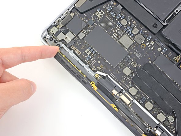

  28. MacBook Pro 13" Two Thunderbolt Ports 2020 Display Assembly Replacement, Remove the display assembly: crwdns2935265:028crwdnd2935265:01crwdnd2935265:01crwdne2935265:0
    • Remove the four 3.9 mm T3 Torx screws securing the spring hinges of the two display cables.
  29. MacBook Pro 13" Two Thunderbolt Ports 2020 Display Assembly Replacement: crwdns2935265:029crwdnd2935265:01crwdnd2935265:03crwdne2935265:0 MacBook Pro 13" Two Thunderbolt Ports 2020 Display Assembly Replacement: crwdns2935265:029crwdnd2935265:02crwdnd2935265:03crwdne2935265:0 MacBook Pro 13" Two Thunderbolt Ports 2020 Display Assembly Replacement: crwdns2935265:029crwdnd2935265:03crwdnd2935265:03crwdne2935265:0
    • Grab the left side of the display cable assembly and pull it towards the bottom end of the MacBook and away from the spring hinge.
    • Use a pair of tweezers to pull the spring hinge of the display cable out of its bracket.
    • Repeat this step with the right spring hinge of the display cable assembly.

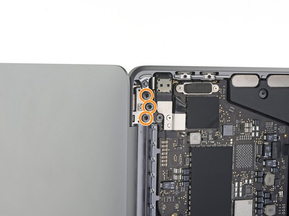

  30. MacBook Pro 13" Two Thunderbolt Ports 2020 Display Assembly Replacement: crwdns2935265:030crwdnd2935265:01crwdnd2935265:02crwdne2935265:0 MacBook Pro 13" Two Thunderbolt Ports 2020 Display Assembly Replacement: crwdns2935265:030crwdnd2935265:02crwdnd2935265:02crwdne2935265:0
    • Fully open the screen and stand your MacBook Pro up on one side.
    • While steadying the MacBook pro with your free hand, remove the three T8 Torx screws from the lower display hinge.
    • Remove the remaining three T8 Torx screws from the upper display bracket.

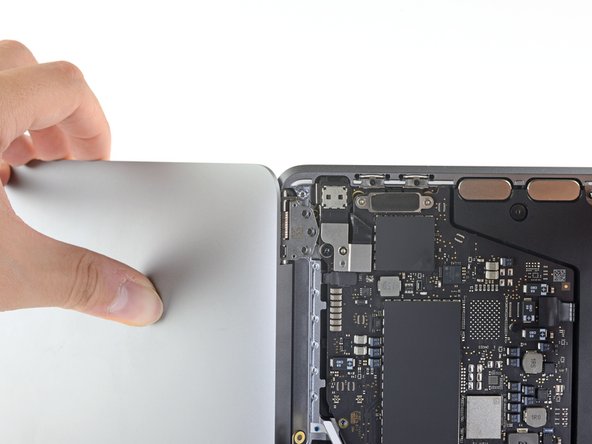

  31. MacBook Pro 13" Two Thunderbolt Ports 2020 Display Assembly Replacement: crwdns2935265:031crwdnd2935265:01crwdnd2935265:03crwdne2935265:0 MacBook Pro 13" Two Thunderbolt Ports 2020 Display Assembly Replacement: crwdns2935265:031crwdnd2935265:02crwdnd2935265:03crwdne2935265:0 MacBook Pro 13" Two Thunderbolt Ports 2020 Display Assembly Replacement: crwdns2935265:031crwdnd2935265:03crwdnd2935265:03crwdne2935265:0
    • Keep a firm grip on both the screen and main body of the MacBook Pro. Either half can fall unexpectedly during this step.
    • Push both halves of the MacBook Pro together so that the hinge brackets can be lifted clear of their recesses in the chassis.
    • Push the main body of the MacBook Pro away from you while pulling the screen toward you to separate it.
    • Remove the display/screen assembly, being careful not to snag it on any cables.
