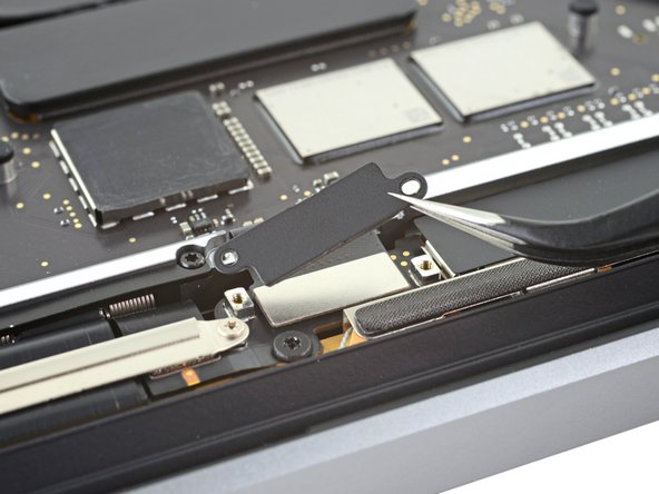

  17. MacBook Pro 13" Two Thunderbolt Ports Late 2020 Display Assembly Replacement: crwdns2935265:017crwdnd2935265:01crwdnd2935265:02crwdne2935265:0 MacBook Pro 13" Two Thunderbolt Ports Late 2020 Display Assembly Replacement: crwdns2935265:017crwdnd2935265:02crwdnd2935265:02crwdne2935265:0
    • Remove the two 3.1 mm T3 Torx screws securing the aluminum cover on top of the main display cable.
    • Remove the cover.

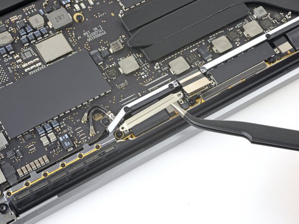

  18. MacBook Pro 13" Two Thunderbolt Ports Late 2020 Display Assembly Replacement: crwdns2935265:018crwdnd2935265:01crwdnd2935265:02crwdne2935265:0 MacBook Pro 13" Two Thunderbolt Ports Late 2020 Display Assembly Replacement: crwdns2935265:018crwdnd2935265:02crwdnd2935265:02crwdne2935265:0
    • Remove the two 1.7 mm T3 Torx screws securing the aluminum cover on top of the display cable flex connector.
    • Remove the cover.

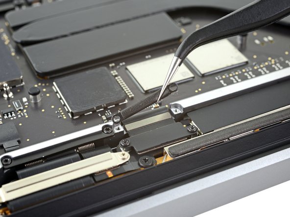

  19. MacBook Pro 13" Two Thunderbolt Ports Late 2020 Display Assembly Replacement: crwdns2935265:019crwdnd2935265:01crwdnd2935265:02crwdne2935265:0 MacBook Pro 13" Two Thunderbolt Ports Late 2020 Display Assembly Replacement: crwdns2935265:019crwdnd2935265:02crwdnd2935265:02crwdne2935265:0
    • Pry the display board flex cable straight up from its socket to disconnect it from the display board.
  20. MacBook Pro 13" Two Thunderbolt Ports Late 2020 Display Assembly Replacement: crwdns2935265:020crwdnd2935265:01crwdnd2935265:03crwdne2935265:0 MacBook Pro 13" Two Thunderbolt Ports Late 2020 Display Assembly Replacement: crwdns2935265:020crwdnd2935265:02crwdnd2935265:03crwdne2935265:0 MacBook Pro 13" Two Thunderbolt Ports Late 2020 Display Assembly Replacement: crwdns2935265:020crwdnd2935265:03crwdnd2935265:03crwdne2935265:0
    • Remove the four 1.5 mm T3 Torx screws securing the two aluminum covers on top of the two display cable connectors.
    • Use a pair of tweezers to remove the two aluminum covers.

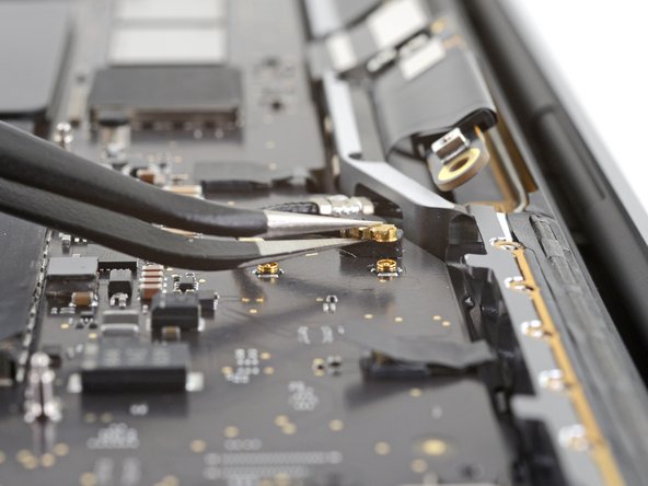

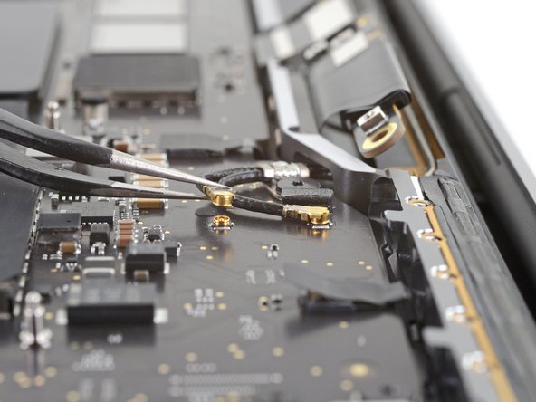

  23. MacBook Pro 13" Two Thunderbolt Ports Late 2020 Display Assembly Replacement: crwdns2935265:023crwdnd2935265:01crwdnd2935265:03crwdne2935265:0 MacBook Pro 13" Two Thunderbolt Ports Late 2020 Display Assembly Replacement: crwdns2935265:023crwdnd2935265:02crwdnd2935265:03crwdne2935265:0 MacBook Pro 13" Two Thunderbolt Ports Late 2020 Display Assembly Replacement: crwdns2935265:023crwdnd2935265:03crwdnd2935265:03crwdne2935265:0
    • Carefully disconnect the two antenna coax cables by prying them straight up from the logic board.
    • Slide your tweezers or the flat end of your spudger underneath each cable until it's near the socket, and then gently twist or pry up to disconnect it.

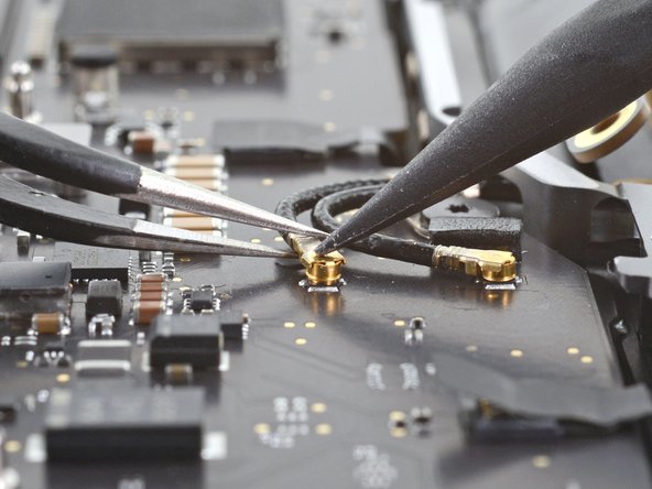

  24. MacBook Pro 13" Two Thunderbolt Ports Late 2020 Display Assembly Replacement: crwdns2935265:024crwdnd2935265:01crwdnd2935265:03crwdne2935265:0 MacBook Pro 13" Two Thunderbolt Ports Late 2020 Display Assembly Replacement: crwdns2935265:024crwdnd2935265:02crwdnd2935265:03crwdne2935265:0 MacBook Pro 13" Two Thunderbolt Ports Late 2020 Display Assembly Replacement: crwdns2935265:024crwdnd2935265:03crwdnd2935265:03crwdne2935265:0
    • To reconnect each antenna cable, use tweezers to align the connector directly over its socket, and then press down with a spudger so it snaps into place.

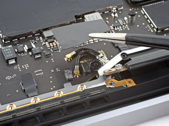

  25. MacBook Pro 13" Two Thunderbolt Ports Late 2020 Display Assembly Replacement: crwdns2935265:025crwdnd2935265:01crwdnd2935265:01crwdne2935265:0
    • Remove the 3.7 mm T5 Torx screw securing the two antenna coax cables to the main board.
  26. MacBook Pro 13" Two Thunderbolt Ports Late 2020 Display Assembly Replacement: crwdns2935265:026crwdnd2935265:01crwdnd2935265:03crwdne2935265:0 MacBook Pro 13" Two Thunderbolt Ports Late 2020 Display Assembly Replacement: crwdns2935265:026crwdnd2935265:02crwdnd2935265:03crwdne2935265:0 MacBook Pro 13" Two Thunderbolt Ports Late 2020 Display Assembly Replacement: crwdns2935265:026crwdnd2935265:03crwdnd2935265:03crwdne2935265:0
    • Use an opening pick to lever out the antenna cable assembly in the areas shown.
    • Don't slide the opening pick from side to side, because there are two display cables that can be damaged.

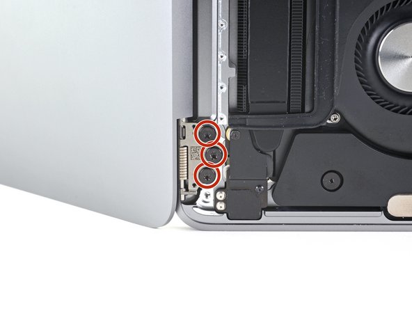

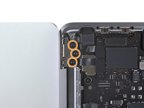

  31. MacBook Pro 13" Two Thunderbolt Ports Late 2020 Display Assembly Replacement: crwdns2935265:031crwdnd2935265:01crwdnd2935265:03crwdne2935265:0 MacBook Pro 13" Two Thunderbolt Ports Late 2020 Display Assembly Replacement: crwdns2935265:031crwdnd2935265:02crwdnd2935265:03crwdne2935265:0 MacBook Pro 13" Two Thunderbolt Ports Late 2020 Display Assembly Replacement: crwdns2935265:031crwdnd2935265:03crwdnd2935265:03crwdne2935265:0
    • Fully open the screen and stand your MacBook Pro up on one side.
    • While steadying the MacBook pro with your free hand, remove the three T8 Torx screws from the lower display hinge.
    • Remove the remaining three T8 Torx screws from the upper display bracket.

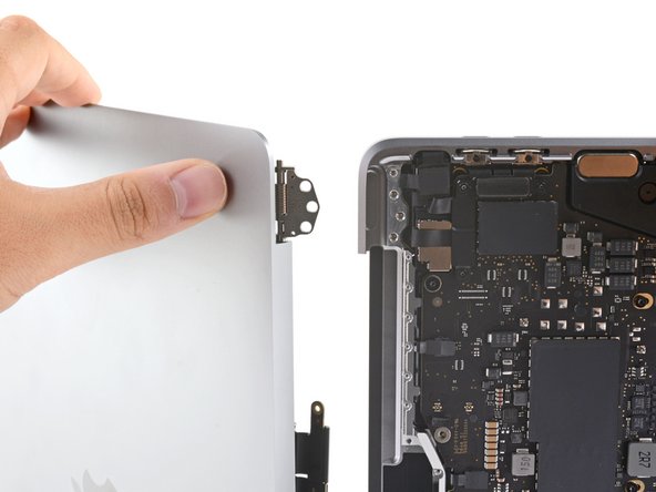

  32. MacBook Pro 13" Two Thunderbolt Ports Late 2020 Display Assembly Replacement: crwdns2935265:032crwdnd2935265:01crwdnd2935265:03crwdne2935265:0 MacBook Pro 13" Two Thunderbolt Ports Late 2020 Display Assembly Replacement: crwdns2935265:032crwdnd2935265:02crwdnd2935265:03crwdne2935265:0 MacBook Pro 13" Two Thunderbolt Ports Late 2020 Display Assembly Replacement: crwdns2935265:032crwdnd2935265:03crwdnd2935265:03crwdne2935265:0
    • Keep a firm grip on both the screen and main body of the MacBook Pro. Either half can fall unexpectedly during this step.
    • Push both halves of the MacBook Pro together so that the hinge brackets can be lifted clear of their recesses in the chassis.
    • Push the main body of the MacBook Pro away from you while pulling the screen toward you to separate it.
    • Remove the display/screen assembly, being careful not to snag it on any cables.
