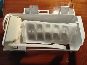

I have a Whirlpool Side-by-Side (exact model in Title) and the ice maker stopped working but the water pressure appears to be adequate. I have tried a couple things already…
1) checked the on/off switch (it was on, still not working)
2) checked water pressure - appears to be okay
3) filter was changed about 1 month and half ago
4) took out the ice that was in the tray (no blockages that would be causing it not to drop ice in the bin)
5) took the bin and ice maker out completely and checked for any frozen components (none found)
6) minimal ice build up on water tube that dispenses into the maker (cleared out)
7) removed water filter (recommended elsewhere to see if the filter was clogged, not sure if this will help or not)
That is pretty much all I have been able to do so far. I do not hear any noises or anything coming from the maker at all. I don't want to condemn the ice maker yet, especially if it may be something else. Any ideas?

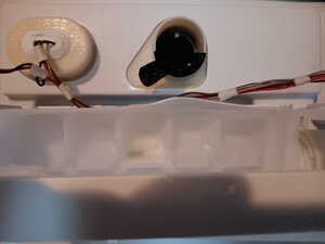

I FIXED THIS! I cut the bottom of a water bottle off about two inches and made a side port for the tube water dispenser. Taped it over the outlet and it blocked the air that was freezing the tube!
@tewatkins do you have a picture?
Just cover the opening with cardboard. I posted a picture at the end of this thread.

UPDATE!!! Hair Dryer worked! I aimed it at area where the ice is made as well as the vent/shoot where the ice comes through. It seems to have worked. They need to sell blowdryers with the product for future freeze ups...in the freezer LOL

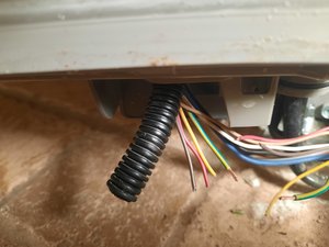

Check to see if you have wires broke Look on the freezer door on the bottom left side o door If there broke they say that you have to replace the whole door Ihad the same problem

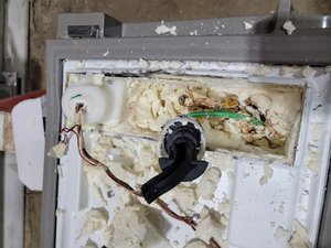

After a year of waiting to get another door, it turned out that the problem was the icemaker had not returned to the home position after dumping a batch of ice. That was the problem. The repair man used the keypad on the door to run the recycle to get it back to the home position. I'm not sure if you could accomplish this by just physically forcing it back into position or not.

You do not use the hair dryer on the ice tray, you use it on the black tube that feeds the water into the tray. If you take a piece of styrofoam and fit it into the area near the black feeder tube to shield it from the icy wind of the fan (someone else's idea I used and it eliminated the problem) you should not continue to have this problem. I did and my system has worked perfectly for years.
On second thought, it looks like you used a heat gun to destroy your ice maker.

I've had 6 of these fridges with fill lines freezing. The heating element burns out. See pic. It's wrapped around the water line. You pretty much have to destroy the door and foam to get to it. If you're careful, you can cut this out so that it doesn't show if you put icemaker cover back on. From there, if you can find the same heating element? I couldn't. I was thinking remove the foam against the outer steel skin, so that the outside temp heats up the water line. Then put new foam to cover hole. Just haven't tackled this yet.

The black part is the fill tube that you can see. The green is the water line, and the foil looking thing is the heating element that is supposed to keep the water line warm. That fails, and that is why the line freezes. And everything is encased in foam, so you have to destroy the door to get to it.

Similar to what tewatkins said above, my fix was to cover the opening where the water discharges to the ice tray. Simply used cardboard and duct tape. Cut the cardboard the size of the opening above the water chute. Wrapped the water chute too, but don't know if I had to. It's worked fine for a couple weeks this way. Would not last two days before.
Where is this water chute? Can you zoom out and take another pic?

Just had a repair guy look at ours and it turns out that the heater to keep the water line from freezing is inside the door and can’t be repaired. You have to replace the door to the tune of about $500. Call Whirlpool and file a complaint. They need to make this right.

My 6 years  whirlpool wrs588 has same problem - broken wires ( 4 ea.)
I solder it  - problem solved
Those wires are not broken they were obviously CUT. If it is 6 years old and was working properly for 6 years who cut them? This answer is just wrong and meaningless for people with a problem.
Wires were NOT cut. I find this problem and fix it. Honestly !

4 broken wires bottom of freezer door next to the hinge. Unbelievable I did not see that to begin with, but in my defense, it was somewhat concealed 🧐.

They also have a problem breaking the wires coming into the bottom of the freezer door. I had to reconnect all of them on my sisters unit.
That would also cause an ice maker issue.
A couple of weeks ago I posted a photo of a badly warped icemaker tray. I thought I had warped with heat from a hair dryer. I was wrong. It was not heat. It was impact.
After installing a new $100 icemaker unit 2 weeks ago the unit was working fine until last night when I heard this loud bang. I shut it down. I found the new tray beginning to get warped and I have not been anywhere near it with a hair dryer. What it appears is happening is that sort of a wide icicle is forming hanging from the case above the tray. When the tray tries to flip it hits the ice and you hear the bang and the impact begins to warp the tray. Over time icicles forming and different places cause impact in different places until it looks like my old tray. I remember hearing a bang from time to time but couldn't figure out what caused it.
Now I will try to keep the icicles from forming by covering/insulating the opening from the water line as others have done. What a terrible design.
Could it be that the water valve is leaking? Icicles are not going to form when the water is on.
Possible. I'm peering through the vent with a flash light trying to figure it out. I hadn't planned on this being my new hobby.
