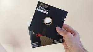

Also the floppy disks with the system and program
