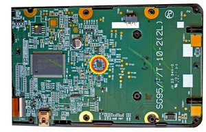

Last night after I unplugged my calculator, I found out the charging light was still on and it couldn't be turned off. The light is on all day today, and it really kills the battery, so by the end of today I have to recharge it . I tried to reset and remove the battery, but these methods didn't help. So I wonder what is wrong with my calc, should I get a new one or should i just get a new battery? Is there anyway i can do to save it? Help S.O.S. Thank you!

I changed to a new battery and updated my OS, but the charging light is still on and it really kills the battery life. Usually the ti-calculator can stand for at least 2 weeks, now I have to charge it every 12 hours. I would really like to know is there another way to fix it? Thanks!

Hi, I think I can help you, but I need a bit of information. First, does the calculator still function perfectly other than the LED not turning off? What color is the LED? Can you transfer data between the calculator and your computer? (if you plug it into your laptop does your computer recognize something was plugged in?) If you install TI Connect CE, can you view your calculator's contents or does TI Connect CE throw an error? Did you try reinstalling the OS? TI-84 Plus CE Recovery Techniques.
Thank you for your information. Other functions run perfectly except the led, and the color is green. I haven't tried to transfer my data between the calculator and the computer yet. My new battery is arriving today, and I will see how that will work.
I changed to a new battery, but the charging light is still on.
Ok, did you try connecting it to your computer yet? If not, try that and if it connects properly, then try reinstalling the OS. TI-84 Plus CE Recovery Techniques.
Please let me know how it turns out!
Yes, I did, and everything else seemed normal, and I did reinstall the OS. But the light is still on.

(DrDnar and KermMartian helped me with this new answer, the original answer turned out to be not so accurate so I’ve updated this with my new knowledge)
Their best guess is that a surge of electricity fried your BMIC (one of the key components to charging your calculator). That would be the reason why your LED is stuck on.
Your LED however, is not the sole reason why your calculator is draining battery power since that LED barely draws any power at all. It sounds like BMIC is likely the culprit to where all that power is going.
Unfortunately, a BMIC repair is going to be very tricky and will require a donor calculator. You’ll need to be comfortable with soldering surface mount components. Before you go and try replacing it, I’d suggest contacting TI first to see if they can assist you at all or replace your calculator.
Here’s an image of the TI-84 Plus CE PCB. I’ve circled the location of the BMIC (it is in the same place on every hardware revision up to time of posting [Revision pre-A to N]).
Let me know if you have any questions!

The driving transistor for the charging LED is integrated directly into the BMIC, which is a nice feature. That's why you can't finding a driving transistor. (By contrast, the testing LED on so-equipped calculators does have a driving transistor. Two, in fact, as it's a two-color LED.)
However, you do not need to use a donor calculator; you can just buy the BMIC directly off a site like Digikey. The chip is a TI LM3658 and is marked L155B. A voltage surge could definitely damage the BMIC, so if you've got the skills, replacing it is definitely a worth a try.
Another possibility is that the USB port's boost converter is stuck on, causing the calculator to try to charge itself, which will actually waste a fair bit of power. The boost converter supplies +5 V to the USB port when the calculator is in host mode. If you never need to use something like a TI Rover or CBL, you might be able to identify and disable the offending circuit, either by cutting the output trace, or by cutting the input to the boost circuit. Do note, however, that doing so may also cause trouble with calculator-to-calculator linking; if you do experience trouble with linking, just swap cable ends, as you should only have trouble when a type A plug is inserted.
Additionally, TheLastMillennial, if the LED is on even when no cable is inserted, replacing the battery won't help. The BMIC will not drive the charging LED when no external power is supplied; in fact, it shuts down completely.
