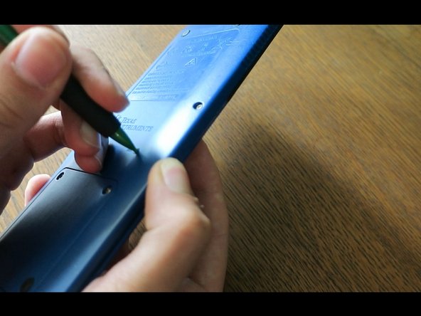

  2. TI-84 Plus CE Recovery Techniques., Perform a RAM reset with the reset button.: crwdns2935265:02crwdnd2935265:01crwdnd2935265:03crwdne2935265:0 TI-84 Plus CE Recovery Techniques., Perform a RAM reset with the reset button.: crwdns2935265:02crwdnd2935265:02crwdnd2935265:03crwdne2935265:0 TI-84 Plus CE Recovery Techniques., Perform a RAM reset with the reset button.: crwdns2935265:02crwdnd2935265:03crwdnd2935265:03crwdne2935265:0
    • This will clear all information stored in the RAM!
    • Information stored in the Archive will be safe.
    • Remove the slide case and turn your calculator on its back.
    • Take a pencil or thin object and press and hold the 'reset' button on the back of the calculator for at least 2 seconds, then release.
    • After a second or two, your calculator should say "RAM Cleared".

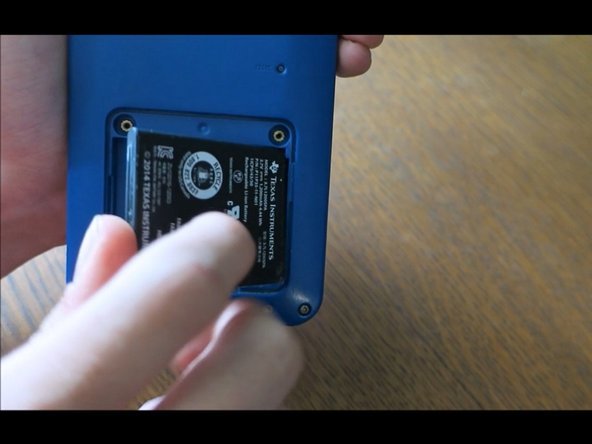

  3. TI-84 Plus CE Recovery Techniques., Perform a RAM reset by removing the battery.: crwdns2935265:03crwdnd2935265:01crwdnd2935265:03crwdne2935265:0 TI-84 Plus CE Recovery Techniques., Perform a RAM reset by removing the battery.: crwdns2935265:03crwdnd2935265:02crwdnd2935265:03crwdne2935265:0 TI-84 Plus CE Recovery Techniques., Perform a RAM reset by removing the battery.: crwdns2935265:03crwdnd2935265:03crwdnd2935265:03crwdne2935265:0
    • This will clear all information in the RAM!
    • Refer to this guide for instructions on how to remove the battery.
    • Reinsert the battery after a few seconds.
    • Your calculator should automatically turn on and display a "RAM Cleared" screen.

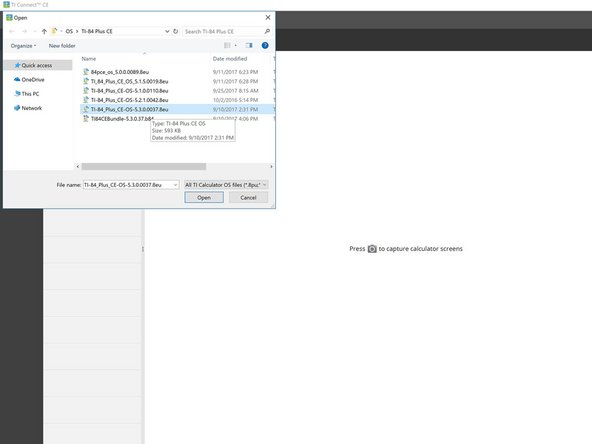

    • Download and install OS 5.4.0: TI-84 Plus CE | TI-83 Premium CE.
    • If OS 5.4.0 is not supported, then download the latest OS: TI-84 Plus CE | TI-83 Premium CE

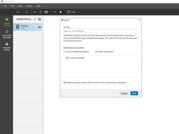

    • In TI Connect CE, click on 'Actions', then 'send OS/Bundle to calculators...'
    • Navigate to where you saved the OS and select it. It will take a second for TI-Connect CE to load. Once the popup appears, click 'send'.
    • This will take a few minutes to install.
