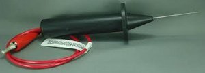

If you do not know where to get a real discharge tool (or have one) since they’re hard to come by these days, it’s okay to use a rubber-handled screwdriver with an alligator clip lead, but do not want to use the ones from Radio Shack or Fry's; they will burn up. Use car jumper wires if that’s all you have - it’s overkill, but when dealing with 15-25,000 volts you’re better off going overboard to be sure it will not bite YOU and potentially kill you.
Before removing the anode from the tube, ALWAYS TOUCH THE LEADS WITH A GROUNDED SCREWDRIVER FIRST! This ensures the monitor has no charge left. Failure to do this CAN KILL YOU.

I just use a CRT discharging tool to eliminate the hazard. cheap! I would have been out of business if I let fear dictate what I could work on. After all, most of the early Macs all had CRTs! But I remember a couple of times when my tech got knocked on his tukus when he didn’t discharge it. But after the second time, he remembered to discharge them ;-)
