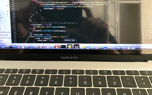

Hi,
So I got this weird black bar that appears on the bottom of the bar only after using the laptop for a period of time, and it just getting higher since the first time it appeared!

The problem is likely with the TCON board which is part of the Display Assembly.
Going on why you think it might be your 3rd party dongle, when you disconnect it does the display issue go away? If not then it's not related.
I've had this problem as well on a 2017 13" MacBook Pro. It appeared that the issue was due to the display cable (being a flat ribbon-type cable) got folded at quite an extreme angle. I opened up the MacBook and changed the extreme fold angle of the cable into a more 'humane' one. It got rid of the problem ever since.

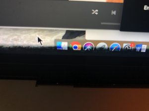

There are two distinct issues here:
The first is when someone cooks their system, like leaving it exposed in a car so the diffuser sheets melt. This requires a new display assembly.
The second which is becoming more prevalent is overheating of the T-CON board which is physically attached to the LCD within the lid via ribbon cables. Sadly, you can't replace one without the other. Look at the picture above.

Yours is a bit different than what I've seen. In your case its a black bar not a grayish bar (see the other postings here)
Your ribbon cable maybe damaged. In any case you'll need a new display assembly. Sorry ;-{

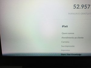

Black bar depends on what is displayed on the screen, if it displays black, the longer it will turn black, if it displays white it will turn white but most will be gray.

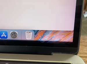

Not a Touch Bar model, but is this the same problem? 2016 MacBook Pro, approx 5mm black bar across the entire base of screen only noticed in recent days…

With mine the bar at the bottom begins as gray and later becomes completely black. It has gotten as high as 2 inches above the bottom. Maxing out the fans does not make it go away. Turning it off for several hours does make it disappear, but as time goes by each time I turn it back on the bars come back sooner, and go higher, esp. when used for hours at a time.

The 13" Fn & 15" Touch Bar models both have undersized heat management systems! These are the ones that are most effected.
The 13" Touch Bar model has a better sized heat management system as unlike the 15" which has a GPU chip which also needs cooling the same sized cooling solution is used on the 13" which doesn't have the added GPU heat load. These rarely encounter the issue, the only time is if the fan & fins is loaded up with dust! Or allow to overheat due to using the system on a rug or bed.
In any case the placement of the T-CON board within the uppercase in very close proximity of the heat sink and the heat transfer tube and the heat transfer fins puts it at risk of overheating!
The 2015 and older 13" & 15" models had the T-CON placed within the lid within the chin area at the bottom of the display (where the logo plate is). This is a much cooler area!
