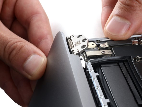

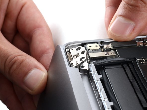

    5. MacBook Pro 13" Touch Bar 2017 Screen Replacement, Free the left hinge: crwdns2935265:031crwdnd2935265:01crwdnd2935265:03crwdne2935265:0 MacBook Pro 13" Touch Bar 2017 Screen Replacement, Free the left hinge: crwdns2935265:031crwdnd2935265:02crwdnd2935265:03crwdne2935265:0 MacBook Pro 13" Touch Bar 2017 Screen Replacement, Free the left hinge: crwdns2935265:031crwdnd2935265:03crwdnd2935265:03crwdne2935265:0
      • Keep the screen supported constantly during the next two steps.
      • Firmly secure the main body of your MacBook with one hand.
      • With your free hand, push the left side of the screen up and towards the bottom of your laptop to free the left hinge.
      • Be very careful not to damage the Touch Bar connector when moving the left hinge. It can be easily crushed, resulting in an inoperable Touch Bar.

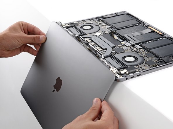

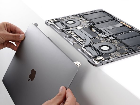

    6. MacBook Pro 13" Touch Bar 2017 Screen Replacement, Remove the screen: crwdns2935265:032crwdnd2935265:01crwdnd2935265:03crwdne2935265:0 MacBook Pro 13" Touch Bar 2017 Screen Replacement, Remove the screen: crwdns2935265:032crwdnd2935265:02crwdnd2935265:03crwdne2935265:0 MacBook Pro 13" Touch Bar 2017 Screen Replacement, Remove the screen: crwdns2935265:032crwdnd2935265:03crwdnd2935265:03crwdne2935265:0
      • Free the right hinge and remove the screen.
