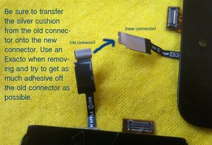

After you remove your old screen look on the tip of the thin video cable and you will see what looks like a little aluminum/mesh cushion pad. Some manufacturers are shipping replacement screens without this pad and without it you will get a white screen.
Carefully use an Exacto to scrape the old one off, try to get as much adhesive as you can when your working and note the orientation and which side the adhesive is on. Place the cushion on your new screen and hook it up.

@phil, here is a photo to clarify.

I plan on calling them tomorrow, dunno if it makes a difference, but in this photo you'll see on on the left is the connector for the new screen which leaves me with a white screen and the right a connector from an old screen which works fine. You could be having the same issue.

Thanks for pointing out the pad and for the photo @John. I just pinch this pad off the old screen and it stays sticky.

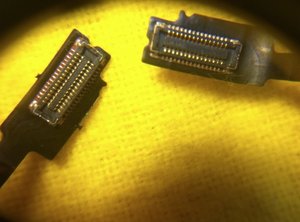

Using a magnifer (20x binocular if possible) look at the area to the right of the lcd connector on the mother board - with the lcd itself disconnected. There should be a row of tiny components in a vertical line between the right hand side of the connector and the ambient light sensor (the one with the foam sponge around it). The 2nd component up should be a little black resistor. I had accidentally knocked mine off whilst prying up the lcd connector.
I bridged that missing resistor by applying some solder across the 2 pads and when then lcd was re-connected the white screen was fixed. That was a year ago & the ipod has worked fine since. Ideally you would get a resistor the same size & resistance , but I didnt have access to smd reworking-type equipment. So far so good!

This is not a problem with the digitizer but the LCD connector. Check if it damaged like mine was where a pin was gone of the connector:
https://www.dropbox.com/gallery/943721/1...
Look at the picture LCD_connector_ipodtouch4g.

Could very well be a bad seated digitizer connector. It is the one deepest under the plate so you would have to open everything up again. Be careful to transfer over the small little sponge to the cable as it puts pressure on the connector and keeps it in place. Could of course be a bad digitizer, but 9 out of 10 times when I have lines, half picture, half responsive glass etc. I reseat the connectors and also use contact spray on the connectors.
Thanks for suggestion. It worked after installation. Just noticed now that front camera does not open. Any hint for solvi g it? Thanks

I work at a cellular repair store and have come across this issue multiple times. To fix this issue the first time I encountered it I simply bridged the internal charging dock with the third solder point on the right using a metal dental tool with a rubber handle. This fixed a dead iPod that BEFORE revived would only give a white screen and no iTunes response.
The second time I encountered the white screen I took the combo off multiple times and thought it wasn't plugged in correctly but that didn't fix it. When plugging it into iTunes I got a response from it and made a backup of the data. By restoring the iPod from the backup with "encrypt local backup" option pressed (this option saves passwords/account information so you don't have to re-enter all of your passwords after restoring) and once it was restored the screen came back to life.

What helped me was taking out the screen (again) and disconnect the two connectors,(put on the little rubber on the digitizer) then to make sure the lcd connector is 100% inlined I connected that one before putting the heat shield and the screws back on, Its a little harder dealing with the 90 degrees upstanding screen you need to hold still or let rest against a stander, but it ensures a good connection between the connectors, and waaaaay less changes of white screens.
hi guys if your looking for your answer and i mean really looking for it.... look no further.... ok first inspect the mother board for any damage u may have caused... and look closely... and relax cause most of the time mother board damage is fixable with a little bit of silver paint from radio shaack... basically sodder for dummys who cant sodder lol like me... but back on topic... if you cant find any noticeable damage then most likely there is non... ok now after inspecting the mother board. people sometimes don't fold the digitized ribon right(look at a video taking a ipod apart to get the idea how to fold it) and it gets pinched on that metal cover that overlaps the mother board.. this is where you find people saying OOOHHHHH NO i had it all apart tested it and it worked fine and i put it back to gather and now its weight screen...... sadly if you pinch the ribbon you will need a new screen... when you have a pinched ribbon your screen will be completely wight with no sighn of life anywhere... but wait sometimes if you have a wight screen its a ipod malfunction, for this simply drian the battery and/or try the iPod reset button combo witch is holding down home button and top power button simultaneously. now if your screen is wight but has some sighn of life on it then you have a bad screen that the manufacture gave u... i advise sending it back and asking for refund. i hope this has solved your problem.
the cable you're talking about is the digitizer cable, ipod's aren't as complex as lets say an iphone 6, the cables really only affect their particular function, a white screen can only be caused by the motherboard or the display cable.
