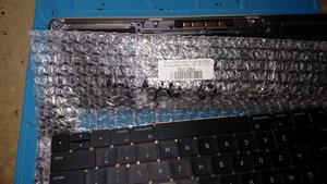

The A1706 and A1707 are not compatible. The difference is a tab at the bottom that is slightly wider on the A1706. The keyboard will not fit. I know this because I just had the honor of taking an A1707 keyboard out only to find that my vendor sent me an 1706. Fun fun.
That's pretty strange. My A1706 and A1707 keyboards are the same. Only the A1708 is different. My vendor lists the A1706 and A1707 as the same part.
