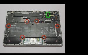

Your problem might be a loose or disconnected WiFi antenna cable.
Here is the link to the Ifixit guide on how to replace the battery in your Chromebook. It is handy because it shows how to open the laptop so as to gain access the WiFi antenna cable(s).
Samsung Chromebook Series 3 Battery Replacement
Here is an image taken from the guide. I have highlighted in a green box what I think looks like the WiFi antenna cable connections.
Check to see that they are securely connected.
(click on image to enlarge for better viewing).
Hopefully this is of some help.
Thanks, someone on the google forum linked me to this site that had pretty much a complete strip down of the chromebook. If the connections are damaged I'll have to contact Samsung and see what they can offer me, if they can offer me anything in terms of parts

I checked the connections and they seemed fine, no part number that I was able to find.
