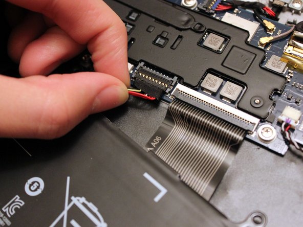

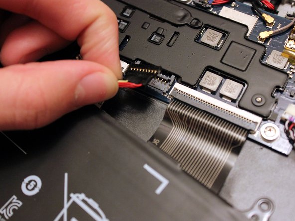

  6. Samsung Chromebook Series 3 Battery Replacement: crwdns2935265:06crwdnd2935265:01crwdnd2935265:03crwdne2935265:0 Samsung Chromebook Series 3 Battery Replacement: crwdns2935265:06crwdnd2935265:02crwdnd2935265:03crwdne2935265:0 Samsung Chromebook Series 3 Battery Replacement: crwdns2935265:06crwdnd2935265:03crwdnd2935265:03crwdne2935265:0
    • Disconnect the battery connector by pulling straight up at its base.
    • When reassembling, simply position the connector above it's original place, and push down.
  7. Samsung Chromebook Series 3 Battery Replacement: crwdns2935265:07crwdnd2935265:01crwdnd2935265:02crwdne2935265:0 Samsung Chromebook Series 3 Battery Replacement: crwdns2935265:07crwdnd2935265:02crwdnd2935265:02crwdne2935265:0
    • You can now remove the battery.

I have replaced my battery 2x and I can not charge them. They work when I get them and they keep the charge while it’s plugged in, but will not increase the charge . Any ideas what I can do?
nier101 - crwdns2934203:0crwdne2934203:0
It could be the AC power adapter is not functioning correctly. You may want to double check the charging port, too. (Samsung Chromebook Series 3 Charging Port Replacement)
Jorge Gomes -
I had a similar problem and it turned out I had not properly attached the battery connector -- the instruction is a little misleading. You do have to get those pins into the connector, which requires some horizontal movement. Here's a cute trick: plug in the AC adapter before you plug in the battery (and with the back still off -- plug in the AC directly, not through the hole in the case.) Because the battery is not connected, you'll see the green light. When you've made the connection, charging will begin and the light will change to yellow. So just fiddle -- gently -- with the battery connector until you see that yellow.
