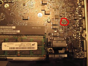

4) Near your battery, you will see a little chip that says isl6259ahrtz on it. It is a black chip, most easily recognizable with a big lowercase i on it, and 7 solder pads on each side. Take good pictures of this area and upload them, none of that low resolution/terribly lit cellphone junk!

And pictures of that area of the board please! If you are confused as to what I am asking for just take a bunch and I will find what I need.

Can you tell the name of this element (chip)?
This is a U9410 Charging and Power IC. The Boardview Files will be soon Available at http://www.K1onlinestore.co.uk
