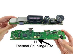

Anyway tear down the faulted kinect, check for continuity the thermal fuse in J11 connector. If it's blown replace it.

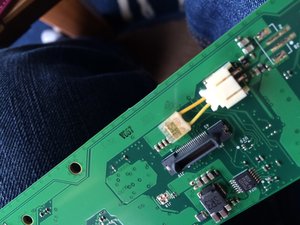

It should say j11 on or around the coupling, usually it is either a 2 pin cream coloured flat fuse (might be black now) and it is plugged into a 2 pin connector on the Kinect 2.0...at j11
Or sometimes it's simply a 2 pin Fuse/coupling soldered directly onto the board which can make it a little fiddly to find but usually the latter
I will try to show you my rough first fix before I changed the test bypass and neatened everything up, but hopefully you will get the jist.
You should find it here
This is how it looked on my K2.0 board
And this was the rough bypass test during my fault finding.
And it worked! It was my Eureka moment! Lol

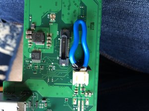

I know this is over two years old, but wouldn't it work the same to solder the two leads where the fuse would be?
It's even more years old, but I just tied together these two yellow cords and it works for now, while I'm waiting for fuse to deliver.

I did bypass the fuse j11 and it has been perfect ever since, I bypassed it with some 6amp stranded copper wire to test its functionality.
Once proved that it worked for a few days, I then replaced it with some 1.5mm solid copper core insulated cable to make sure that would never be a weak link again.

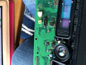

Unfortunatelly my second kinect has stopped working on Xbox one fat. When I connect kinect to the Xbox, it tell me for restart, but it won't came up. I thought there is a time for repair the blowed fuse.
Today I had some time and tear down that, because of j11 fuse problem. But there isn't a fuse.
Anybody can help me where can I found the faulty part on the newer mainboard?
That's main kinect mainboard.
No fuse at j11 nor connector for fuse.
