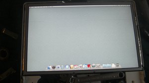

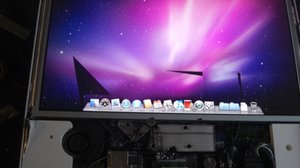

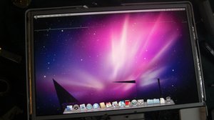

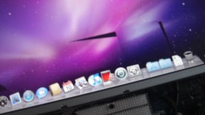

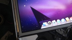

does it look like this. The last picture is the same I mac I removed the fancy desktop and put extra heat-sink on the video chip. I am waiting to see if it keeps it from locking up. I have replaced 3 screens and 2 mother boards but the pictures are very much the same. I feel it is the on board memory on the video chip is corrupt. If any one else has any ideas let me no.
