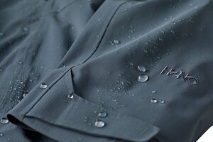

2. Durable Water Repellent (DWR) Coating
Durable water repellent or DWR is a chemical treatment applied to the outer surface of the fabric that causes water to bead up and roll off instead of soaking in. DWR doesn’t make a garment waterproof on its own. It helps keep the outer fabric dry so the membrane underneath can do its job.
DWR wears off over time due to abrasion, washing, and exposure to oils, so reapplication is essential.
Many different Patagonia® products have DWR coatings for improved performance including Down Sweaters™, Nano Puffs® and even jeans!
🔗 Follow our guide to reapply DWR: How to Reapply Durable Water Repellent (DWR) Coating

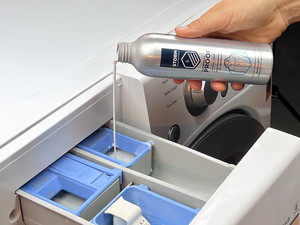

Regular washing is key to longevity. Dirt, sweat, and body oils degrade the fabric and DWR coating over time.
🔗 Learn how to wash your shell: How to Wash a Waterproof Jacket
Periodic DWR reapplication helps maintain water repellency, since DWR coatings wear off with use and washing.
🔗 Follow our step-by-step guide to reapply DWR: How to Reapply Durable Water Repellent (DWR) Coating

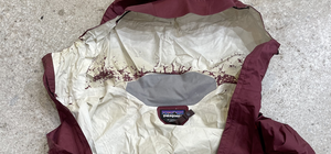

Eventually, the internal laminate will begin to peel or flake, a process called delamination. This is a sign that the shell has reached the end of its life. Unfortunately, delamination isn't repairable, and the item should be recycled and replaced.

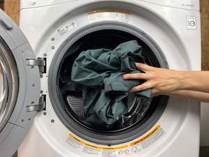

Care and Maintenance
How Often to Wash
Wash your shell every 10–20 wears, when it’s visibly dirty, and before storing it for the season.

How to Test DWR Performance
Try the spray test: lightly mist your jacket with water. If the water soaks in rather than beads up, it’s time to reapply.
🔗 See how to test your jacket's water repellency: How to Test for Water Repellency

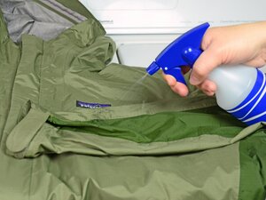

Using Spray-On DWR
Spray-on treatments are great for targeted reapplication. Follow the instructions on the bottle, which typically include:
  1. Start with a clean garment, either hanging or laid flat.
  2. Spray evenly across the outer surface, focusing on high-wear areas like shoulders and sleeves.
  3. Let the treatment sit for a few minutes.
  4. Heat-set the DWR in the dryer or with a low-heat iron with a damp cloth barrier.
When DWR Reapplication Won't Help
DWR is just the outer layer of waterproof defense. If the internal membrane laminate is peeling or flaking, reapplying DWR won’t restore waterproofness. This means the garment's core waterproof barrier is compromised.
When It's Time to Say Goodbye
If your waterproof shell is delaminating or the seam tape is peeling, it’s likely reached the end of its life. But that doesn’t mean it has to go to waste!
Send it in to Patagonia for recycling.
Even when a shell can’t be saved, its story doesn’t have to end!
