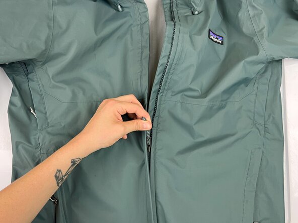

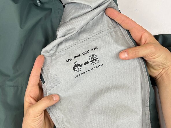

    1. How to Reapply Durable Water Repellent (DWR) Coating, Prepare your jacket: crwdns2935265:01crwdnd2935265:01crwdnd2935265:03crwdne2935265:0 How to Reapply Durable Water Repellent (DWR) Coating, Prepare your jacket: crwdns2935265:01crwdnd2935265:02crwdnd2935265:03crwdne2935265:0 How to Reapply Durable Water Repellent (DWR) Coating, Prepare your jacket: crwdns2935265:01crwdnd2935265:03crwdnd2935265:03crwdne2935265:0

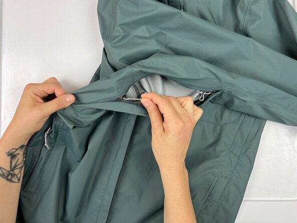

      • Zip up all zippers to protect them during the wash and dry cycles.

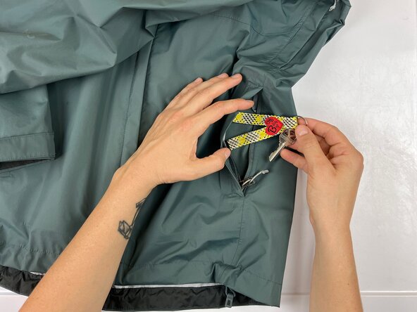

      • Check all pockets for forgotten items and hidden treasures!

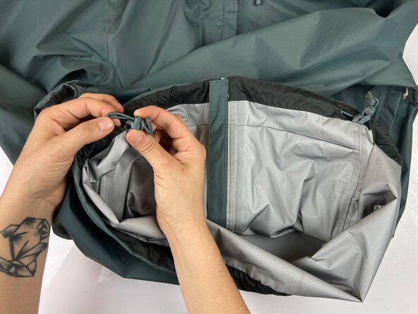

    2. How to Reapply Durable Water Repellent (DWR) Coating: crwdns2935265:02crwdnd2935265:01crwdnd2935265:03crwdne2935265:0 How to Reapply Durable Water Repellent (DWR) Coating: crwdns2935265:02crwdnd2935265:02crwdnd2935265:03crwdne2935265:0 How to Reapply Durable Water Repellent (DWR) Coating: crwdns2935265:02crwdnd2935265:03crwdnd2935265:03crwdne2935265:0
      • Loosen drawstrings and drawcords as much as possible.

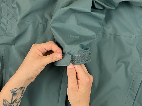

      • Fasten hook-and-loop closures in their most relaxed position to avoid snagging.

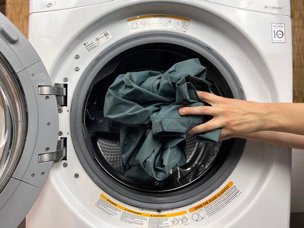

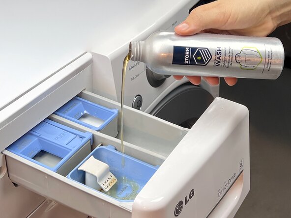

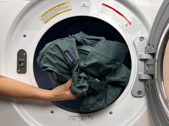

    3. How to Reapply Durable Water Repellent (DWR) Coating, Load the washer: crwdns2935265:03crwdnd2935265:01crwdnd2935265:01crwdne2935265:0
      • Place the jacket in the washing machine.
      • Add 1–3 garments at a time. Avoid overfilling the drum—technical garments need room to move freely.
      • Ideally, use a front-loading washer instead of a top-loading machine.
      • Top-loaders usually have agitators, a rotating spindle that creates friction to clean your gear. Jackets can get caught in that spindle, leading to tangles, tears, or scratches.
      • Top-loaders also require more DWR treatment. (For example Storm Eco Proofer requires 75 ml for front-loaders vs. 112 ml for top-loaders.)

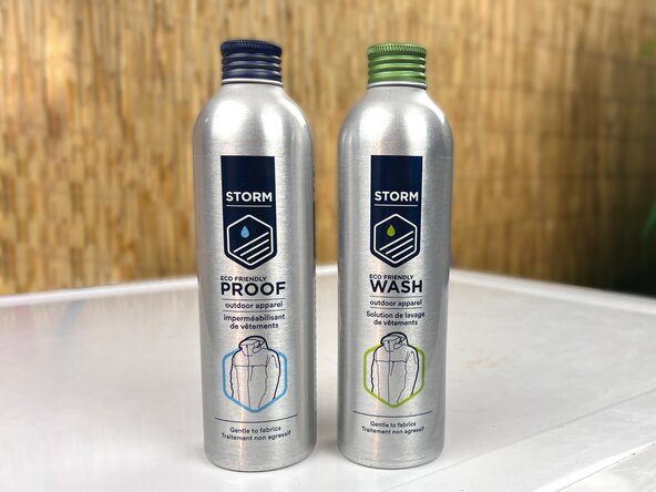

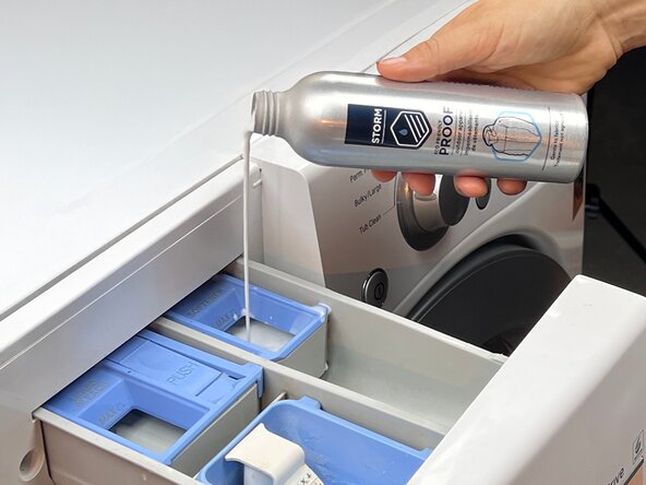

    4. How to Reapply Durable Water Repellent (DWR) Coating, Add DWR treatment: crwdns2935265:04crwdnd2935265:01crwdnd2935265:03crwdne2935265:0 How to Reapply Durable Water Repellent (DWR) Coating, Add DWR treatment: crwdns2935265:04crwdnd2935265:02crwdnd2935265:03crwdne2935265:0 How to Reapply Durable Water Repellent (DWR) Coating, Add DWR treatment: crwdns2935265:04crwdnd2935265:03crwdnd2935265:03crwdne2935265:0
      • Add durable water repellent treatment to the wash, following the instructions on the bottle.
      • For Patagonia® recommended Storm Eco Proofer:
      • Shake the bottle and measure out 2.5 ounces (75 ml) (about 1/3 cup or 5 tablespoons) per item.
      • Pour the treatment into the fabric softener compartment.
      • You can add Storm Clothing Wash to the detergent compartment. It’s designed to work with the Eco Proofer.
      • Don't use regular household detergent. It can interfere with the DWR treatment.

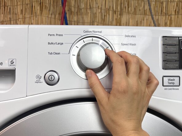

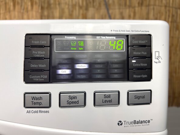

    5. How to Reapply Durable Water Repellent (DWR) Coating, Set the washing machine: crwdns2935265:05crwdnd2935265:01crwdnd2935265:02crwdne2935265:0 How to Reapply Durable Water Repellent (DWR) Coating, Set the washing machine: crwdns2935265:05crwdnd2935265:02crwdnd2935265:02crwdne2935265:0
      • Set the load size to small or medium, depending on the number of garments you're washing.
      • Set the water temperature to cold.
      • Set the wash cycle to normal or gentle/delicate/permanent press. If possible, add an extra rinse cycle to ensure all residues are removed.
      • Set the spin cycle to low.
      • Start the washing machine.

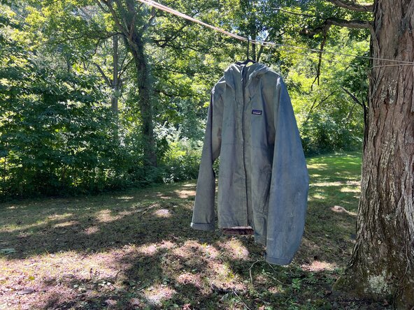

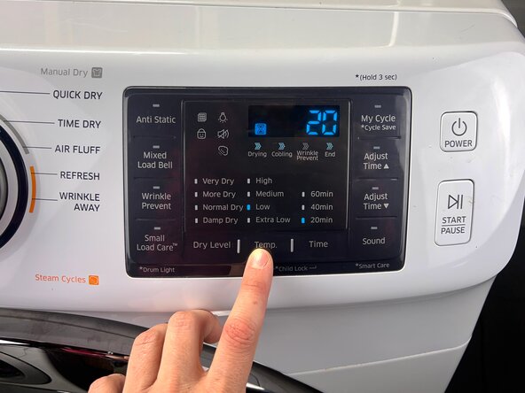

    6. How to Reapply Durable Water Repellent (DWR) Coating, Tumble dry: crwdns2935265:06crwdnd2935265:01crwdnd2935265:03crwdne2935265:0 How to Reapply Durable Water Repellent (DWR) Coating, Tumble dry: crwdns2935265:06crwdnd2935265:02crwdnd2935265:03crwdne2935265:0 How to Reapply Durable Water Repellent (DWR) Coating, Tumble dry: crwdns2935265:06crwdnd2935265:03crwdnd2935265:03crwdne2935265:0
      • Hang the jacket up to drip dry first to remove excess water.
      • Tumble dry the jacket on low heat.
      • Don't skip the dryer! Heat activates the DWR coating.
      • Follow the garment care instructions for dryer time settings. While a lightweight rain shell may only take 20 minutes, a down insulated jacket could take up to 2 hours to fully dry.
      • If you don't have access to a dryer, use a low-heat iron with a clean damp cloth between the iron and the jacket to heat-set the treatment. See How to Iron a Waterproof Jacket for more info.
