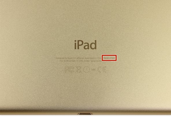

      • Turning our attention to the rear case, we find all the usual regulatory information, including a never-before-seen model number: A1584.

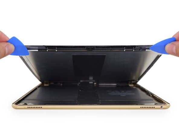

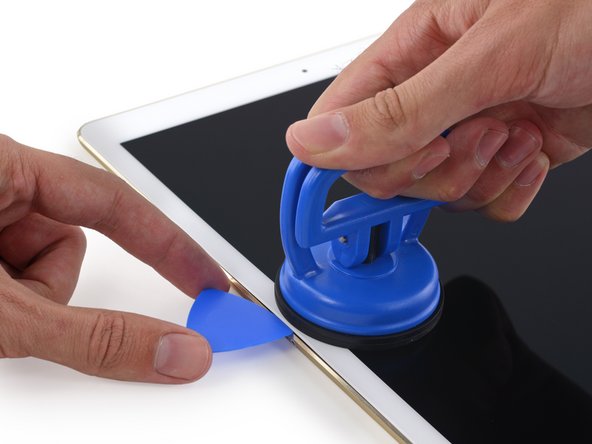

      • After a little heat-to-heat with our iOpener, we bring in our opening picks and heavy duty suction cup to open up the conversation.
      • The Pro's display is packing the same adhesive as its smaller counterparts—it's tough and there's way too much—but it's still no match for our seasoned teardown hands.
      • With the adhesive finally out of the way, we get our first glimpse of the Pro's interior.

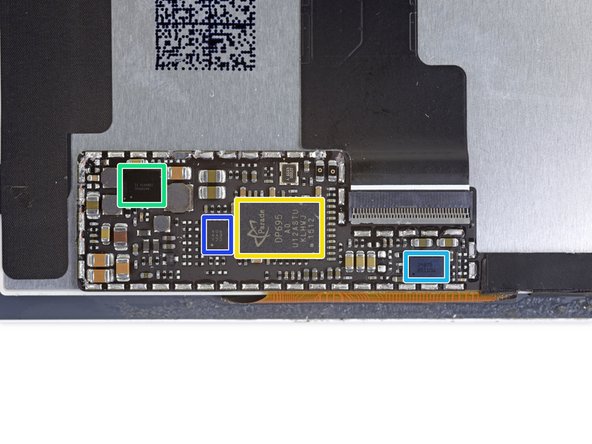

      • On the back of the display, we find some juicy silicon!
      • 2 × Broadcom BCM15900B0 Touch Screen Controller
      • NXP Semiconductors 8416A1 (NVT8416) Touch ID Sensor
      • Parade Technologies DP695 Timing Controller
      • Apple says this is an iteration of the DP665 LCD timing controller found in the iMac Retina 5K, modified to support the display's variable refresh rate.
      • Texas Instruments TPS65144 (Likely an iteration of the TPS65143A LCD Bias found in the Air 2)
      • Renesas (formerly Intersil) ISL24879 precision programmable LCD reference voltage generator
      • Rohm BR24G64NUX-3A 64 KB Serial EEPROM Memory

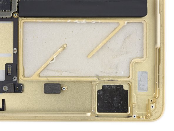

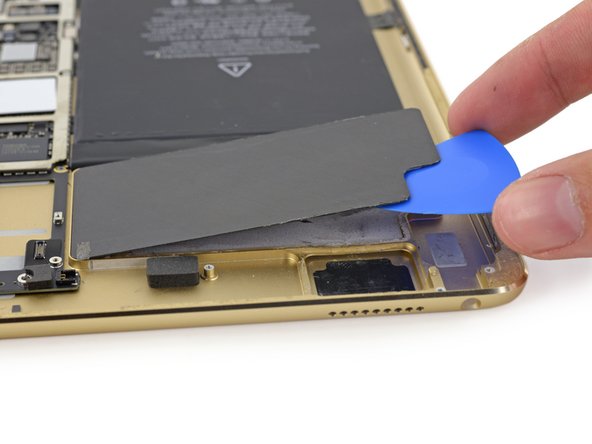

      • And now back to the body!
      • A logic board relocation isn't the only easily-recognized layout difference between the iPad Pro and previous iPads. While the iPad Air 2's interior real estate was dominated by a proportionately massive battery, the iPad Pro dedicates a significant amount of room to speaker enclosures.
      • It appears that the Pro's self-balancing, four-speaker audio comes at the cost of battery capacity. Based on our measurements, the speaker enclosures occupy about half as much space as the battery.
      • That's space that could have potentially been used for an extra 50% battery capacity. We're sure Apple was very careful setting the balance between battery capacity, weight, and sound quality.

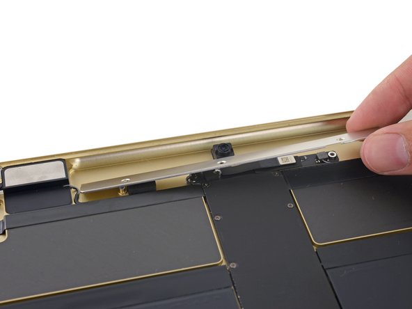

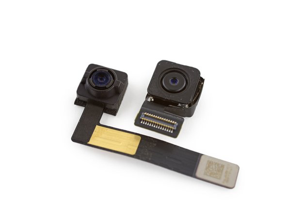

      • Next, we lend a hand to the FaceTime HD (left) and iSight cameras, which are trapped behind a bracket not unlike the one we dug up in Microsoft's new laplet.
      • While just about everything in this tablet has been billed as bigger and better than previous devices, these cameras seem to be the same as those found in the iPad Air 2.
      • For those of you keeping score: the rear-facing camera captures the same 8 MP images and 1080p video at 30 fps, while the front-facing selfie cam shoots identical 1.2 MP images and 720p video.

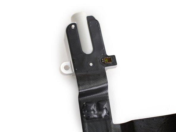

      • As we continue to mine deeper into this iPad Pro, the next Balrog component we find is the headphone jack.
      • Just like the 3.5 mm jack in the iPad Air 2, the ribbon cable on this headphone jack harbors one of the Pro's two front-facing ambient light sensors.

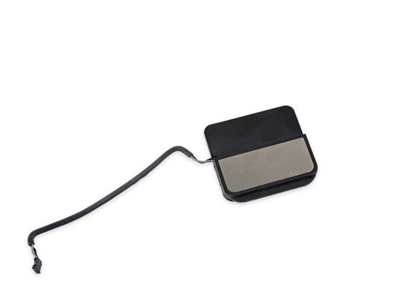

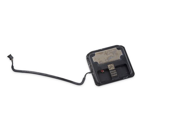

      • The speakers are nice, but what makes them really sing are the fancy back volume chambers, machined directly into the unibody enclosure.
      • Apple claims that this new design provides up to three times more output than previous iPad models.
      • After removing the carbon fiber caps, we find the enclosures are filled with foam. Apple's own renders don't actually show this foam, but we're betting that it's used to amplify the effective volume of the enclosure.

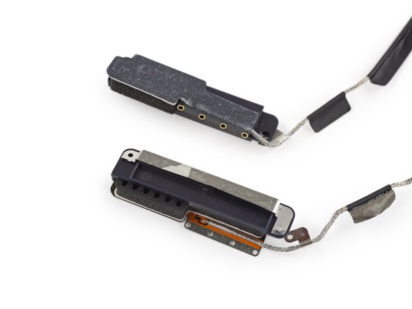

      • On our way to the logic board, we stop to smell the flowers antennas.
      • Just like the iPad Air 2, the Pro's two antennas use MIMO technology to provide 802.11ac Wi-Fi speeds of up to 866 Mbps, and LTE speeds of up to 150 Mbps.

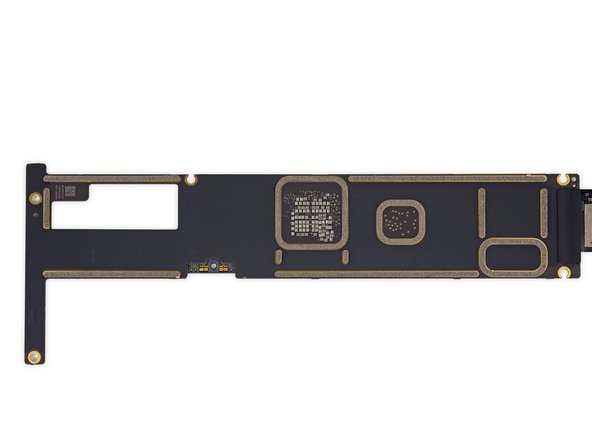

      • We've finally found the brains of the operation, the logic board!
      • Apple APL1021 A9X 64-bit Processor
      • SK Hynix H9HCNNNBTUMLNR-NLH 16 Gb (2 GB) LPDDR4 RAM (2 GB × 2 = 4 GB total)
      • Toshiba THGBX5G8D4KLDXG 32 GB NAND Flash
      • InvenSense MP67B (MPU-6700B) 6-axis Gyroscope and Accelerometer Combo
      • NXP 65V10 NFC Controller (also found in the iPhone 6/6 Plus, as well as Nexus 5X and 6P marked NXP 54802)
      • NXP Semiconductors LPC11U37 ARM Cortex-M0 Microcontroller
      • Apple (Cirrus Logic) 338S1213 Audio Codec

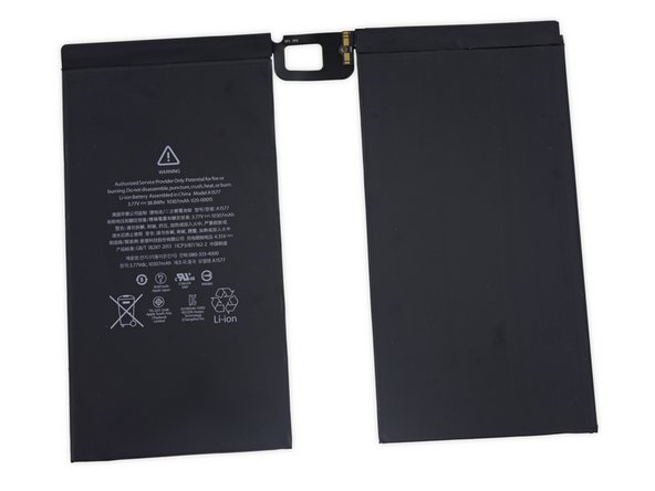

      • Thanks to those pull tabs, the battery is freed with ease.
      • The iPad Pro's 3.77 V battery weighs in at an impressive 10307 mAh.
      • This prodigious, 38.8 Wh power source offers a 40 percent increase over the 27.62 Wh battery in the iPad Air 2, but just barely edges out the 38.2 Wh battery we found in the Surface Pro 4.
      • In addition to some obscure markings, the underside of the battery still bears the anchoring strips(?) for the adhesive pull tabs.

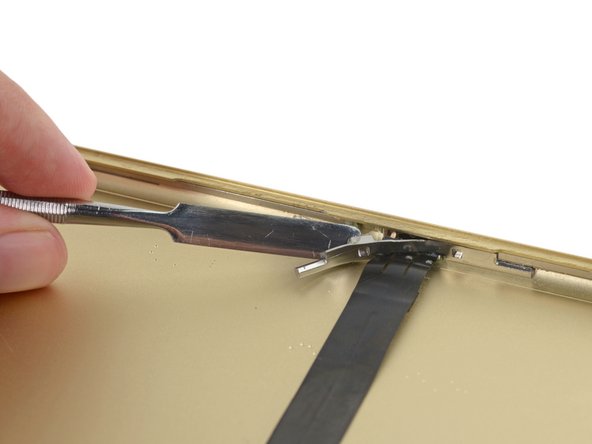

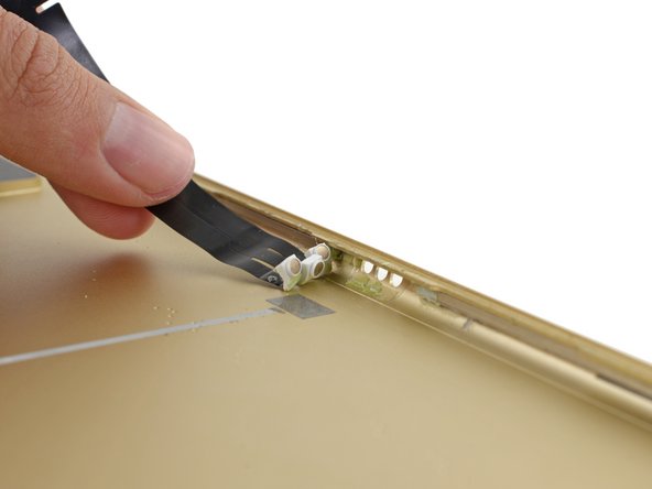

      • The last component we'll try to remove on the road to teardown glory is the Smart Connector port cable.
      • ''Try'' being the operative word...
      • There are no visible screws, and after a lot of Jedi mind tricks, i.e. elbow grease (and totally mangling the cable bracket), the port is still not budging.
      • After literally smashing the contacts through with a hammer, we manage to free the cable.
      • Check that crusty glue! Gross!
