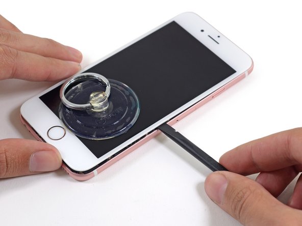

      • If you don't have an iSclack, use a single suction cup to lift the front panel:
      • Press a suction cup onto the screen, just above the home button.
      • Be sure the cup is pressed securely onto the screen to get a tight seal.
    3. iPhone 6s Display Replacement: crwdns2935265:03crwdnd2935265:01crwdnd2935265:03crwdne2935265:0 iPhone 6s Display Replacement: crwdns2935265:03crwdnd2935265:02crwdnd2935265:03crwdne2935265:0 iPhone 6s Display Replacement: crwdns2935265:03crwdnd2935265:03crwdnd2935265:03crwdne2935265:0
      • There is a notch on the underside of the display just above the headphone jack that is the safest place to begin prying the phone open.
      • Pull up on the suction cup to slightly separate the front panel assembly from the rear case.
      • Take your time and apply firm, constant force. The display assembly is a much tighter fit than most devices and is held down with adhesive.
      • Once a small gap has been opened, insert the flat end of a spudger above the headphone jack.
    4. iPhone 6s Display Replacement: crwdns2935265:04crwdnd2935265:01crwdnd2935265:02crwdne2935265:0 iPhone 6s Display Replacement: crwdns2935265:04crwdnd2935265:02crwdnd2935265:02crwdne2935265:0
      • Twist the spudger to open the gap more and break it free from the adhesive.

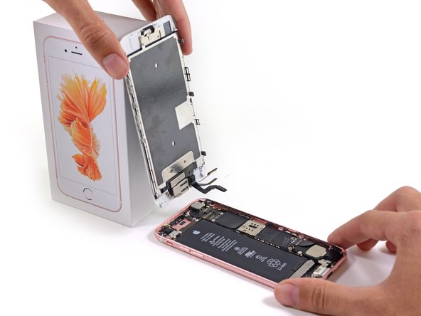

    7. iPhone 6s Display Replacement: crwdns2935265:07crwdnd2935265:01crwdnd2935265:03crwdne2935265:0 iPhone 6s Display Replacement: crwdns2935265:07crwdnd2935265:02crwdnd2935265:03crwdne2935265:0 iPhone 6s Display Replacement: crwdns2935265:07crwdnd2935265:03crwdnd2935265:03crwdne2935265:0
      • Use the suction cup to open the display, breaking the last of the adhesive.
      • Don't open the display more than 90 degrees, as it is still connected at the top by three cables that may break if stretched.
    8. iPhone 6s Display Replacement: crwdns2935265:08crwdnd2935265:01crwdnd2935265:01crwdne2935265:0
      • Lean the display against something to keep it propped up while you're working on the phone.

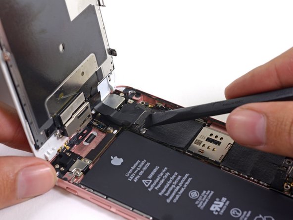

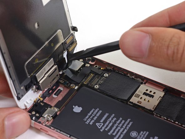

    3. iPhone 6s Display Replacement: crwdns2935265:014crwdnd2935265:01crwdnd2935265:03crwdne2935265:0 iPhone 6s Display Replacement: crwdns2935265:014crwdnd2935265:02crwdnd2935265:03crwdne2935265:0 iPhone 6s Display Replacement: crwdns2935265:014crwdnd2935265:03crwdnd2935265:03crwdne2935265:0
      • In the next three steps, take care to pry up only on the cable connectors, and not on their sockets on the logic board.
      • Use the flat end of a spudger to disconnect the front-facing camera and sensor cable connector.

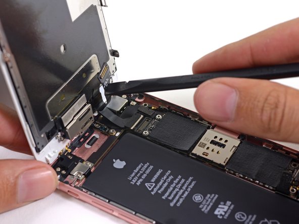

    4. iPhone 6s Display Replacement: crwdns2935265:015crwdnd2935265:01crwdnd2935265:03crwdne2935265:0 iPhone 6s Display Replacement: crwdns2935265:015crwdnd2935265:02crwdnd2935265:03crwdne2935265:0 iPhone 6s Display Replacement: crwdns2935265:015crwdnd2935265:03crwdnd2935265:03crwdne2935265:0
      • Use the flat end of a spudger to disconnect the display data cable connector.
      • When reassembling your phone, the display data cable may pop off its connector. This can result in white lines or a blank screen when powering your phone back on. If that happens, simply reconnect the cable and power cycle your phone. The best way to power cycle your phone is to disconnect and reconnect the battery connector.

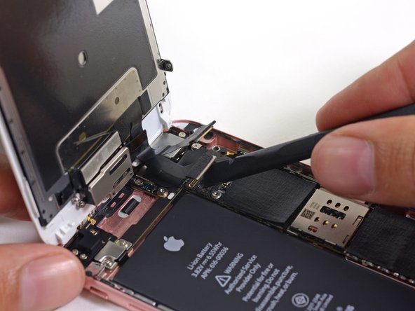

    5. iPhone 6s Display Replacement: crwdns2935265:016crwdnd2935265:01crwdnd2935265:02crwdne2935265:0 iPhone 6s Display Replacement: crwdns2935265:016crwdnd2935265:02crwdnd2935265:02crwdne2935265:0

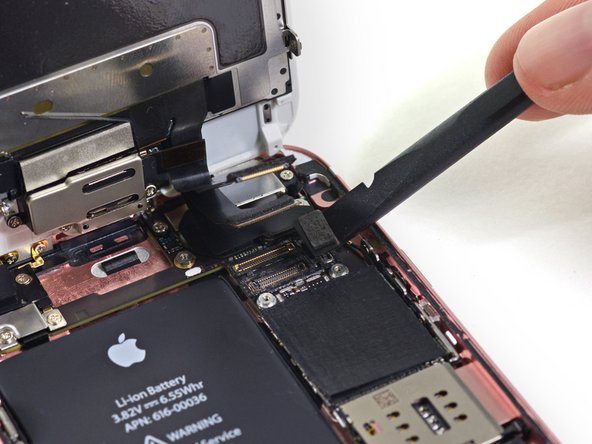

      • Finally, use the flat end of a spudger to disconnect the digitizer cable connector.
    6. iPhone 6s Display Replacement: crwdns2935265:017crwdnd2935265:01crwdnd2935265:02crwdne2935265:0 iPhone 6s Display Replacement: crwdns2935265:017crwdnd2935265:02crwdnd2935265:02crwdne2935265:0
      • Remove the display assembly from the rear case.
