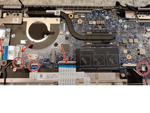

Diconnect makred cables. Make sure to lift up locking tabs with a plastic tool. CMOS and speaker cable are disconnected by pulling on the white connector on the cable.
Remove 3 M2.5x5 screws and lift the metal hinge.
Remove 2 M2x5 screws that hold metal bracket over USB-C connector.
